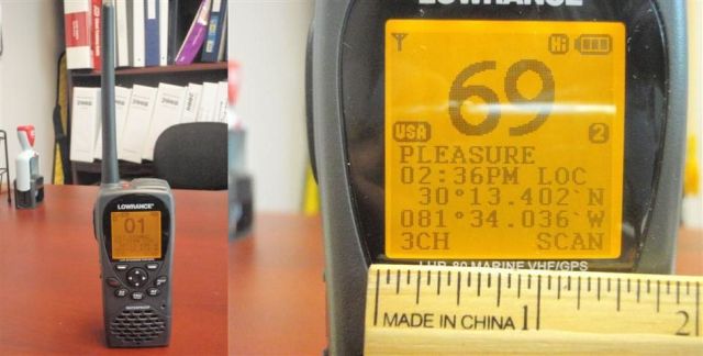

It's a bit larger (2 5/8" x 5 1/2" x 1 1/2" ) and feels lighter than other small handhelds units I've used, but I guess that's the LiPO battery and what makes it float. I charged it up, turned it on, and Wow! A screen I can read without glasses! (unlike my phone)
The channel number is most prominent, below that is a channel name (16:Distress, 69:Pleasure2), the time, and your coordinates all in fonts large enough to see.

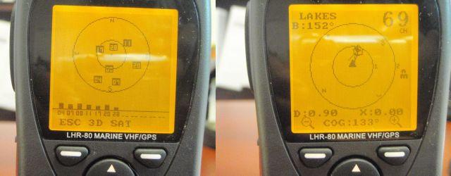

 The second impressive trick was the GPS got a lock in little more than one minute (all of my other GPSr's need at least 2 or 3 minutes to lock and display time and coordinates). The GPS screen is kind of rudimentary though, and reminds me of my first Magellan handheld from the turn of the century.

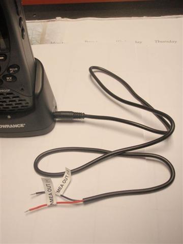

It has a connection for NMEA output in the charger base and I was looking forward to hooking it up to my Humminbird Matrix 10 FF as it has a big display. I’m not sure that’s going to happen though as I don’t want to risk getting the charger base wet.

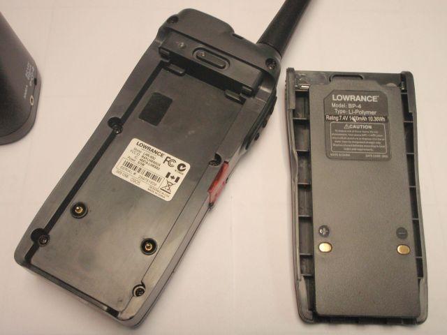

 My only gripe so far is with the waterproofing. As with all the submersible vhf's I've had, the radio unit is usually well sealed, but the battery and the battery connection is where the problems seem to originate. The LHR-80 has no gasket between the battery and the radio and although they fit tightly together, they're not water tight. I confirmed this with a dunk in the sink. It does float, but after drying it off and removing the battery, I found a bit of water inside between the battery and the radio. Not much mind you, but if that were salt, that would be very bad. (mental note: Don't leave it in standing water and rinse both pieces after use).
The LiPO batteries are quick charging (3 hrs) and the charge lasts a solid 10 hrs in stby w/gps. Which brings up another slight sticking point for me; how do you charge batteries in the wilderness? For me, that’s the only advantage of being able to use AA’s. The LHR-20 that this replaced (for me) had both a LiPO pack and  provision for AA’s. Yeah, yeah, ok, they are current limited and can’t kick out the TX power of the LiPO. But the LiPO does not TX at all once it’s depleted and its easier to carry a fair number of AA’s as spares

My primary gripe with the battery seal may have been unfounded. On closer inspection, I noticed the connector pins on the radio have O-rings that stand proud of the surface and seal against the battery contacts. The small amount of water that I spotted after dunking it would be (is) inconsequential.
A fresh water rinse and thorough dying after any salt swim, including separating the battery from the radio, is still a VERY good idea though.
