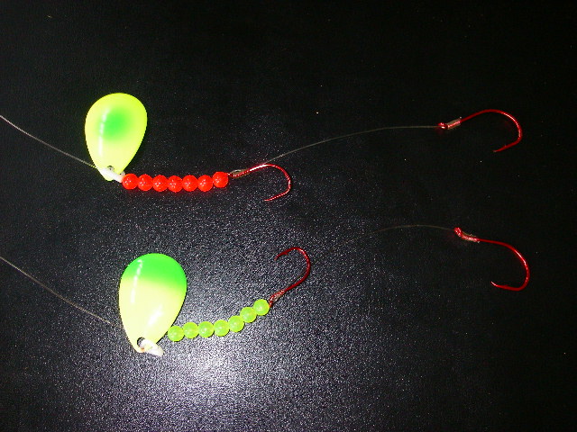

•   You’ll want to stack enough beads to keep your blade from hitting the tail of the prawn when they spin.
•   The more the water clears and slows, you may want to consider dropping down blade sizes or even removing the blade entirely. I personally like to use some sort of blade, but just drop way down in size.
•   May favorite spinner blade colors for Springers is pretty much anything with Chartreuse, but many colors and combo’s work well.
•   Try using a size 3 or switch to a 4 for slightly off colored water.
•   I always have the best luck using the red prawns, but hear that pink’s works well too.

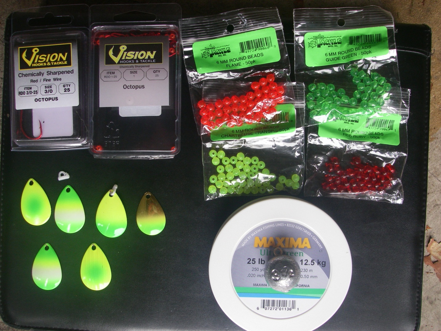

Caption: These are a few of the supplies that I like to use for tying up the rigs

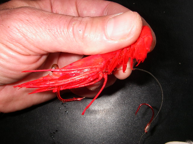

Caption: This is a picture of how to thread the bottom size 3/0 hook thru the throat and back out thru the mouth.

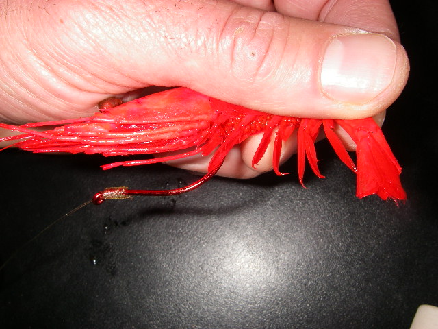

Caption: After you push the hook thru the head try and push the shank of the hook further into the head, which should send the tip of the hook out further away from the head.

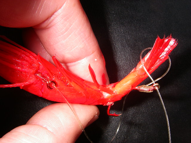

Caption: Now you want to push your top hook(or small hook) thru the tail or abdomen of the prawn and back out. This hook is there to support the prawn. Don’t mind the extra mono the bends out and around. It actually helps give the prawn spin.

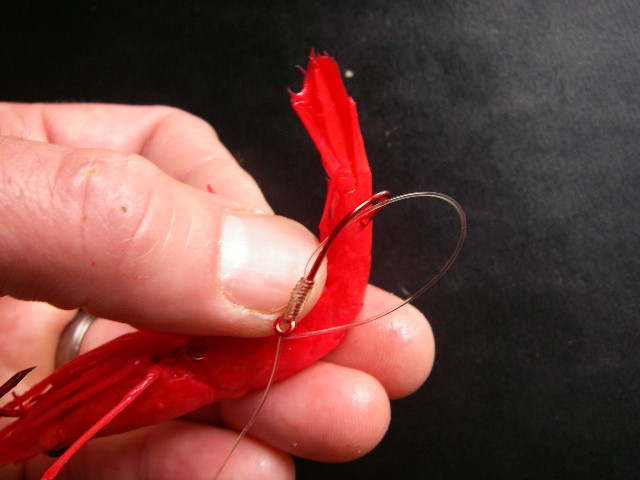

Caption: Once the top hook is pushed thru the tail meat and out, use the egg loop on the top hook to help support the tail so it doesn’t bend in the current. It also helps to maintain a consistent spin.
Caption: Shows how the prawn should attach. This is the prawn hanging naturally. Notice the curve in the prawn that’s created by where you thread the hooks? This bend in the prawn should help create a consistent looping spin.
Caption: Is a better picture of how the hooks are positioned and ready to set themselves into your Springer.
