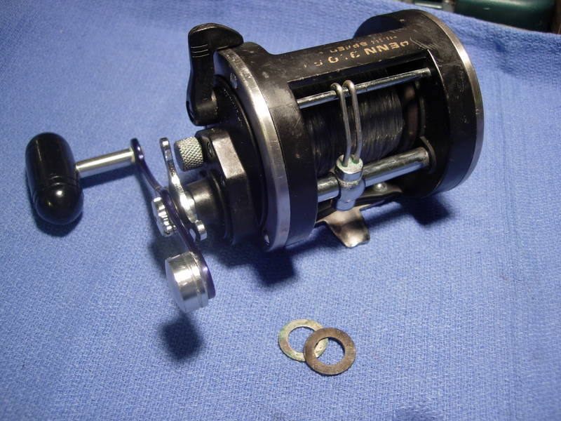

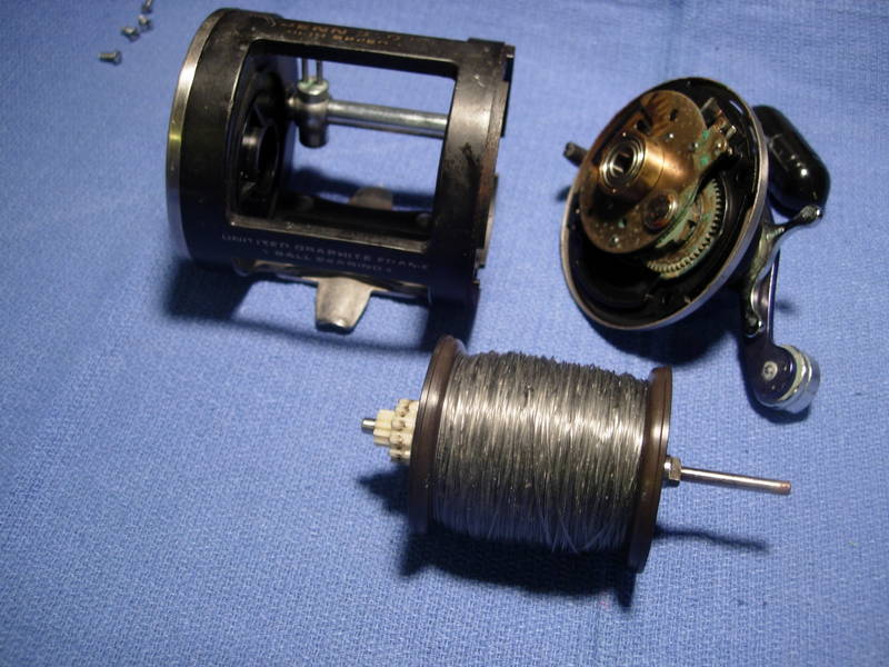

this rebuild post is for the last of 3 series graphite penn star drag reels.  here is a link to the schematics ....
http://www.scottsbt.com/catalog/store/images/pennparts/schematics/310gt.pdf

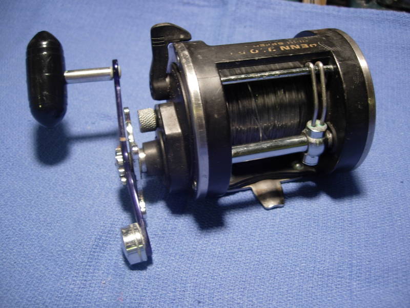

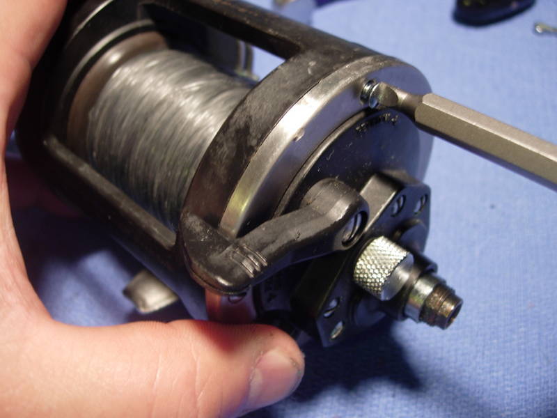

and here is our reel, beaten and down, but not out by any means!

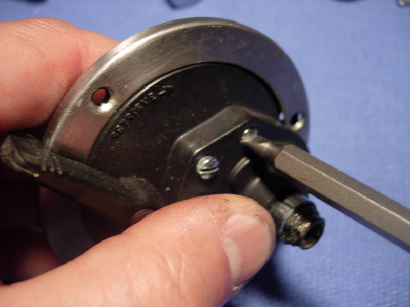

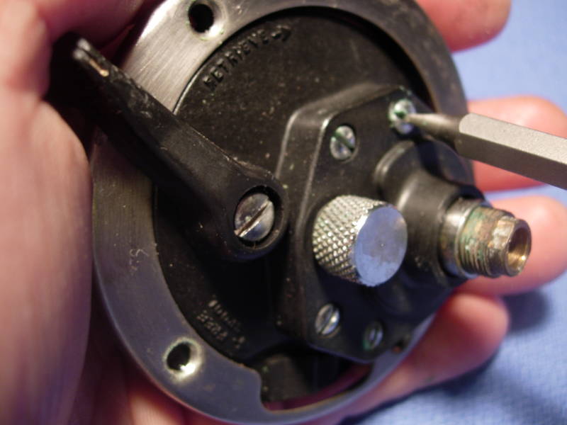

we will start by removing the four right side side plate screws (key #32).

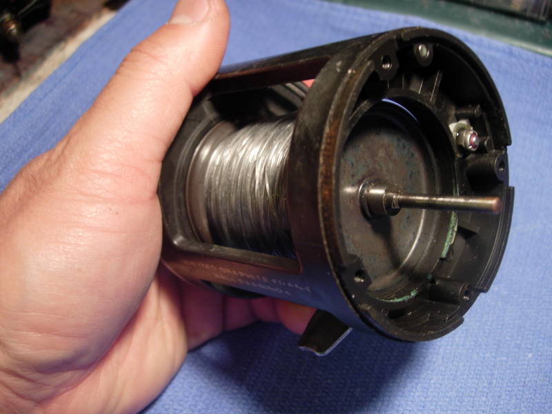

the reel breaks down cleanly to the frame assembly (key #183), the spool assembly (key #29L), and the right side plate assembly (key #1).  to service (lube) the bearings in the future, you need only go as far as this step.

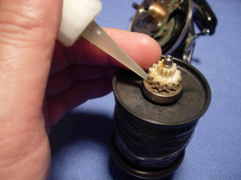

the left spool bearing (key #40) is hidden underneath the spool gear (key #66), which is in turn held in by a lock spring (key #67).  replacing the bearing requires removal of the lock spring.  we'll just lube the bearing for now.
lube the worm (key #42) level wind assembly.
install the spool assembly (key #29L) back into the frame assembly (key #183) and set both aside.

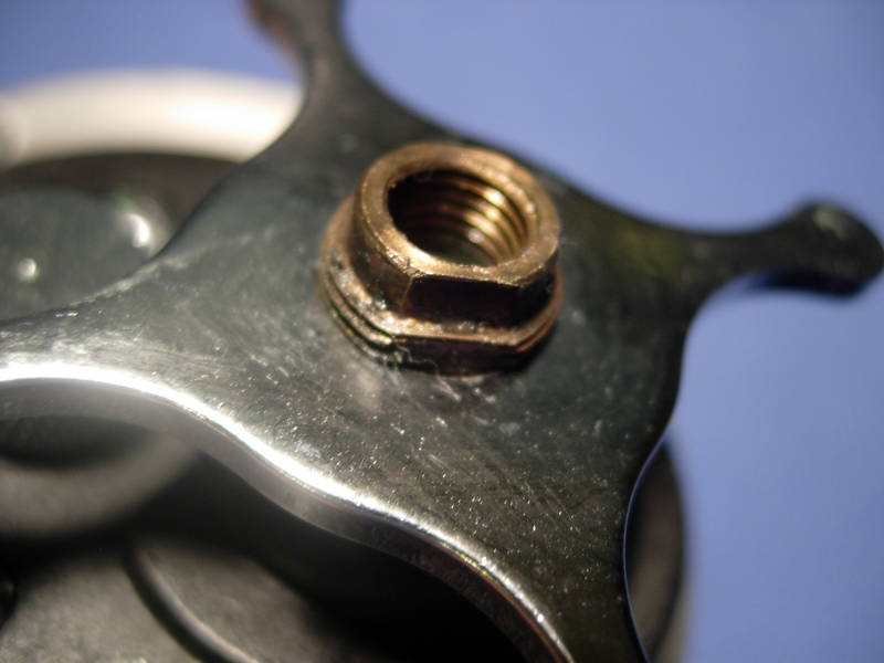

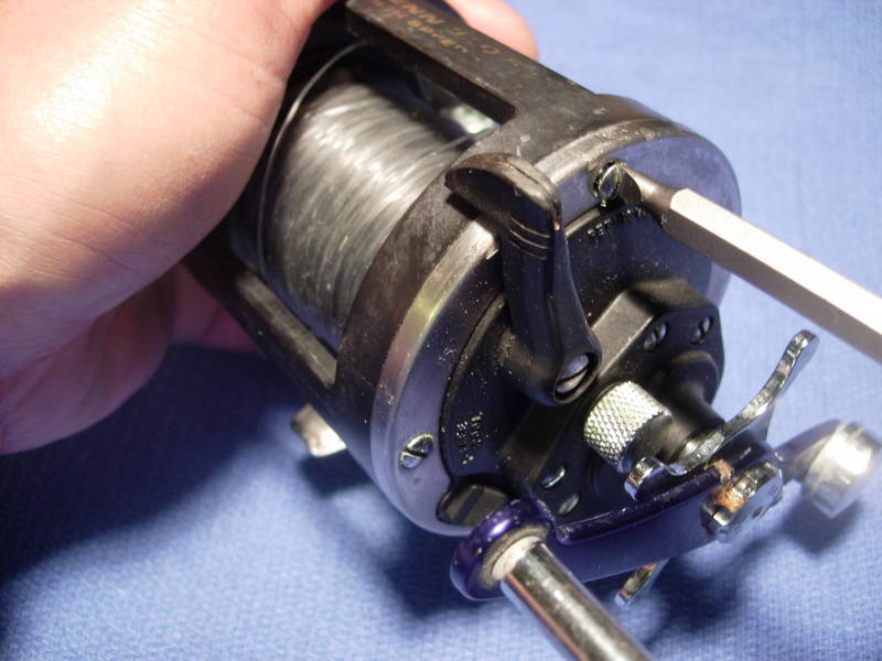

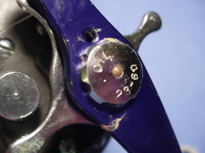

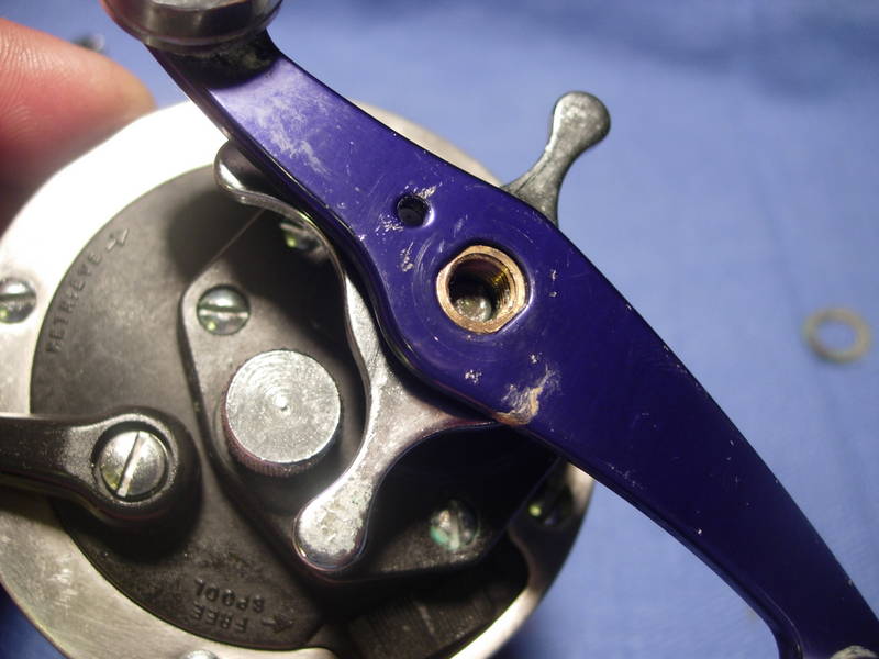

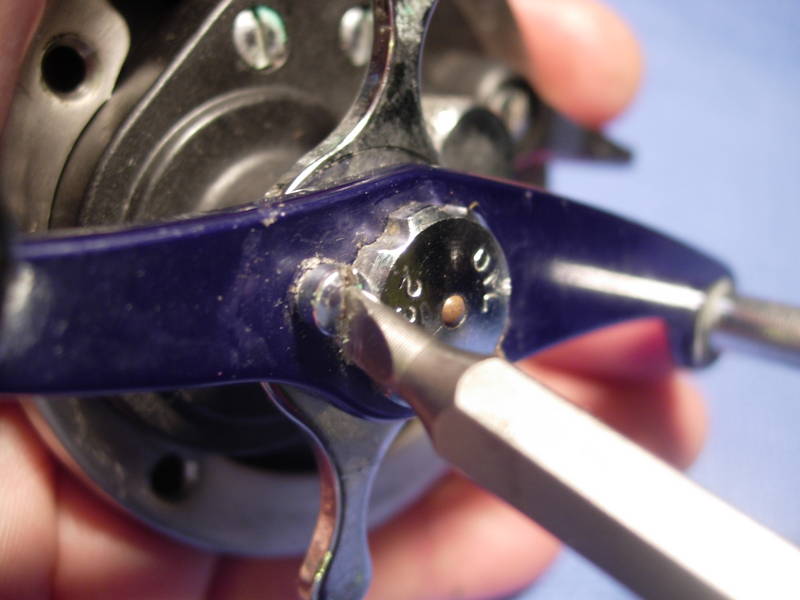

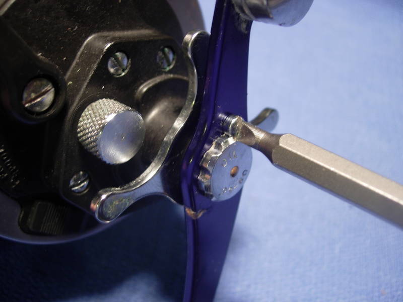

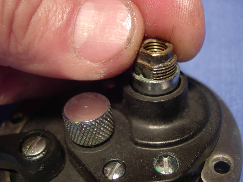

now, to service the right side plate.  we will start with the handle lock screw (key #23A).

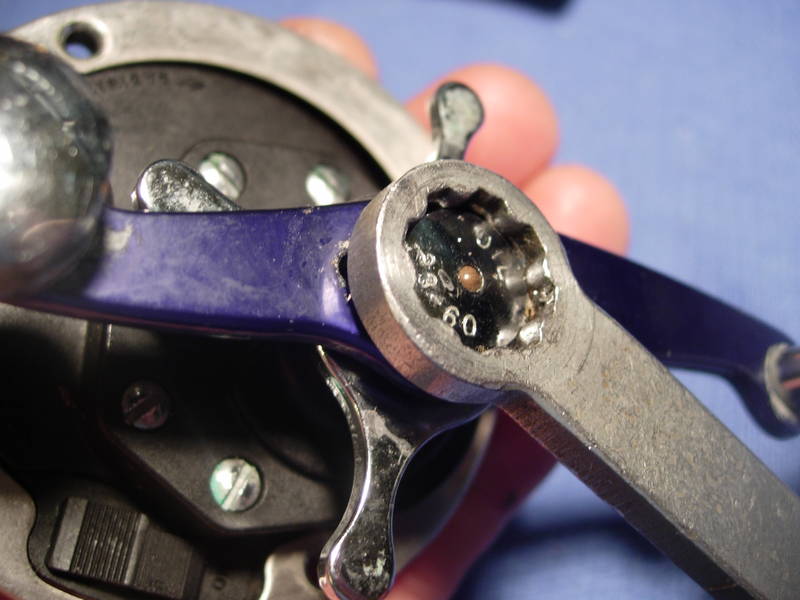

remove the handle assembly screw (key #23).

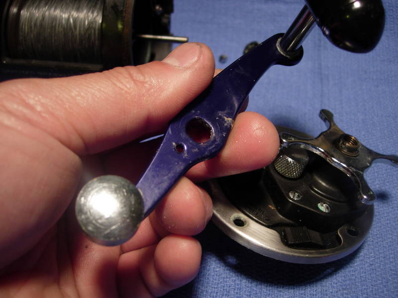

remove the handle assembly (key #24).  note that an $18 jigmaster power handle (part #24-56) would fit very nicely right here.

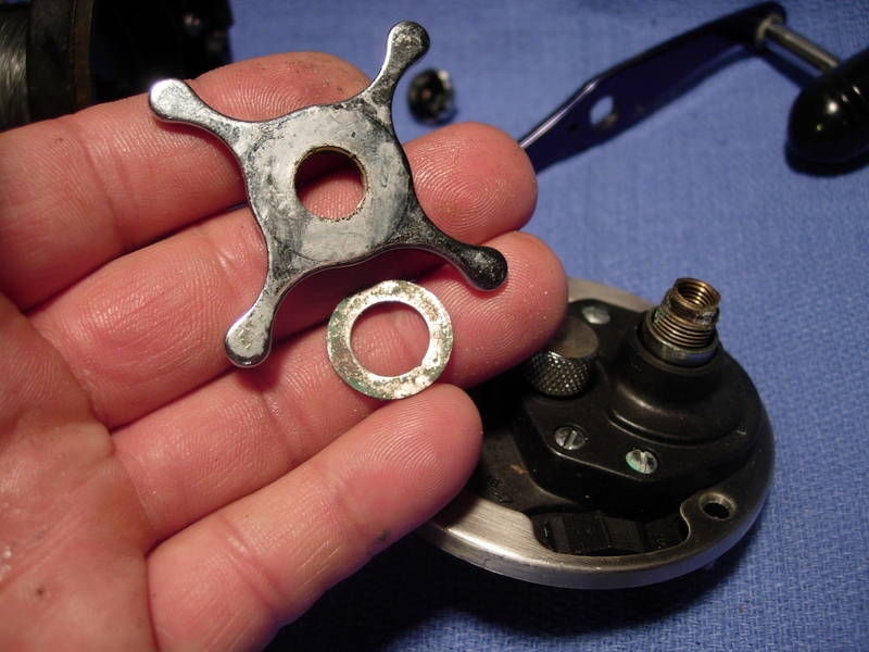

remove the tension spring (key #8) and star drag (key #10).

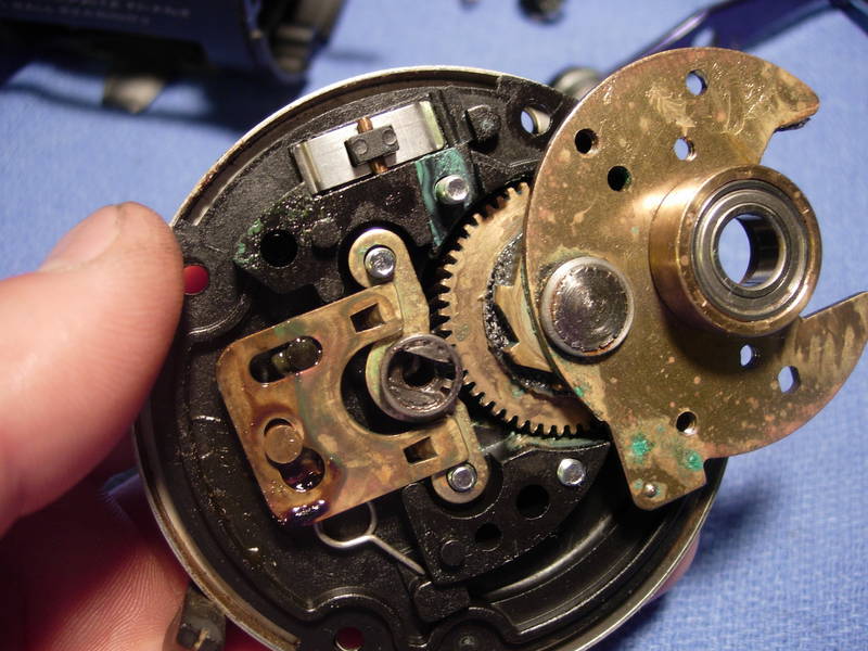

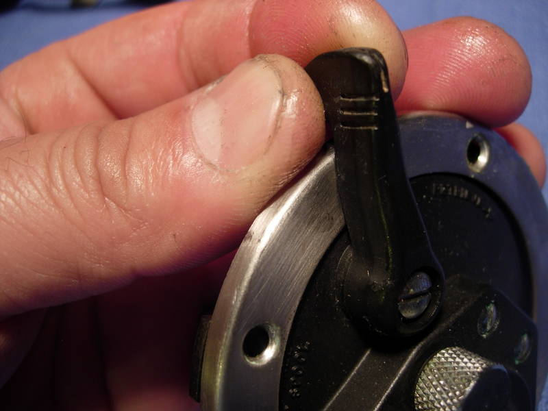

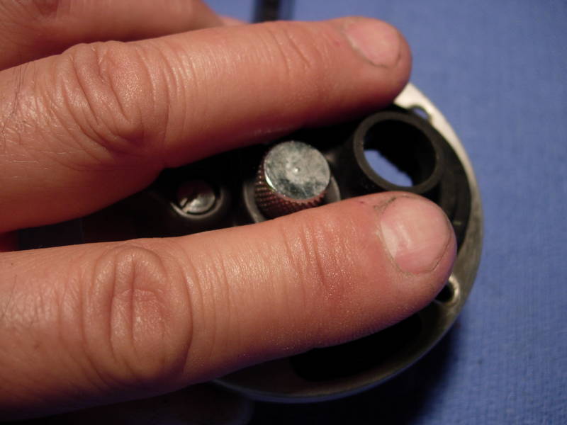

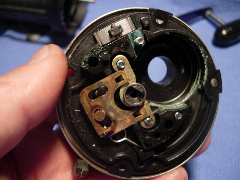

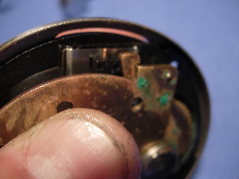

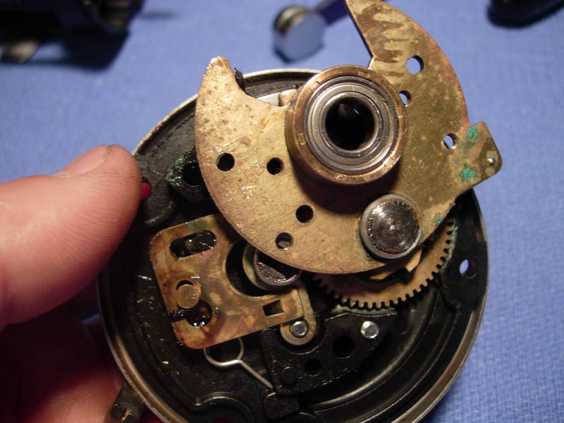

now, push the eccentric lever (key #21) to the forward position and back out but do not remove the four bridge screws (key #'s 16 and 17).
the bridge assembly (key #3) will drop out cleanly.  leave the right side plate (key #1) in the "up" position so that the bridge screws (key #'s 16 and 17) do not fall out.

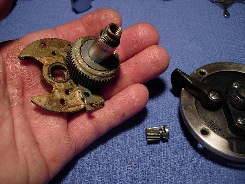

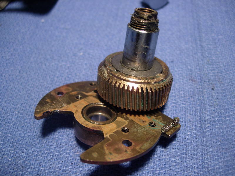

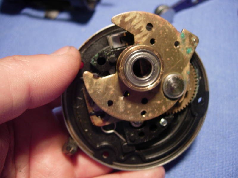

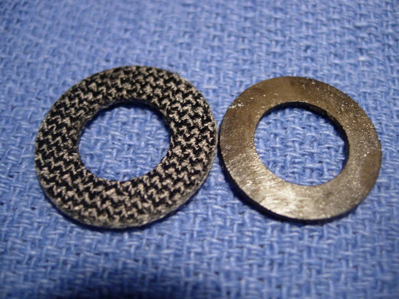

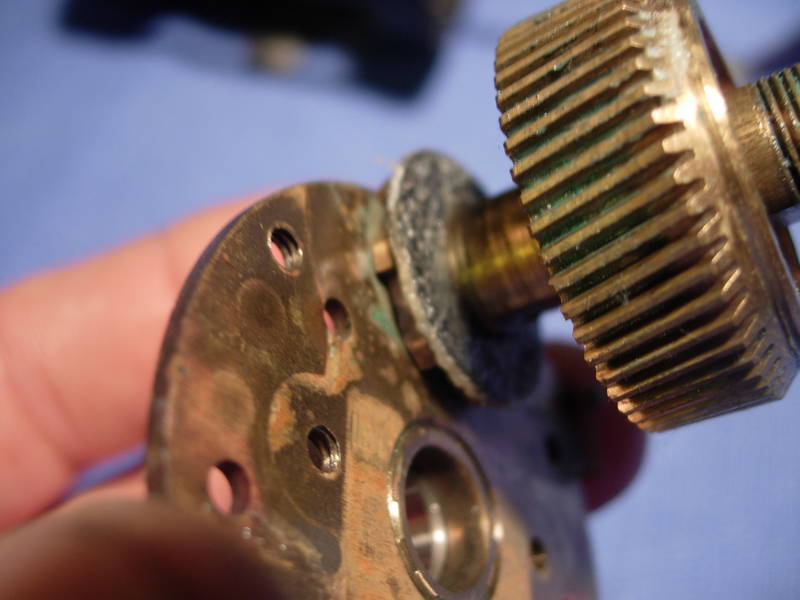

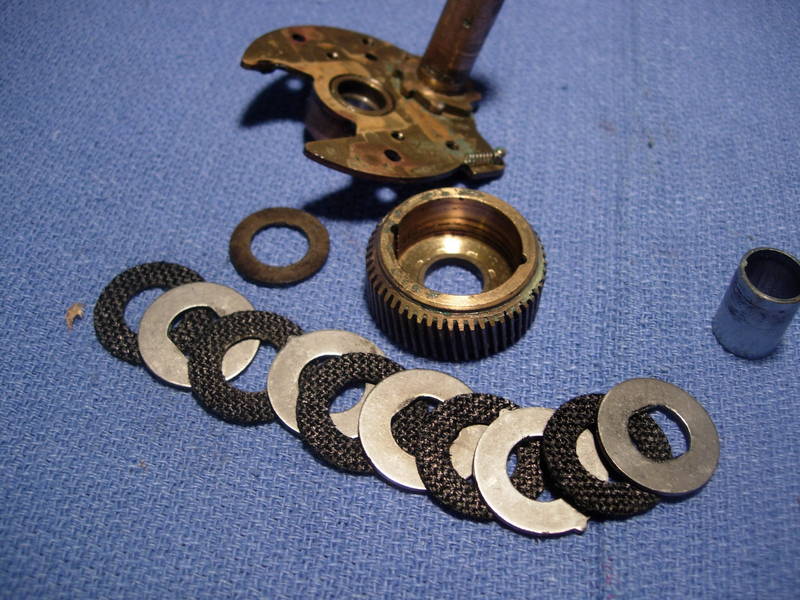

here is an exploded view of the bridge assembly.  from top to bottom are the bridge (key #3), the fiber washer (key #4, the main gear (key #5), the five ht-100 drag washers (key #6), the metal drag washers (key #7) and the spacing sleeve (key #9) to the far right.

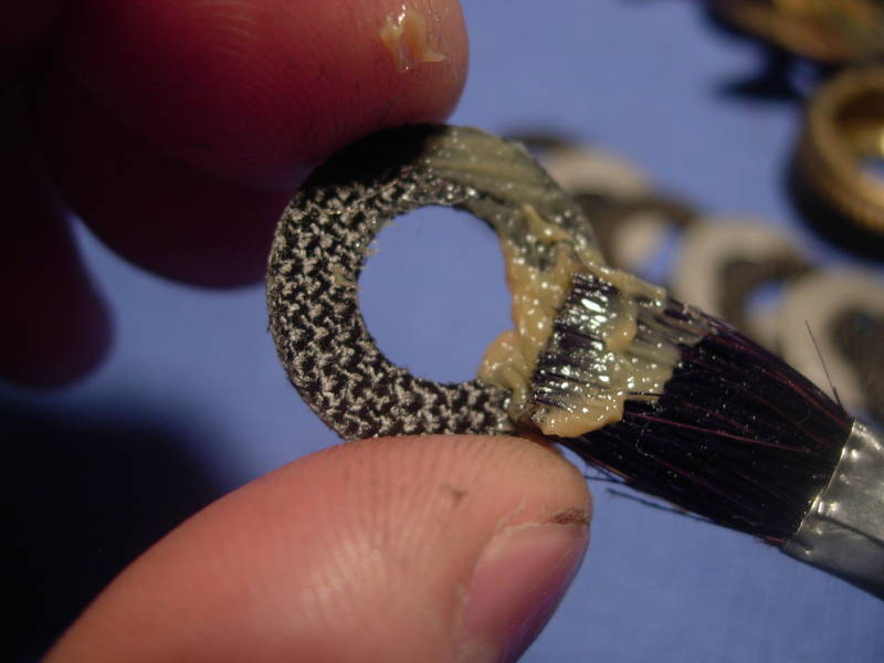

we will substitute an ht-100 #6-113 drag washer in place of the fiber washer (key #4).  note that this is the smaller #6-113, not the larger #6-113h.
slap a thick coat of cal's drag grease on all of the ht-100 drag washers.  don't worry about the excess, it will just squeeze out the sides.
rebuild the drag stack.
place your left index and middle fingers over the bridge screws (key #'s 16 and 17) to hold them in place.

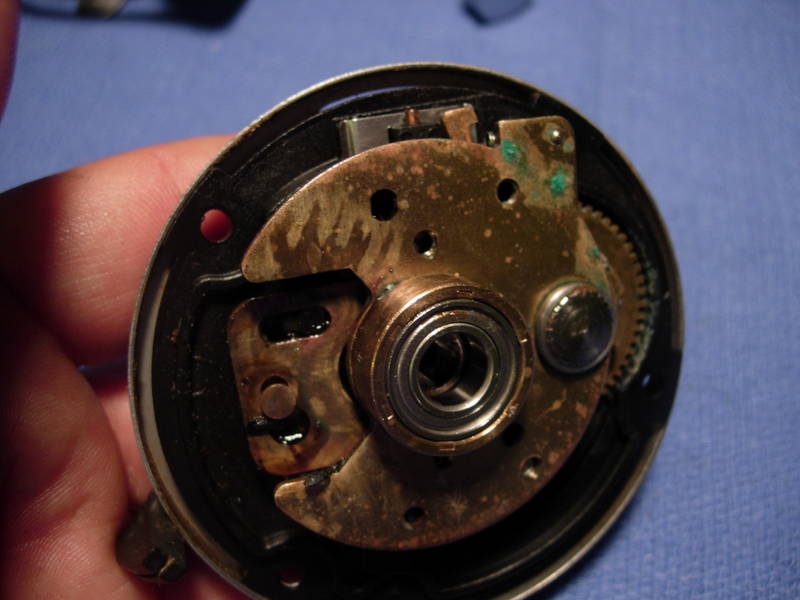

now flip over the right side plate (key #1) and install the pinion gear (key #13) if it had fallen out earlier.

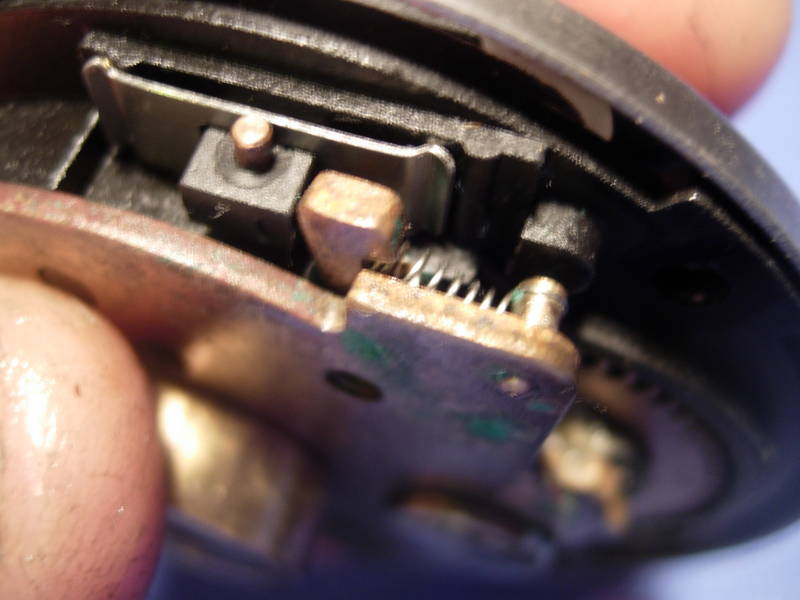

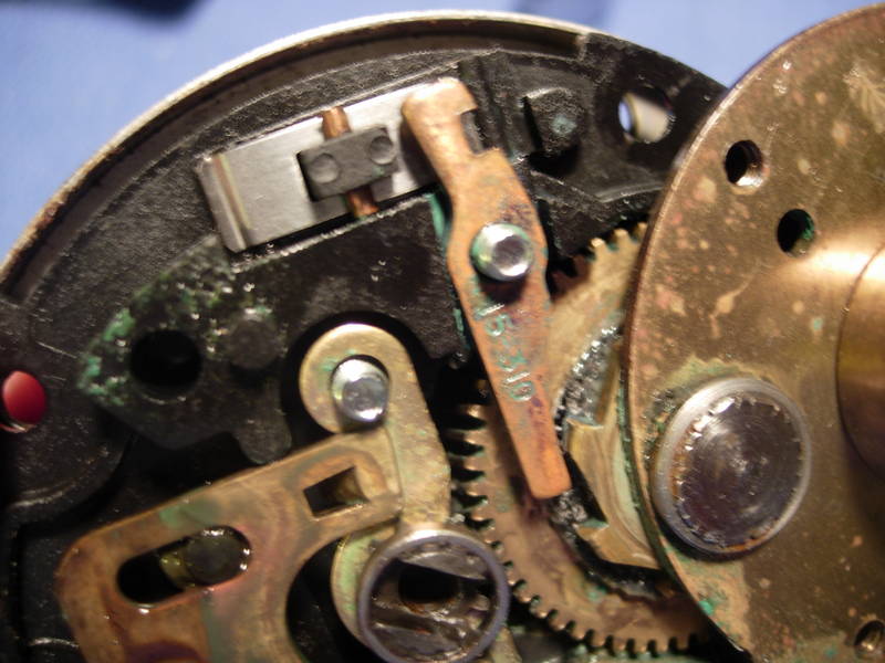

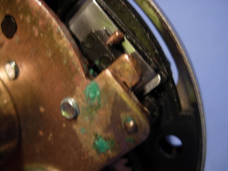

the procedure for installing the dog is a little different.  install the bridge assembly (key #3) at 180 degrees to its final position.  if you used a little excess drag grease on the drag washers, the stack of drags will stay in place and not fall out at this point.

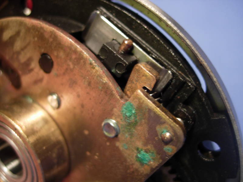

lay the dog (key #15) down over the bridge screw (key #16).
now rotate the backing plate for the bridge assembly (key #3), slowly, counterclockwise, 180 degrees.
as you get close, the dog spring (key #14) should slide in place, up against the dog (key #15).
now press down a little and the bridge assembly (key #3) should "snap" into position.  with a right hand assist, flip the right side plate assembly over, holding the bridge assembly in place.
start each bridge screw (key #'s 16 and 17) half way, then cinch each one down snugly.

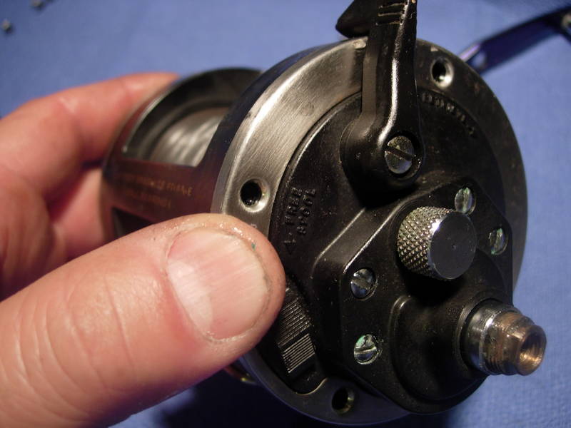

turn the gear sleeve (key #98) to make sure the anti-reverse dog (key #15) is functioning properly.
flip the eccentric lever (key #21) back and forth to make sure it is functioning properly as well.

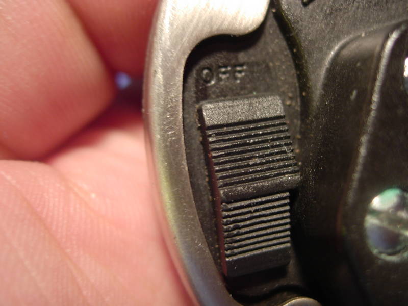

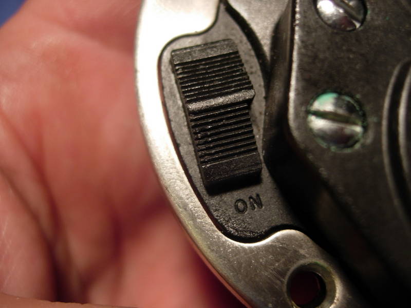

this reel features a direct drive button (key #21A).  check to see that it is functioning properly.  when "on," the anti-reverse dog (key #15) is engaged, the handle goes in only one direction and clicks when the handle is turned.
when the direct drive button (key #21A) is "off," the dog (key #15) is disengaged and the handle will turn forward and back with no click.  this feature is commonly used for "wireline" fishing, although the reel is a bit small for this purpose.

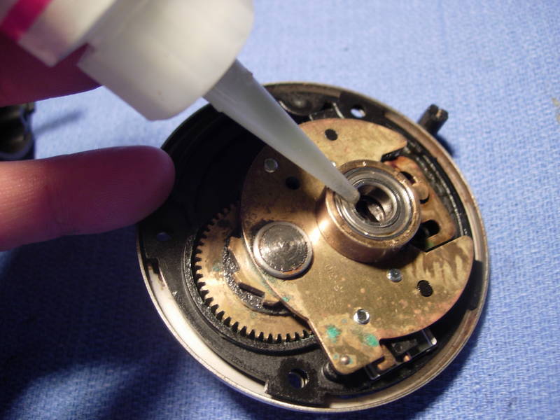

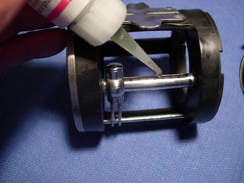

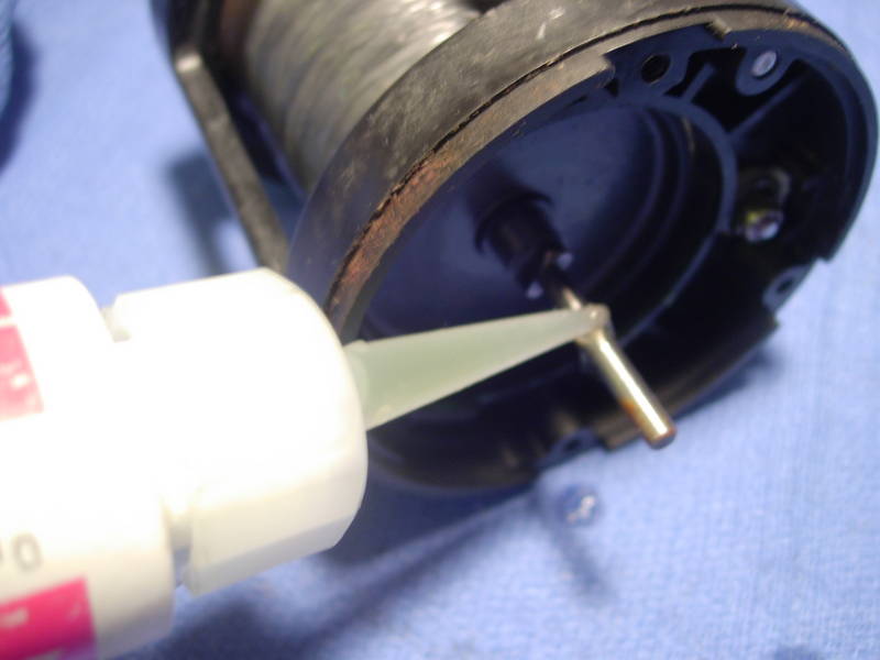

lube the bridge assembly bearing (no key #).
lube the spool shaft (key #29L).  it is a common problem in the 3-series graphite reels that the spool shaft and pinion gear (key #13) rust together.

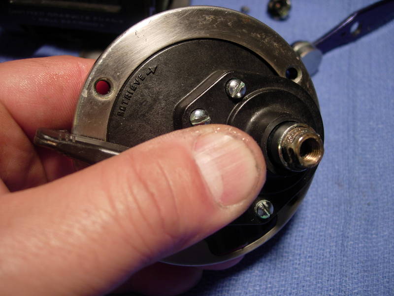

install the right side plate assembly (key #1).
install the right side plate screws (key #32).
install the star drag (key #10) and turn it down far enough to clear the shoulder of the gear sleeve (key #98).  this allows you install the handle (key #24) properly.
install the handle assembly (key #24).

this reel uses a stack of five penn ht-100 #6-60 drag washers inside the main gear.  this drag stack will deliver plenty of drag.  the problem is the gear sleeve.  it's soft brass and the same size as the jigmaster gear sleeve, only taller.  under more than 8-10 pounds of drag, or if the drag sticks, i am certain that the top of this gear sleeve would round off.  this reel should perform well with 20# mono and 6-7#'s of drag.  looking at the entire series of star drag reels (the 310gti, 320gti/gt2, 330gti, 340gti and 345gti)  i believe that the 320 gti/gt2 has the most favorable power to weight ratio.
