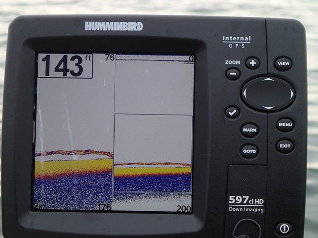

Here's a typical picture I took on Flathead Lake while downrigger trolling in my kayak in 143 feet of water.  It shows a couple of lake trout following my downrigger weight (the thin line).  In the spring and summer, this was relatively shallow water lake trout fishing. The guys who are jigging spend almost all their time between 250 and 350 feet. In the fall, the lake trout can be caught while trolling in much shallower water, perhaps 20-80 feet, because they are getting ready to spawn in 20-30 feet of water in areas with rocky bottoms. An advantage of shallower lakes which have lake trout is that even when the lake trout are in the deepest part of the lake, they aren't all that deep.
