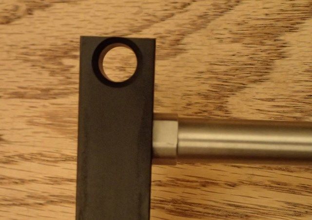

I’ve installed my “rock solid arms” in my Mirage Drive.  They went in with no problem, and weigh only 4.5 ounces per arm (9 ounces total) more than the original arms.  For those more familiar with metric measurements, that’s only 12.6 grams per arm (25.2 grams total) more than the original arms.
I have a few thoughts for Fungunnin's next edition of the arms:
1.    Include a foot of 1/8” black shock cord with the arms.  I had some in the parts room in my man cave, but some people might have difficulty locating some of this shock cord.
2.   The top of the arm has sharp edges and corners.  These edges and corners could gouge footwear or bare feet when you're pedaling, and they could chew up the plastic of your kayak when the Mirage Drive is banging around in your kayak's cockpit.  I’ve filed a bevel on the top of the arms, and have colored the bevel with a black sharpie waterproof pen to reduce the effect of the bevel on the aesthetics of the anodization on the arms.  I suggest that you add this bevel on future shipments of the arms.
3.   The top of the arm has a 3/8” (1 cm) hole for the little plastic doohickey which retains the shock cord.  I suggest that you reduce the size of this hole to one which is just big enough to easily accept 1/8” shock cord.  This would make the plastic doohickey unnecessary, and would allow you to shorten the portion of the arm which sticks up above the pedal shaft.

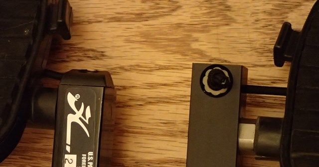

I installed the new pedal arms this afternoon.....and taking note of pmmpetes observations and suggestions, I was able to source a 5.0mm, heavy duty shock cord locally at Windance Board shop in Hood River...they specialize in both windsurfing and kite boarding equipment, hardware, etc, etc. A 1 foot piece was $0.85.....
So, I enlarged the shockcord hole slightly under the foot pedal rib and used a 10-32 SS fender washer on the front side of the arm I fed the cord through and tied a stopper knot.
Everything fit like a glove and I know your design is "rock solid".

These two photo's show the 5.0mm heavy duty bungee and the 10-32 SS washer.  :banjo:
