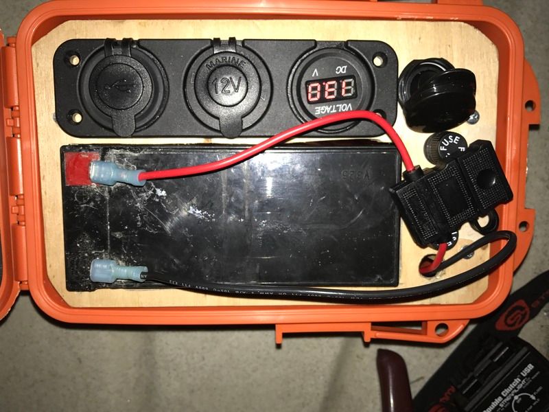

Successful build following the guide. I only varied your design by using the paired male and female cable ends and running it through the box with a cable gland, and I repurposed a test strip container to make a case and cover for the switch.
Thanks for the plans and guide!
