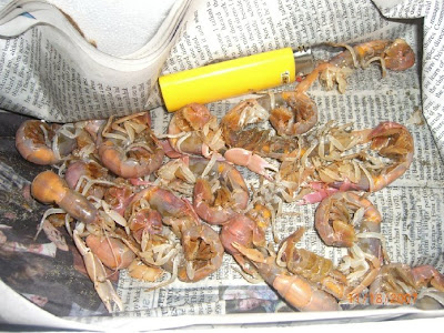

Built my own gun and spent $10-$12 for what retails for around $40-_$50. Took Yakchick and Cody(my Malamute/Y.Lab(over 100lbs) to the sand flats at low tide Sunday in the pouring rain to try it out. Once I got the hang of it came up with about 15 shrimp in 20-30 minutes. Next time I'll wear gloves. Gun worked liked a charm. Here Dino,come to Daddy.

Okay Bill. You get as close to the waters edge in the sand and look for those opening air holes. Stick that big gun over the hole, press down while pulling the handle up(creates suction and remove gun, push down handle to eject sand and hopefully shrimp). I found a quick followup plunge or two helped in capturing the little devils. Sometimes they are still floating in the hole. that simple. Any questions,call or pm me.
