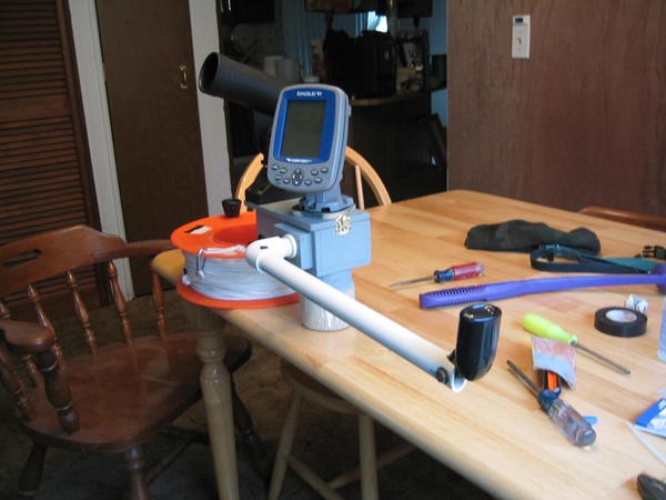

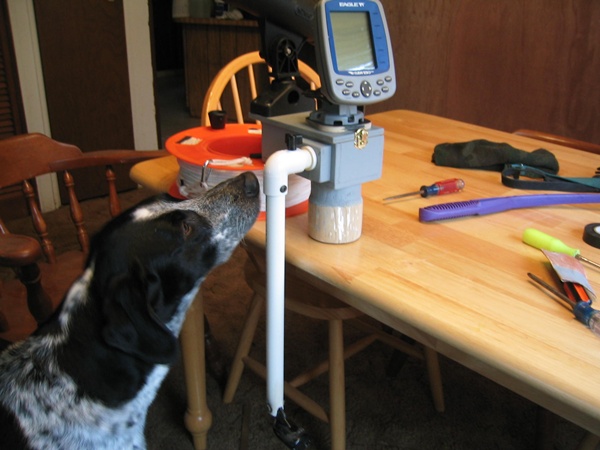

Might be best to do an TDA(transducer employment arm) like i did. Making the swiveling pvc joint isn't too hard if it was needed. I did the joint to get the 'ducer out of the water when i was making a run to another spot and didn't care about marking fish. It's a little noisy at full clip, but you could just pull it off and set in the Canoe.  and attaching it to the boat should be no issue, i got some ideas, if you go that way i'd be happy to share them with ya.

Nice portable setup there, CBY! I also like your demonstration Model "pointing" to the product.

I like the look of that set up there. I would like to know how you made it swivel. Yes if you have an idea please send them my way. I am always looking for another way to do things. It sure beats standing in the back yard while looking at the canoe and talking to myself.

CBY, that is SO how I set my own Cuda 300 after I couldn't get it to properly read through the hull. Glad to see I wasn't the only wacko to set it up that way. This also makes it portable with any other yaks I get in the future.
Thanks for the pics.
