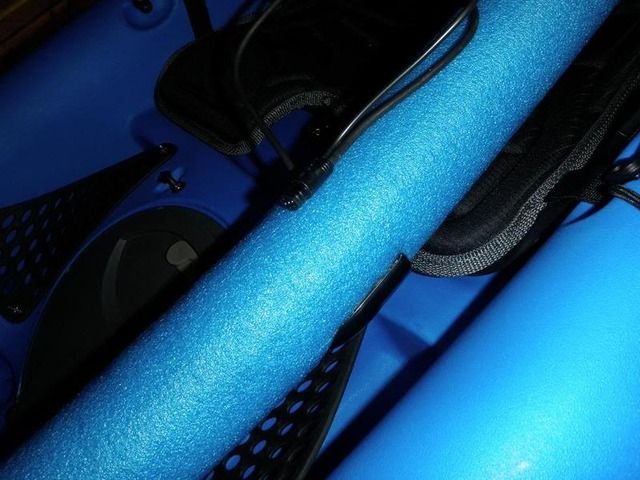

hydrospider
Been using the pool noodles for functional floatation for a few years now.
I dont know anything about rigging the hobie boats but maybe some of my ideas can help.
My intent was to create bulkheads that take up dead space and to have floatation that keeps all of my stowed gear in place so it is right where I left it when needed.
Ive also been using the noodles to hide any loose wires and it has worked out well.
Hope this helps.
I love the beer-pod!
Flyin Portagee
  • Date Registered: Jun 2011
  • Posts: 224
Hope this helps.
I really like what you did with it on the 4th pic from the bottom. Thats a great idea for keeping the rods in a rod pod from bouncing around when you're going through surf, it would help keep them in place for when you want to access them, and it adds a functional safety feature too.  Very nice!  :icon_salut:
