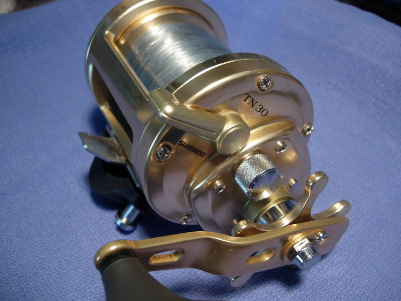

doubt that a kayaker would use a reel like this, but this arrived in the mail last month.
and with it came a note.

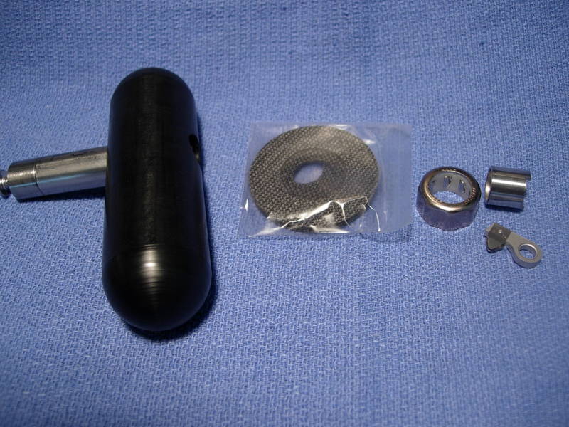

i called the owner and we spoke for quite a while.  i carefully explained to him what i thought the cause was, what his options were and where i thought this reel would now fit in his arsenal.  what we finally settled on were carbontex drags, an anti-reverse roller bearing, tube and dog, and an oversized handle grip.

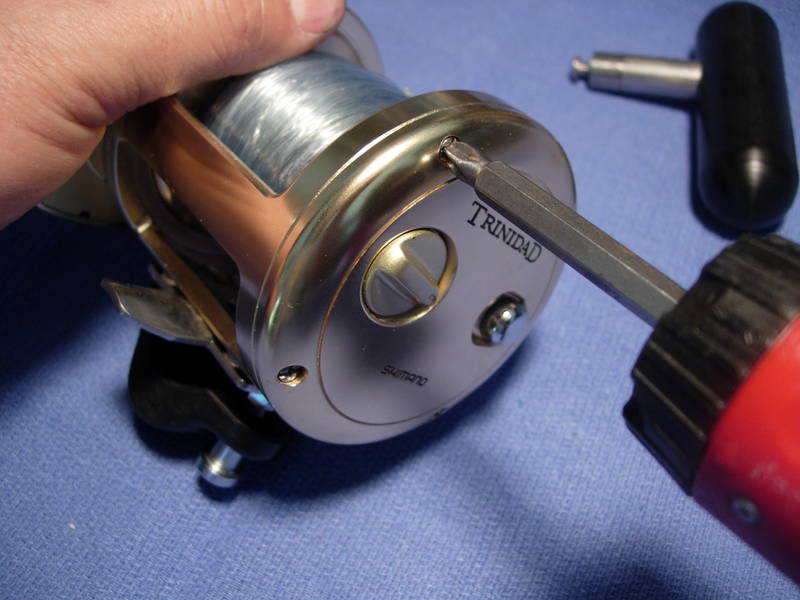

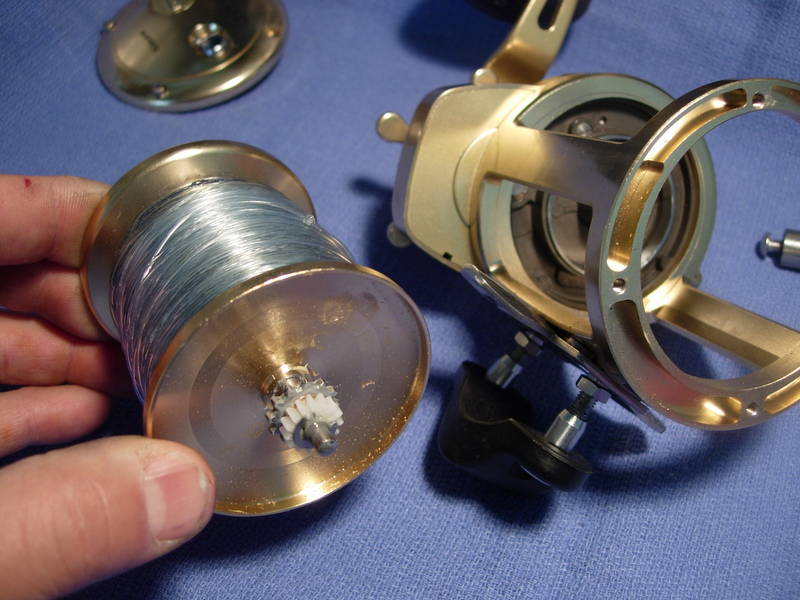

to service the spool bearings, remove the left side plate screws (key #767).
remove the left side plate assembly (key #307).
remove the spool (key #498).

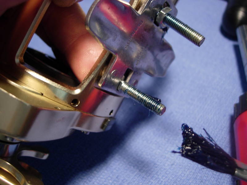

i see plenty of corroded rod clamps (key #351, 352, 353, and 354). let's grease the bolts so we don't have to worry about this anymore.

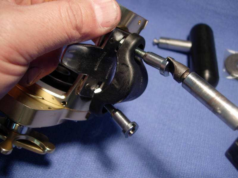

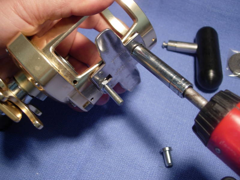

the right spool bearing (no key #) is 6x12x4mm and is rusted.  it's a common problem.  to remove the bearing, we need to remove the cross pin (no key #).  squeeze the cross pin halfway with a pair of vise grips that have a slot cut it in.
now we're going to use the drill press to push the pin out the rest of the way.  i've tried to punch them out freehand.  it's not easy.
install the new bearing and cross pin.

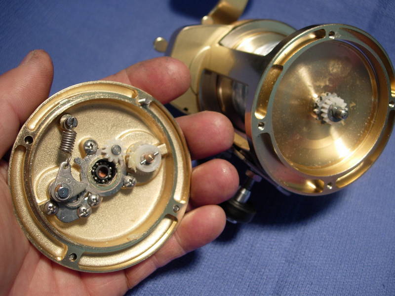

the left side plate bearing (key #484) is 4x11x4mm.  remove the bearing retainer (key #318).
loosen the three "br" set plate screws (key #328) that surround the bearing.
pull the bearing out with your bearing pulling tool.
this bearing is fine, so let's clean it out with carb cleaner and compressed air, lube it with corrosion x and re-install it.

install the spool (key #498).

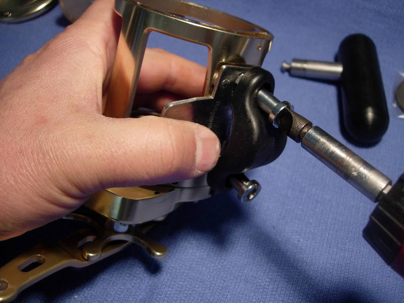

now for the right side.  first, remove the handle nut plate screw (key #128).
remove the handle nut and plate (key #'s 261 and 262).
remove the handle (key #495) and drive shaft shield (key #264).

now we're almost ready to grease and install the new carbontex drag washers.
the carbontex washer that goes underneath the main gear is 1.14 mm thick.
this is a penn ht-100 drag washer from a 4/0 senator, part #6-113h.  it is a little thicker and the inside diameter is just a hair larger.
i had noted that the drag pressure in a few trinidad's maxed out at 15#'s of drag using the thinner carbontex drag washer under the gear.  by substituting the thicker penn ht-100 #6-113h, i was able to get 20#'s or better.  so that's what i do now.  it's no big deal for me, but might prove an inconvenience for you.  this is not a consistent problem, so go with the stock carbontex drag washers first, check the drags, and then consider changing the washer under the gear if there is an issue.

install the drive shaft shield (key #264).
now for the handle. a full handle assembly is made up of three parts; the arm, the grip and the spindle in the middle.  i had an extra grip and spindle assembly made made by a local machine shop.  first, drill out the back of the original spindle, punch it out, and bolt on the new grip and spindle.
add a light coat of grease to the handle arm.  install the handle (key #495) and handle nut (key #262).
install the handle nut plate (key #261) and screw (key #128).
