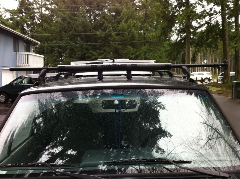

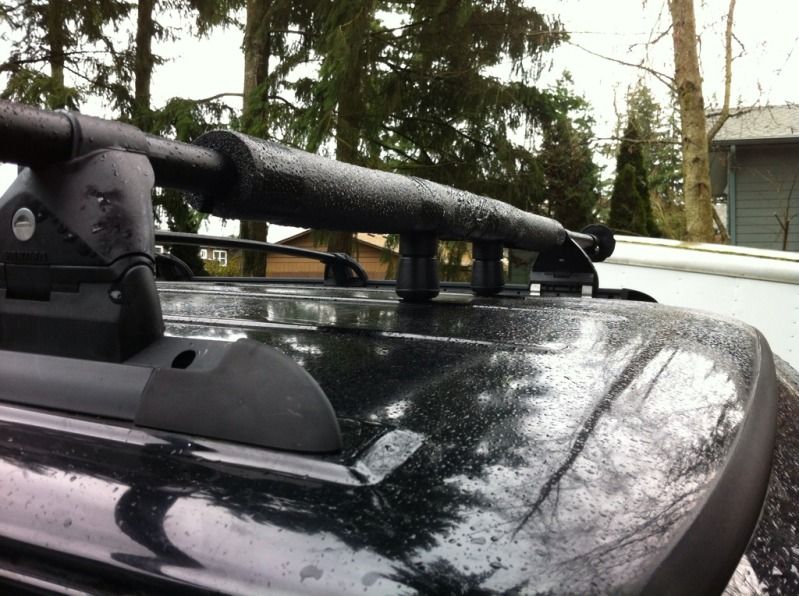

I was worried not about the weight of the Pro Angler on my 96 Cherokee, but the torsional twist the flexing of the front crossbar was putting on the rack towers.  While I love my rack setup on the stock rails, I also know that the rails are only held on each side by 6 screws through the roof.  That being said, the torsional twist could cause the mounting screws to weaken as the design is to old the rack down and not necessarily keep it from flexing to one side or another.  So, with my paranoia about losing my new investment and tearing up my jeep, i did the following mod with a couple of pieces of pvc and some bar stool feet.
I lined up the feet with the raised ridges in the roof as they are going to be the least likely to dent and have the most strength for supporting the rack.  I used the rack all weekend and have no dings or dents on the roof, so I am keeping it the way it is for a while.
After the mod, it looks great, there is no flex causing a torsional twist on my front rack mounts, and it just feels much stronger.
If anybody wants a DIY, I can do it, but here are the final mounted pics:
