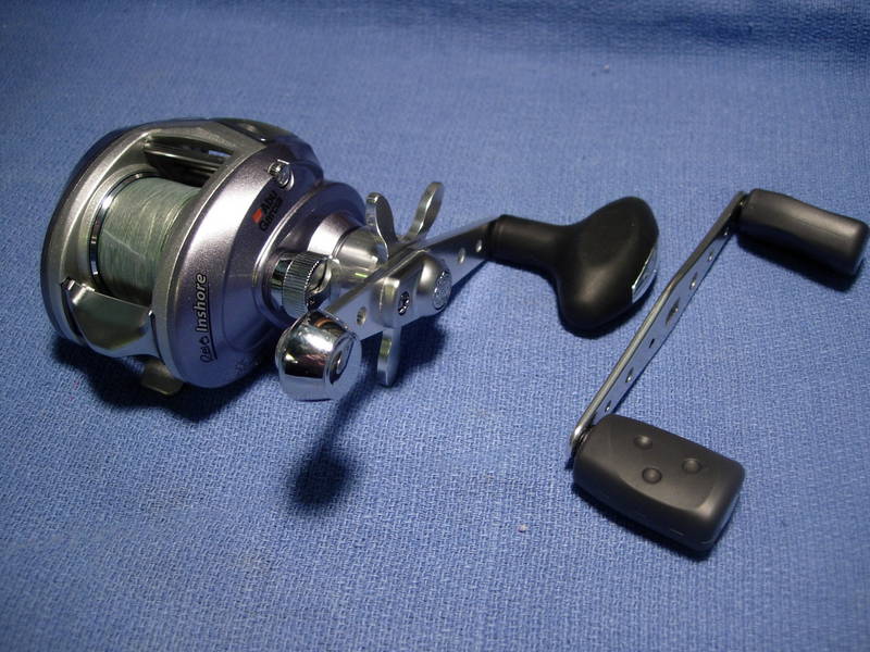

i never fish fresh water so i actually do not own a reel this small, but i understand that these reels are quite popular. i could not find the schematics anywhere on the net.  if someone could find a link, i would appreciate it if you could post it.  i do have a hard copy of the schematics with key#'s and part #'s.  as is typical of ambassaduer schematics, there are no names given to any of the parts.  i hope you will not mind if i make up the names as i go.
all i will do with this reel is replace a plain drag washer with a carbon fiber washer, grease all of the carbon fiber drag washers, and clean the bearings.

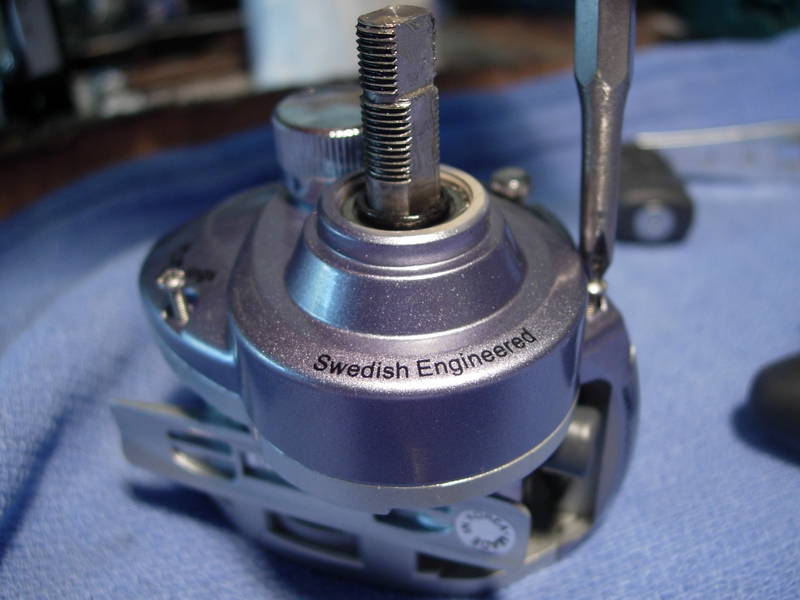

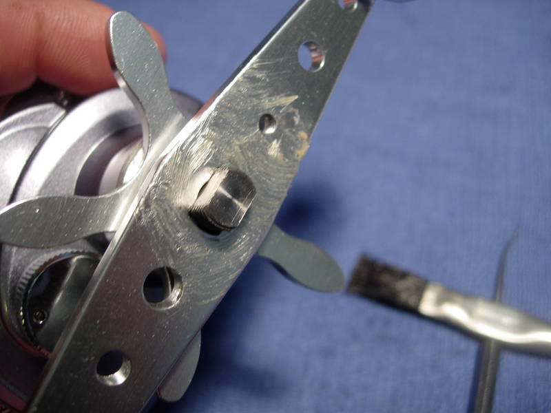

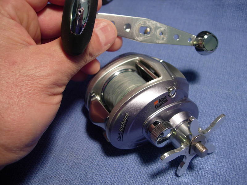

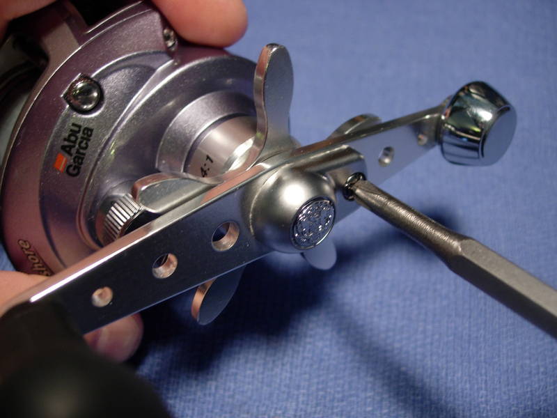

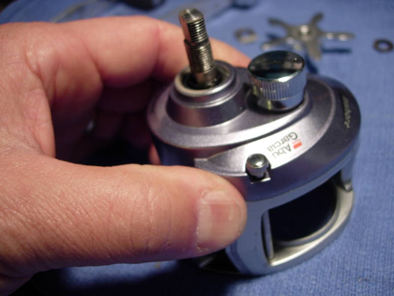

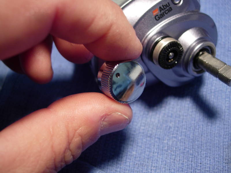

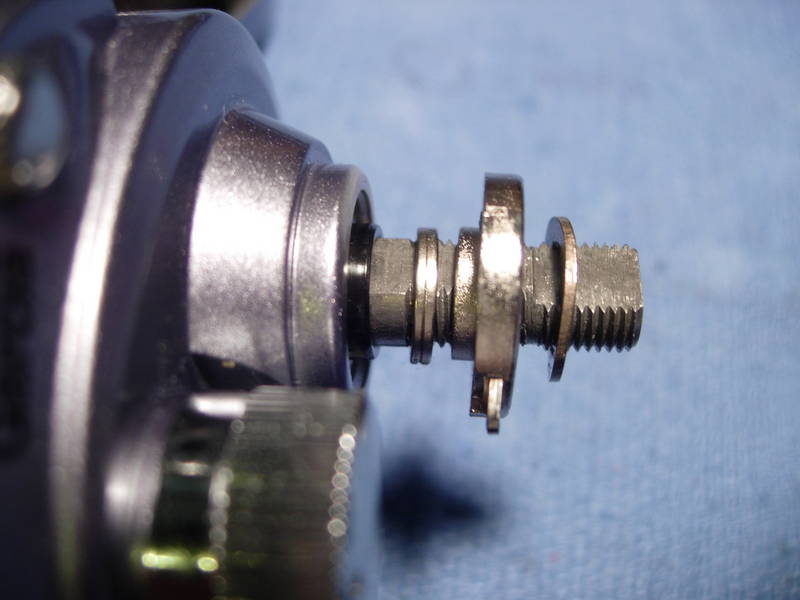

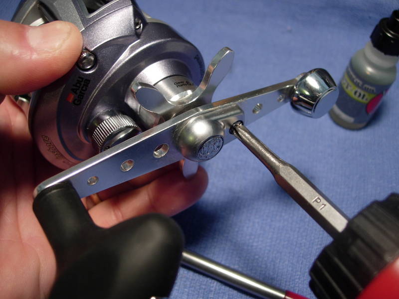

remove the handle nut cap screw (key #75) and the handle nut cap (key #74).

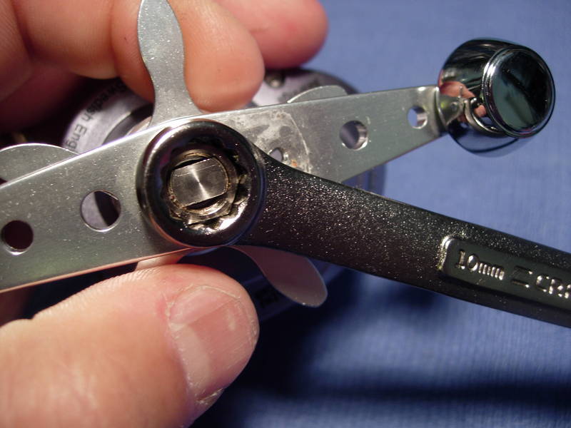

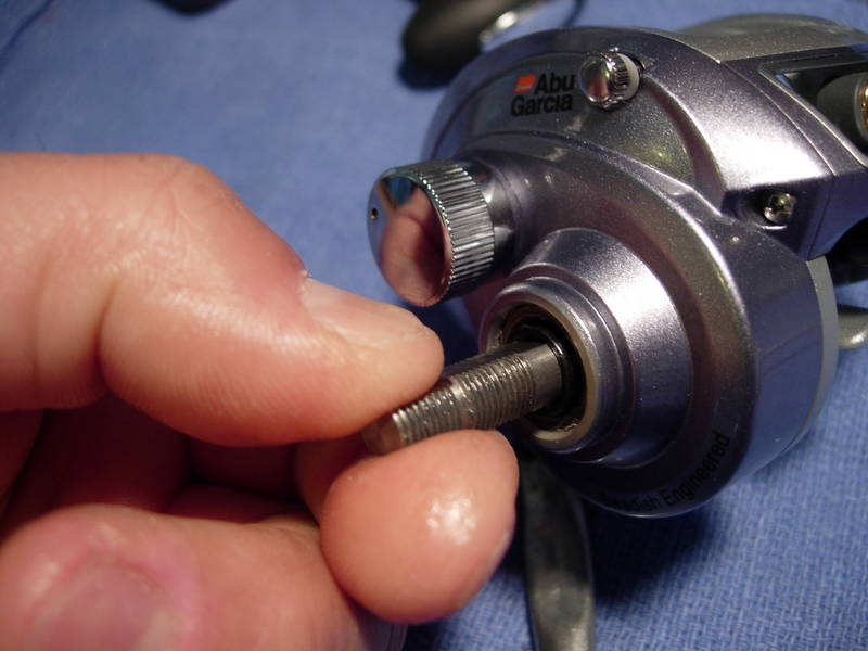

remove the handle nut (key #73) with a 10mm wrench.
remove the handle (key #94).

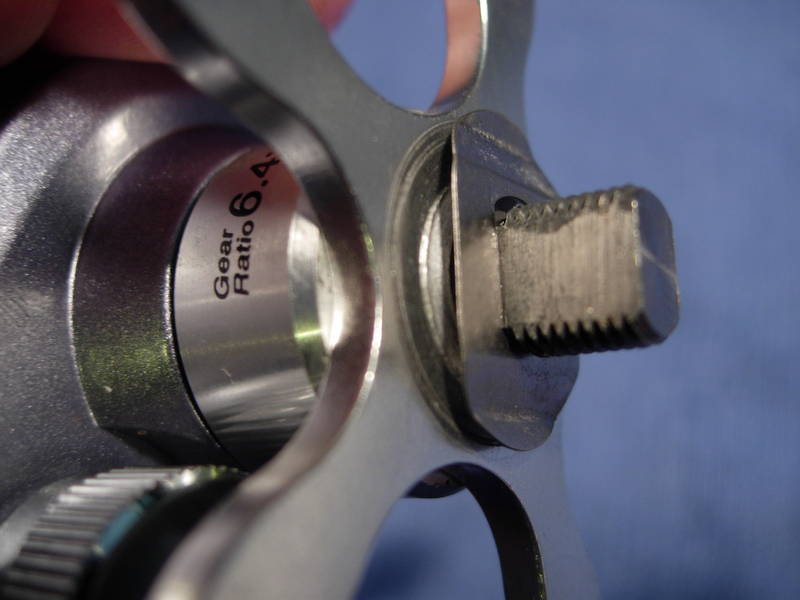

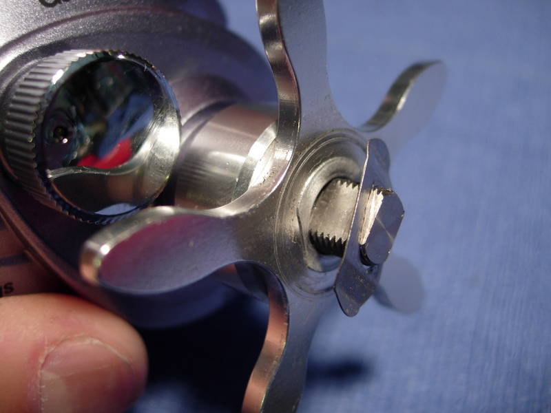

remove the handle spring (key #71) and star (key #70).
remove the spring washers (key #69), the star clicker assembly (key #67 and 68), and the handle thrust washer (key #47).

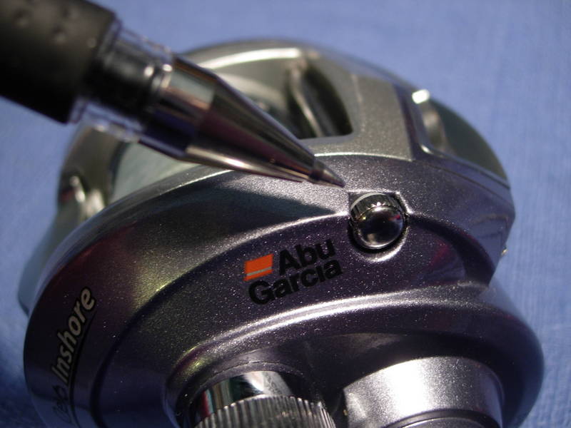

back out the thumb screw (key #61) but leave in place.

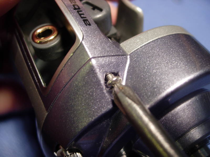

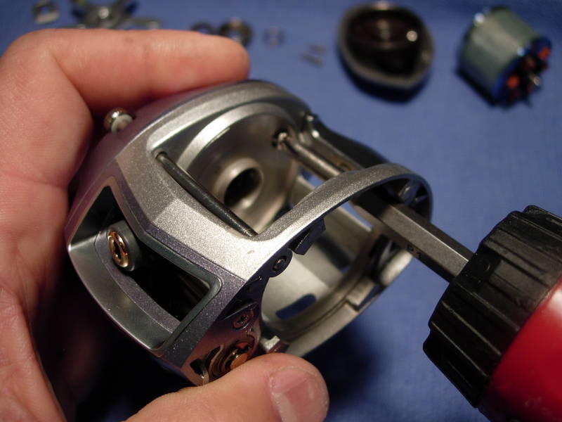

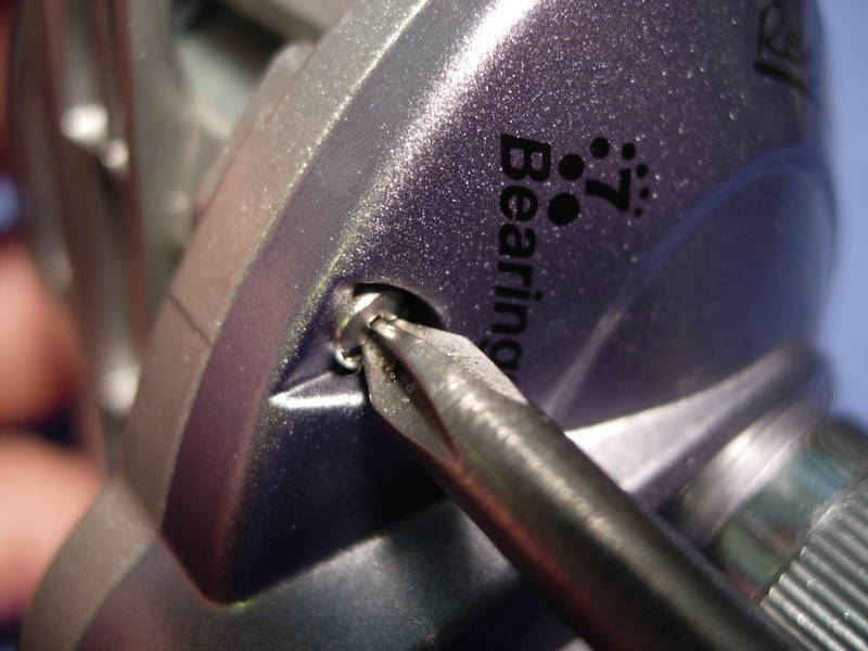

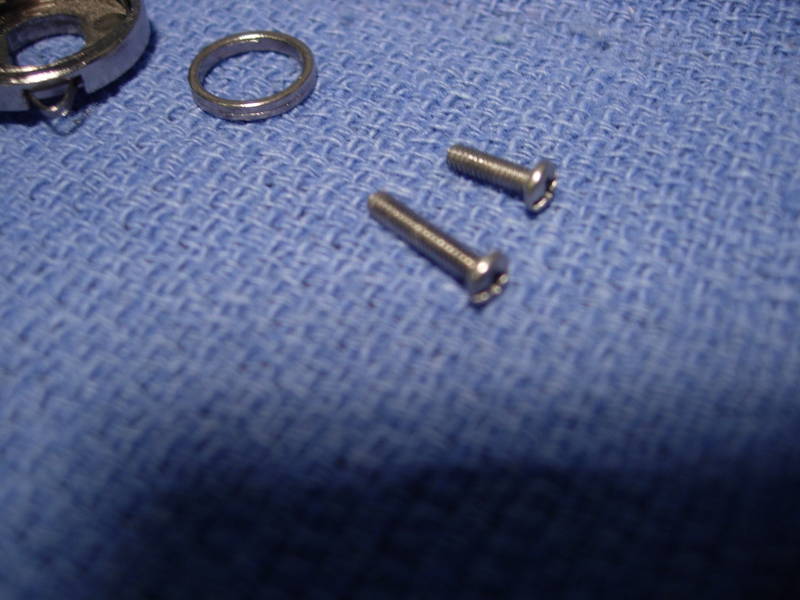

remove the two side plate screws (key #64 and 65).

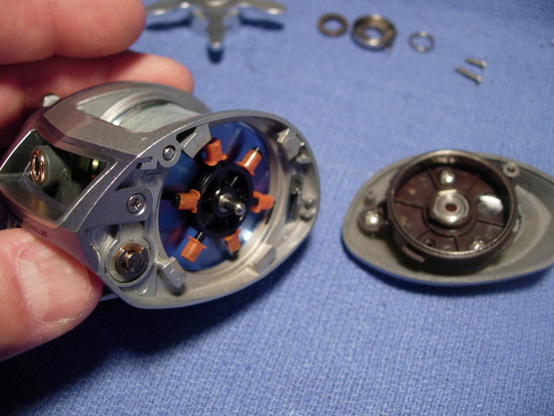

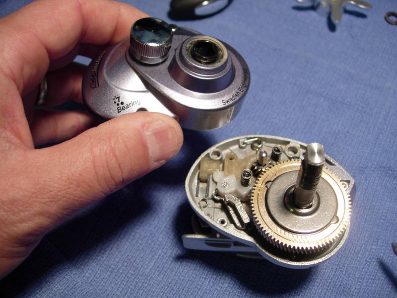

rotate and remove the left side plate assembly (key #77).
remove the spool assembly (key #76).

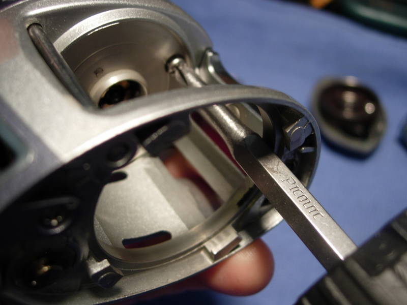

there is one last inner right side plate screw (key #66) that will need to come out.

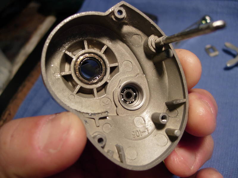

remove the right side plate (key #65).

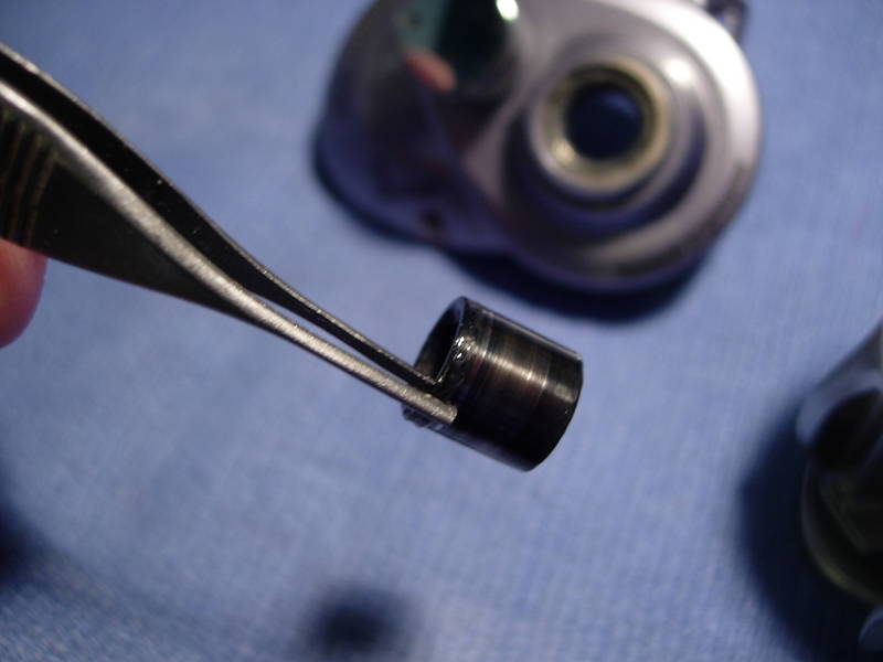

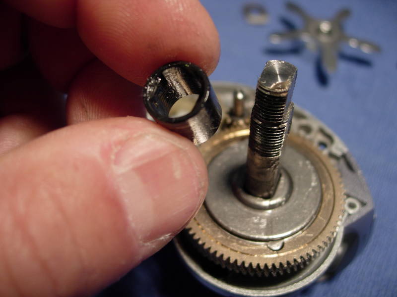

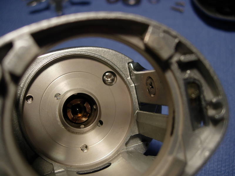

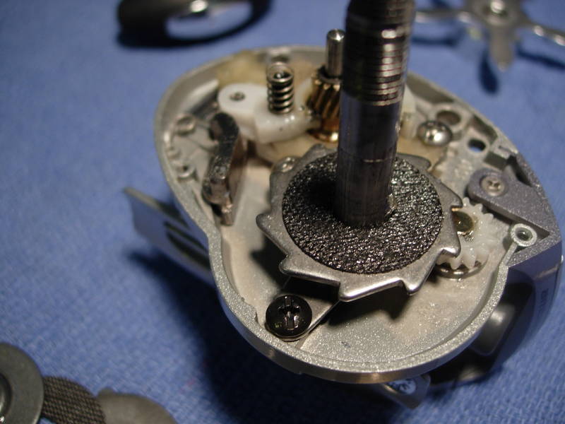

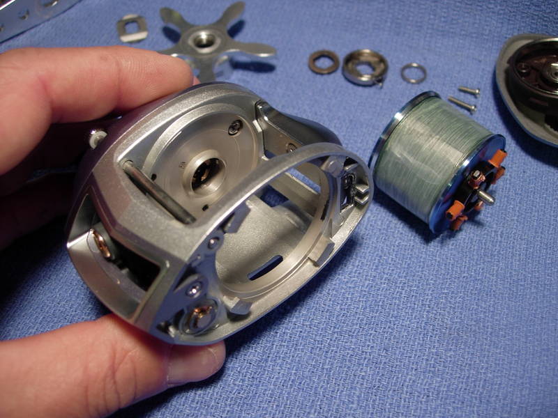

here's an inside view of the right side plate bearing (key #53), the integrated anti-reverse roller bearing (no key #, translation - not user serviceable), and the roller bearing inner tube (key #46).  the right side plate bearing is 3x10x4mm.
remove the roller bearing inner tube (key #46) and set it aside.

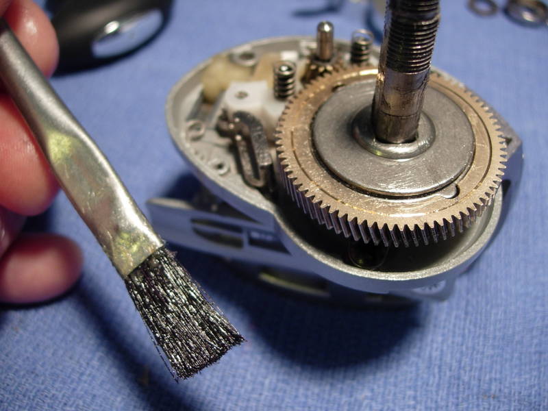

take a moment now to brush a little grease on the inside of the right side plate and a little corrosion x to the anti-reverse roller bearing.

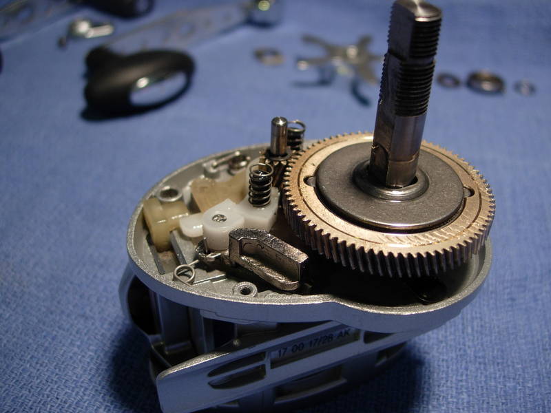

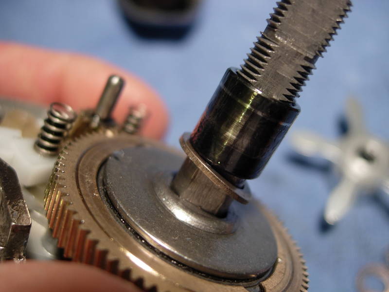

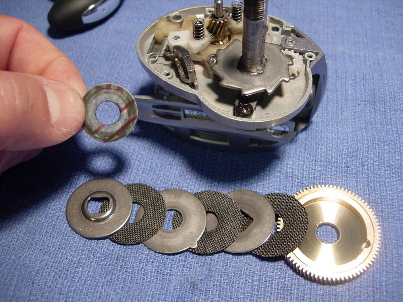

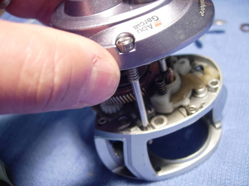

now for the gear cluster.

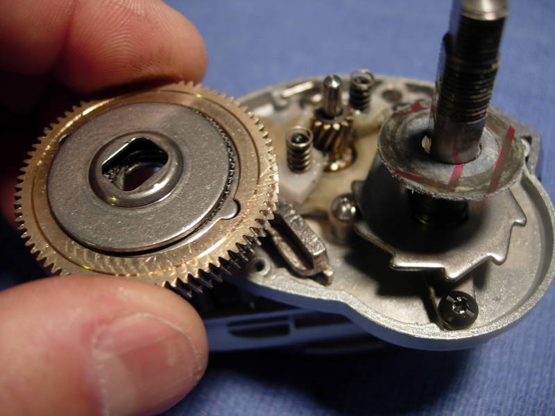

in a new reel, the gear cluster should slide right off.
let's line everything up.  you see dry carbon fiber drag washers (key #42), stainless steel washers (key #43, 44 and 45), the main gear (key #41) and a fiber washer (key #40).

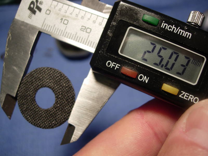

the carbon fiber drag washers inside the gear are 9x25x0.5mm.
the fiber washer under the gear is 8x20x0.85mm.

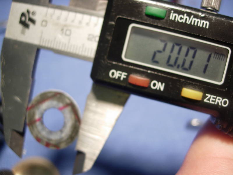

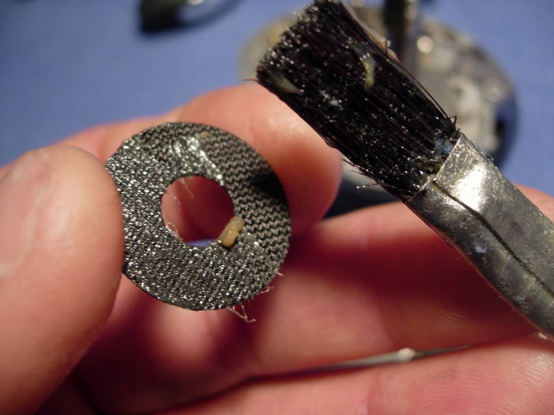

we are going to substitute a carbontex drag washer from smoothdrag.com for this fiber washer. smoothdrag has a set of four washers intended for the round ambassaduers.   the smallest one of that set goes underneath the main gear and is about 20mm.  this is the one that i will be using.  you could also put a
a penn ht-100 drag washer underneath the gear.  the part # for this washer is #6-965 and the dimensions of this drag washer are 8x25x0.85mm.  this washer would have to be cut down to 20mm.
let's grease all of the drag washers with cal's drag grease.
install the carbontex drag washer.
rebuild the drag stack.
install the roller bearing inner tube (key #46).
install the right side plate (key #51).
install the inner right side plate screw (key #66).
install the two outer right side plate screws (key #64 and 65).

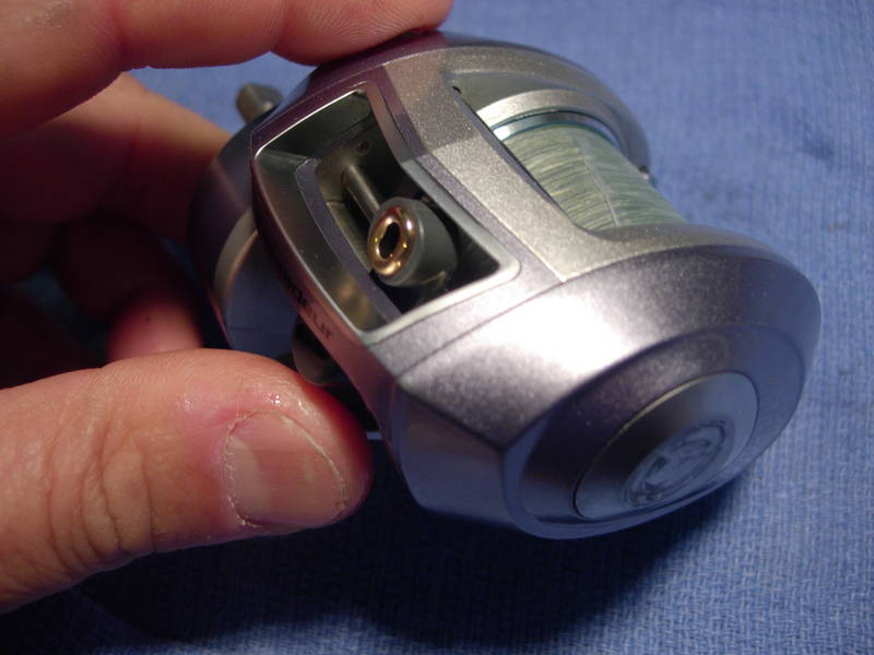

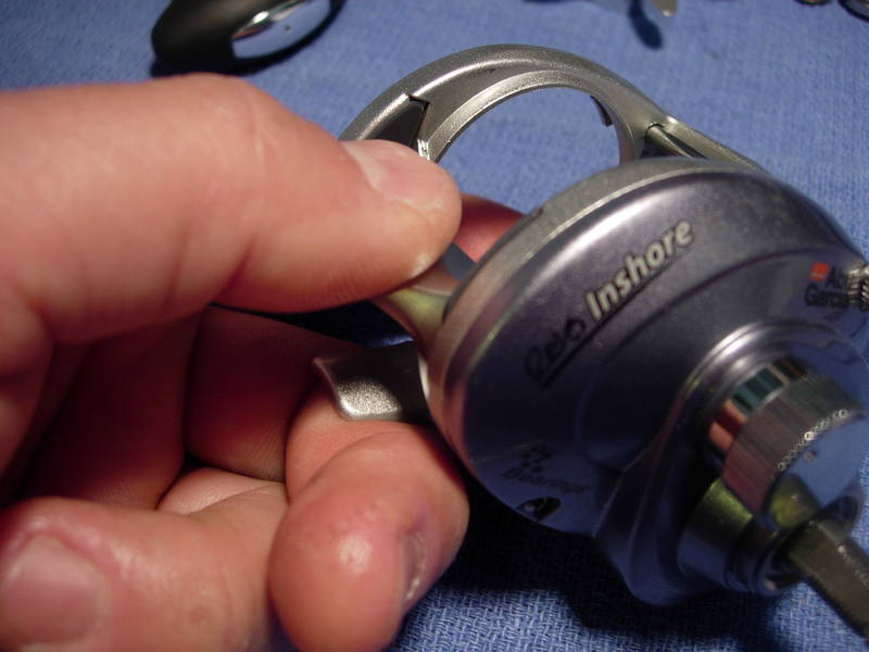

check the function of the free spool thumb bar (key #4).
check the function of the anti-reverse system.
the service for the right side plate is now complete.  assuming this reel will never see salt water, this is the last time you should need to open up the right side plate.  the greased carbon fiber drag washes should stay smooth forever.

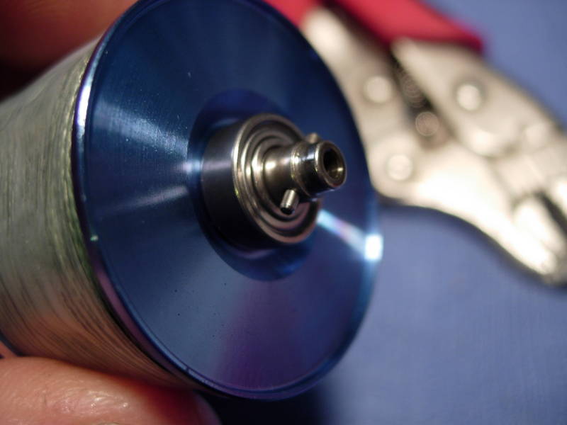

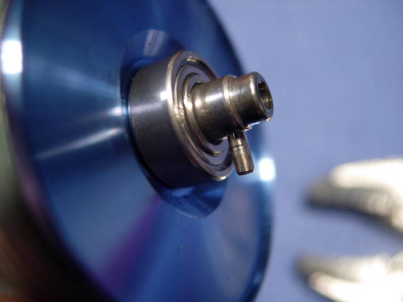

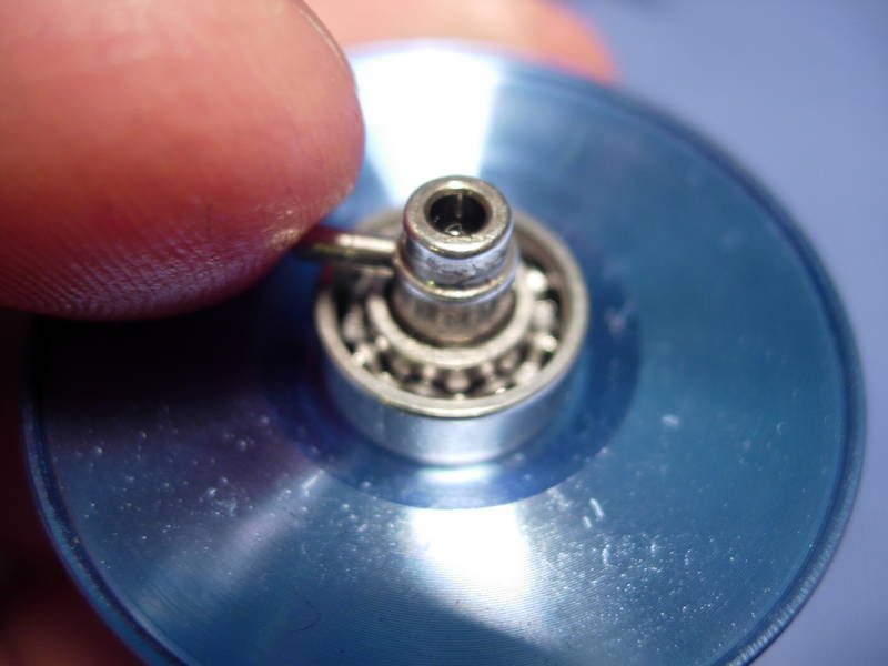

we are going to pull the right spool bearing, clean it, relube it and reinstall it.  a cross pin very inconveniently holds the bearing in place.  if this pin is lost or damaged, you may have to make another from stainless steel welding rod stock, or buy a new spool and repeat the proceedure all over again.  let us proceed.

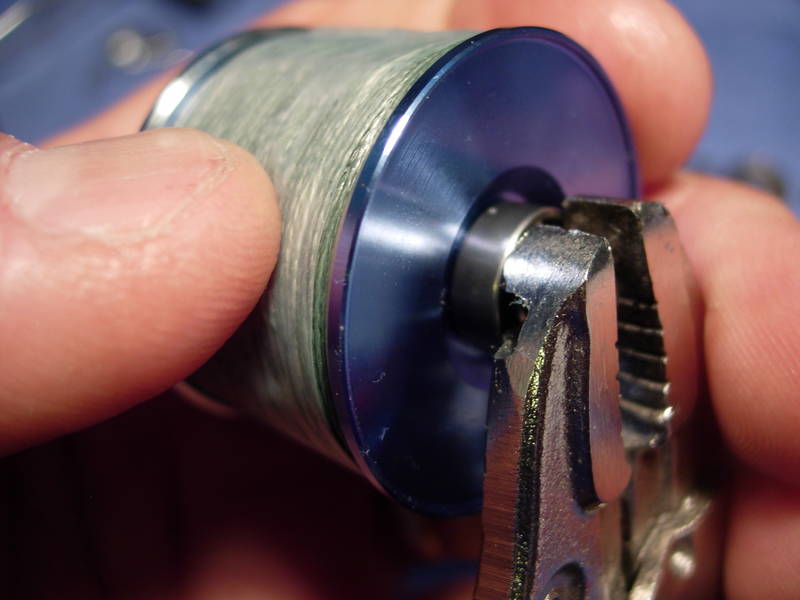

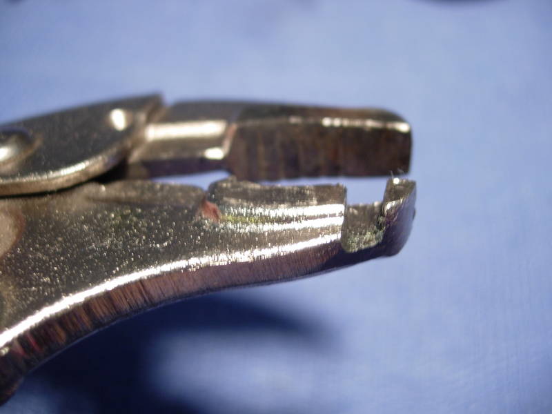

you've seen this modified pair of vise grips in the bearings post.

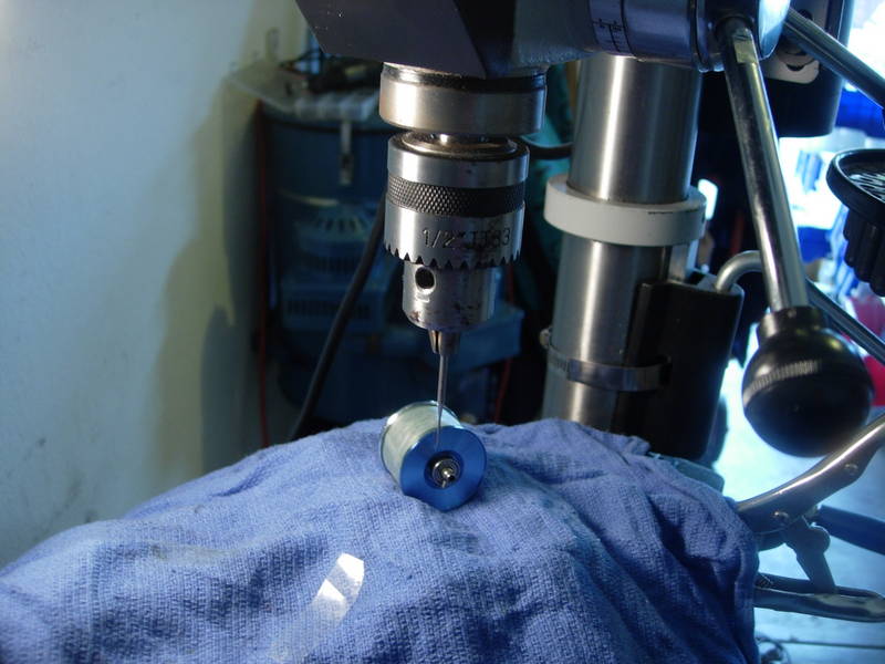

we will use it to push the cross pin out half way.  this pin was pushed out easily.  your cross pin may not be so.

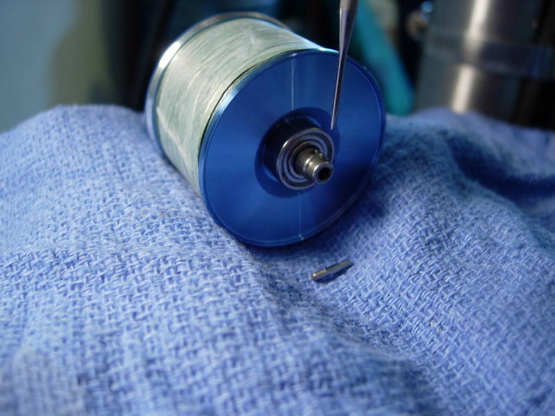

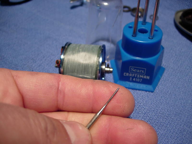

now i am going to take the smallest blade from a jeweler's screwdriver set.
it goes into the drill press chuck.
using the drill press, the cross pin is easily and cleanly removed.  if you try to pull the cross pin out with a pair of pliers, you may damage it.  been there.

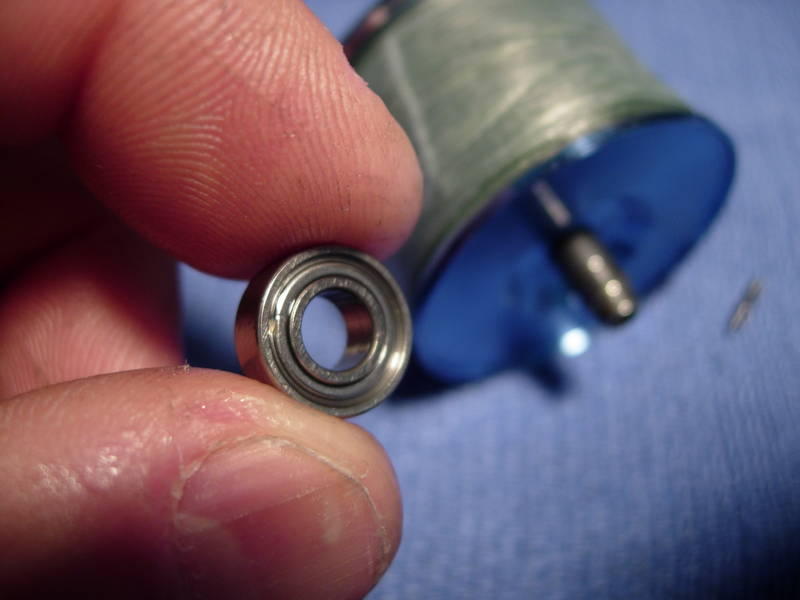

the right spool bearing slides right off.  it is 5x11x4mm.

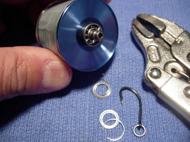

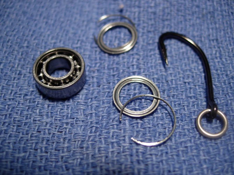

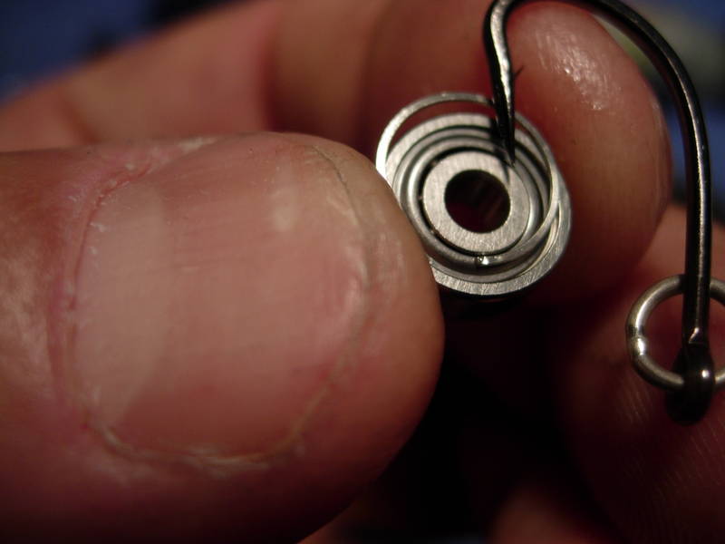

a number 1 ringed owner flyliner hook allows you to easily remove the retaining rings and shields from these bearings.  a sharper hook does make a difference.
the bearing is cleaned with carburator cleaner and compressed air, lubed and reinstalled.
the cross pin is centered with the vise grips.
now that the bearing is open, it can be properly cleaned and relubed after every fishing trip without having to remove the cross pin.

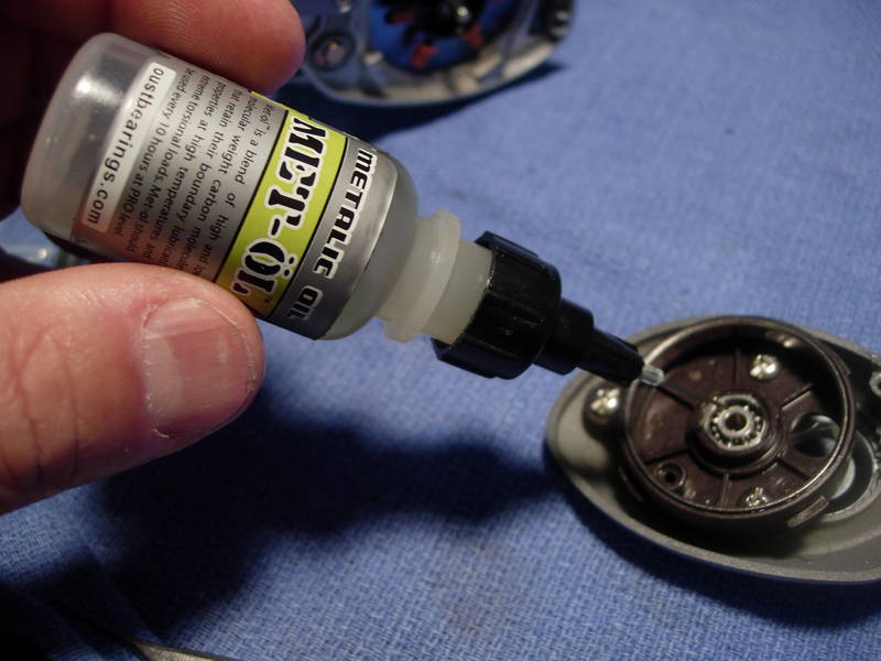

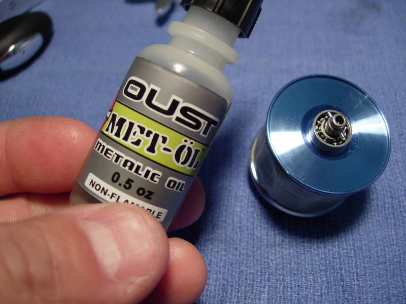

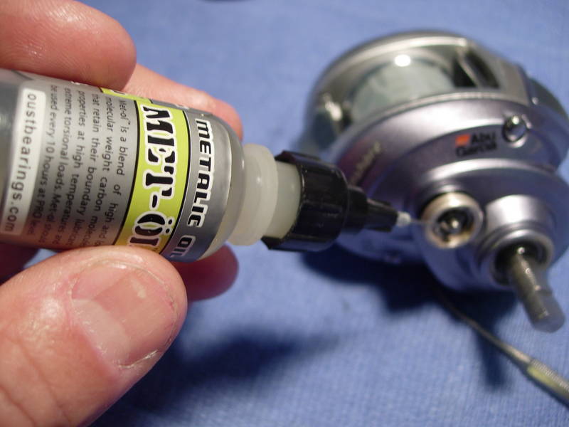

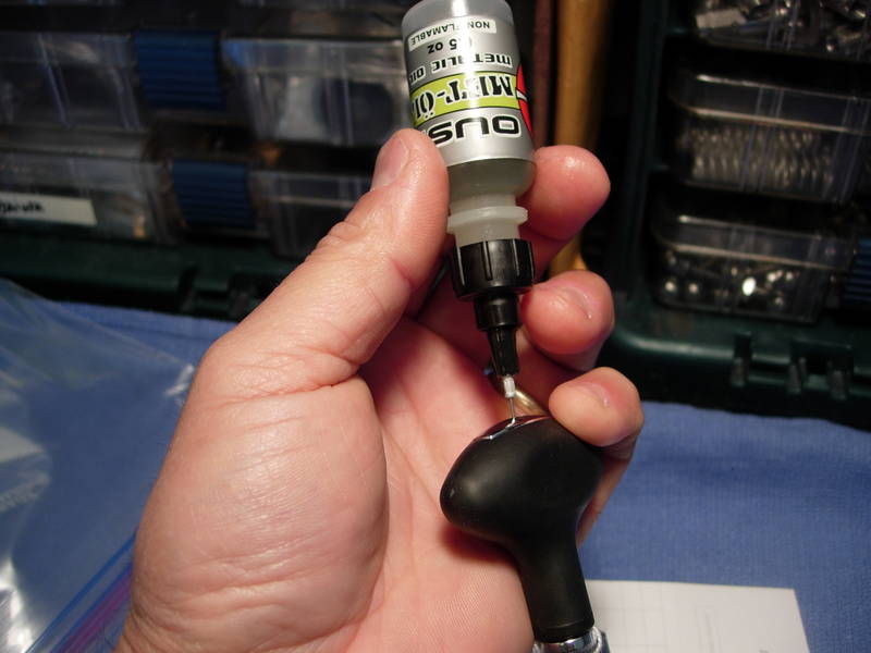

the owner of this particular reel requested a lighter lubricant because this reel will never see salt water.  there are many to choose from.  i've selected oust met-ol from smoothdrag.com.

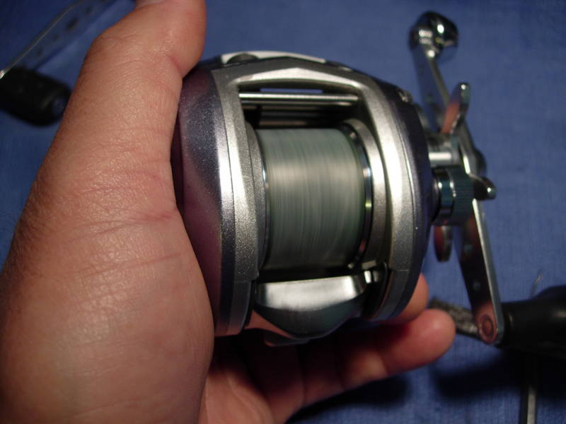

install the spool assembly (key #78).

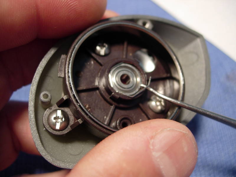

remove the left side plate bearing retaining ring (key #69).
the left side plate bearing (key #68) is 3x10x4mm.  remove the bearing with your homemade bearing puller.
remove the retaining rings and shields.
clean the bearing with carburator cleaner and compressed air, reinstall the bearing (key #68), reinstall the retaining ring (key #69) and lube the bearing.

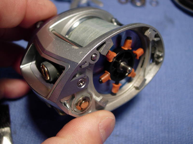

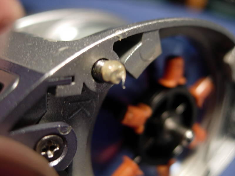

place a small dab of grease on the left side plate retaining thumb screw (key #61) and select the number of brakes that you wish to use.
install the left side plate (key #51) and tighten down the thumb screw (key #61).

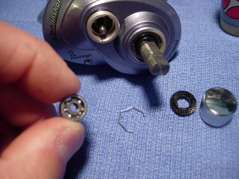

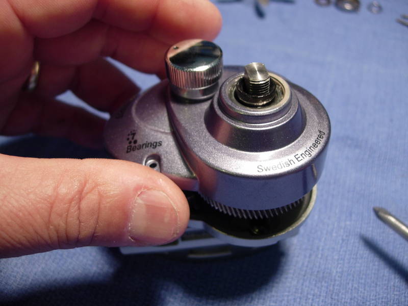

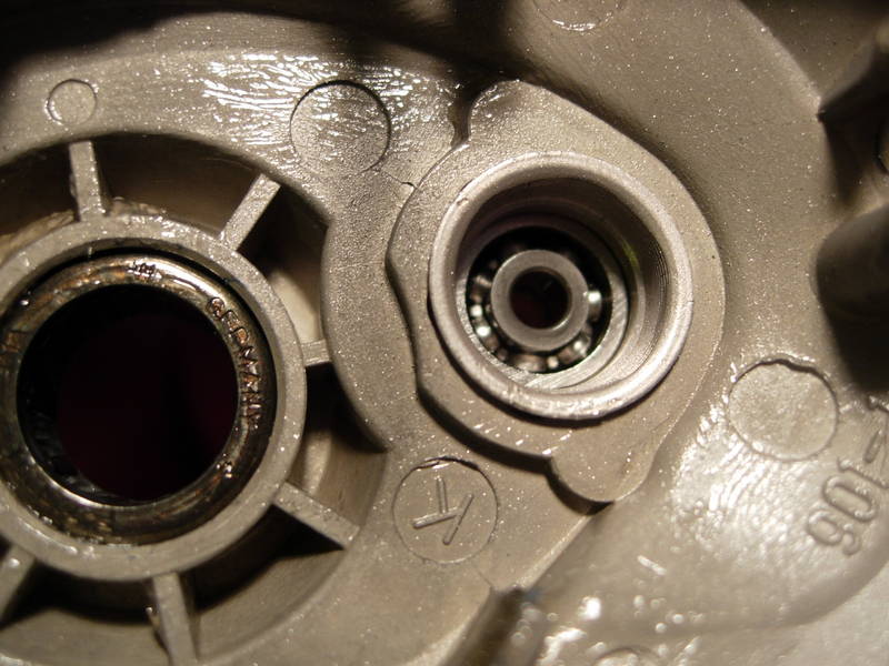

remove the right side plate bearing cap assembly (key #56-60).
remove the click plate (key #55), the bearing retaining ring (key #54) and the right side plate bearing (key #53).  the right side plate bearing measures 3x10x4mm.  note that a bearing thrust washer (key #52) remains in place in the right side plate.
clean the bearing (key #53) with carburator cleaner and compressed air, then lube and reinstall it.  reinstall the retaining ring (key #54), the click plate (key #55) and the right side plate bearing cap assembly (key #56-60).  adjust the bearing cap until you have zero load and zero freeplay.  it may be tighted slightly at a later time, depending upon conditions on the water.

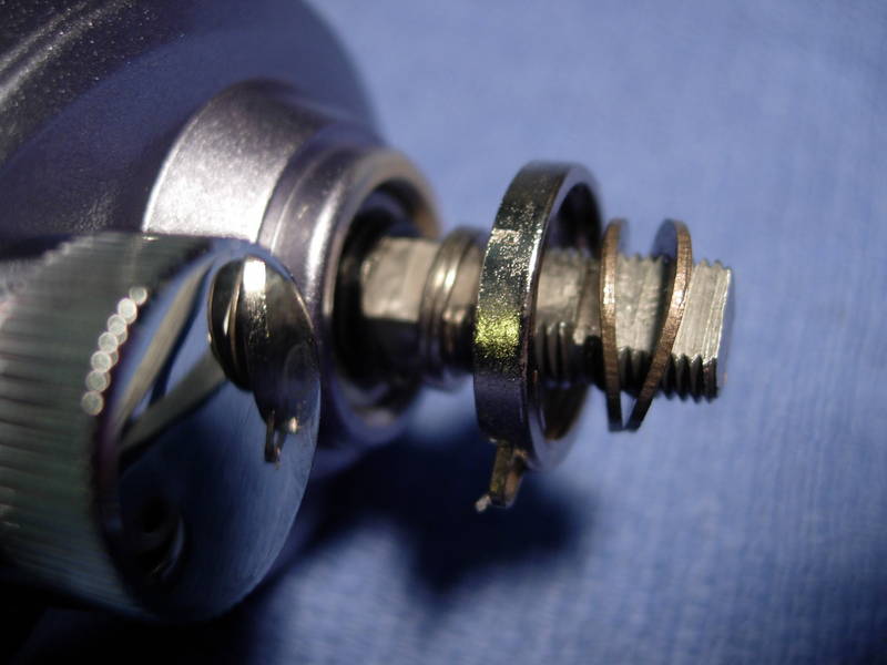

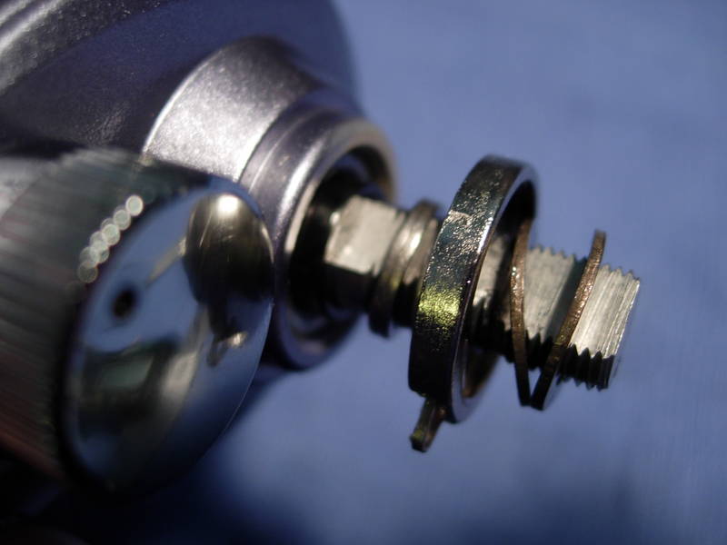

install the thrust washer (key #47), star click assembly (key #67 and 68), and the two spring washers (key #69) oriented "()".
install the star (key #70).  as you turn the star clockwise down, it will seat against the click tongue (key #68).  push in the click tongue manually and continue to turn the star clockwise until it seats fully.
install the handle washer spring (key #71).

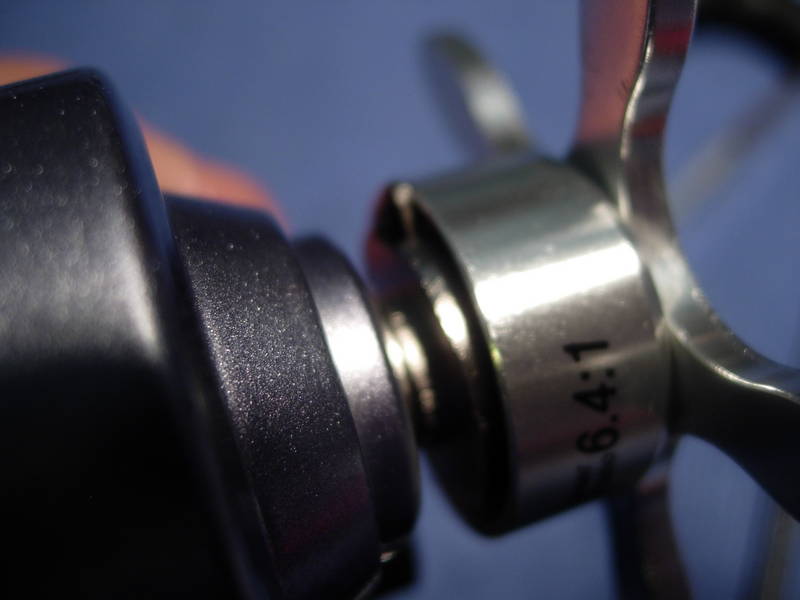

add a light coat of grease and install the handle (key #72 or 94).
install the handle nut (key #73), the handle nut collar (key #74) and the handle nut collar screw (key #75).  make sure that the handle nut is seated properly.
add a small amount of oil to the handle grip.

to increase the drag range, i made a slight modification to the order of the spring washers (key #69).
http://www.fullspeedfishing.com/gallery/data/500/medium/revo_008.jpg
i placed one spring washer (key #69) underneath the anti-reverse roller bearing inner tube (key #46).
that raised up the lip of the inner tube (key #46).
after reassembling the reel, i was able to get an easy 15#'s of drag. i opted to not push the reel further because concerns regarding possible damage the main and pinion gears at those higher ranges.
