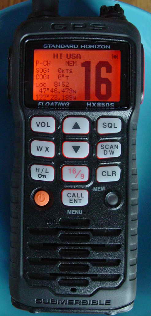

After 3 trips onto the salt water with the unit, I am glad I bought it.  First, I no longer carry my Blackberry on the kayak.  The BB was in a micro-drybag in my PFD, but I never really expected it to survive a true emergency situation in which I was in the water and needed to call.

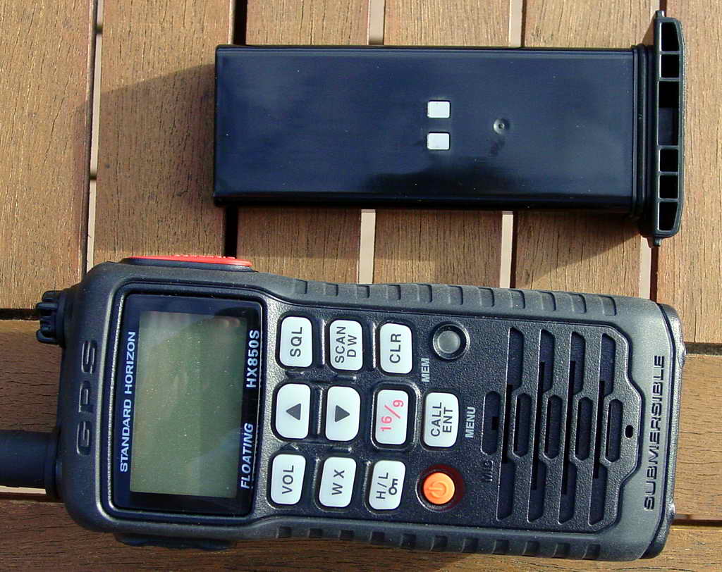

Overview of the Standard Horizon HX850S - overall size and rechargeable LiIon battery.  The battery slides into a tunnel and has a gasket on the bottom, the battery snaps in and a coin-turned lock on the bottom of the unit secures the battery.  I've not found any water in the battery compartment.
Some general features of the HX850S from the manual:
Submersible, floating, back light, transmission power easily selectable (for battery life extension), 12 channel internal GPS, all allocated US Canadian and International channels.  Dedicated channel 16 key, 10 NOAA weather channels, memory scanning, priority scanning, weather alert, digital selective calling with GPS.
Package includes, radio, antenna, belt clip, wall charger with snap in holder, and cigarette lighter charger.
The belt clip attaches conveniently to a cross strap on my PFD shoulder strap.  The unit does float.  It might be better if it was bright orange rather than black and I may consider painting mine.  Seems solidly built.  I've been rinsing it with abandon with tap water to no ill-effects.
The screen is large and readabilty is good, even for old, age-related presbyopian eyes.  The buttons are good-sized, though operation with bulky neoprene gloves may be an issue.  I thought I would miss a dedicated knob for volume and squelch, but the dedicated VOL and SQL buttons with the UP and DOWN buttons makes adjustments easy.  Hit VOL or SQL then UP or DOWN to adjust volume.  Dedicated channel 16 button.  WX button to take you to the weather channels, then UP/DOWN select the WX channel.  H/L key changes transmission power Hi (6w), M2 (5w), M1 (2.5w), Lo (1w).
The display can be setup to show your GPS coordinates as well as your speed and course.  I have mine set this way, figuring that my speed and course may be useful for recovery.  GPS locks are fast - much faster than my Humminbird.
The unit takes about as long to charge as it was turned on.  If you used it for 4 hours expect it to take 3-4 hours to charge back to full.
The unit is complex and requires an hour of setup.  The documentation is excellent and complete.  Take the time to carefully work through the entire setup.  It could save your life or someone else's.

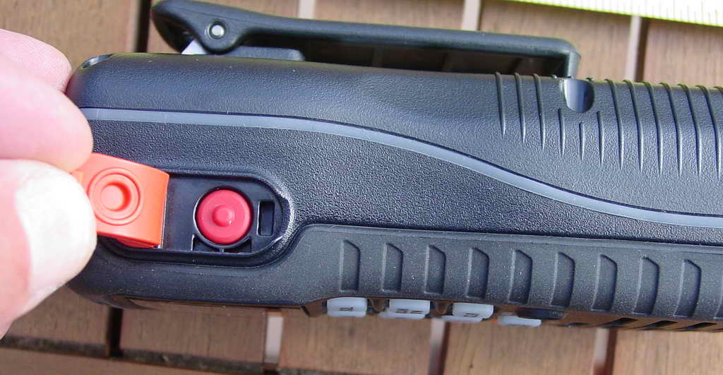

Most DSC/GPS handhelds, the LHR-80 and this one included, has a single dedicated distress call button.  Protected by a soft, red plastic safety cover, in the event of an emergency one flips up the safety cover, presses and holds the button down for a few seconds, and a distress signal with your GPS coordinates is transmitted.   The radio listens for an acknowledgement of your distress signal then switches to channel 16.  Your distress and GPS coordinates are displayed on any DSC unit within range.
