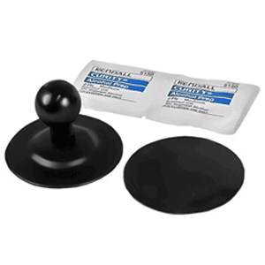

Look into these. It's a Ram ball meant to be glued to an inflatable. It works perfectly on the underside of the hatch.
Wow!  Thanks!
