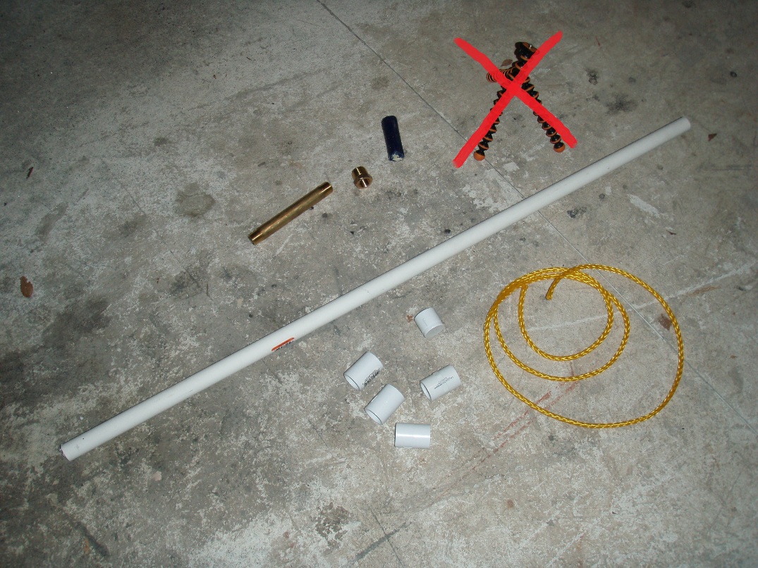

Anyway, I needed another extender arm for my camera/camcorder that could use the RAM base that came with the Xshot kayak package.  This was the best part of that whole package IMHO.  Off to the local hardware store!!  ;D

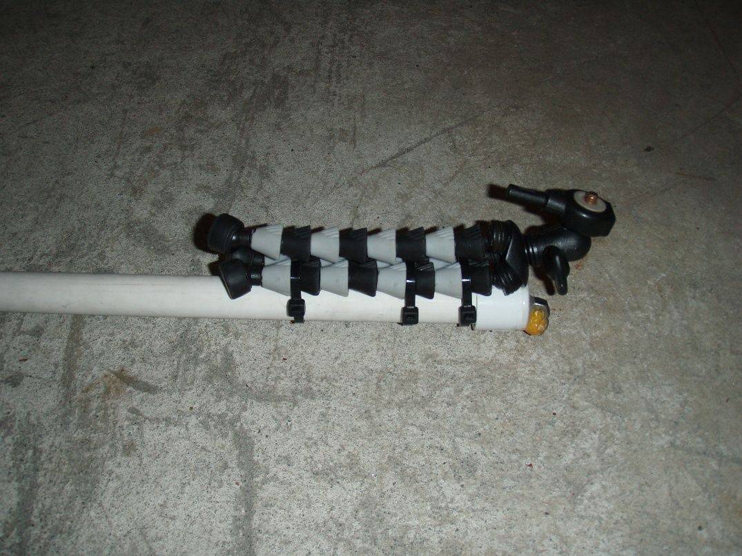

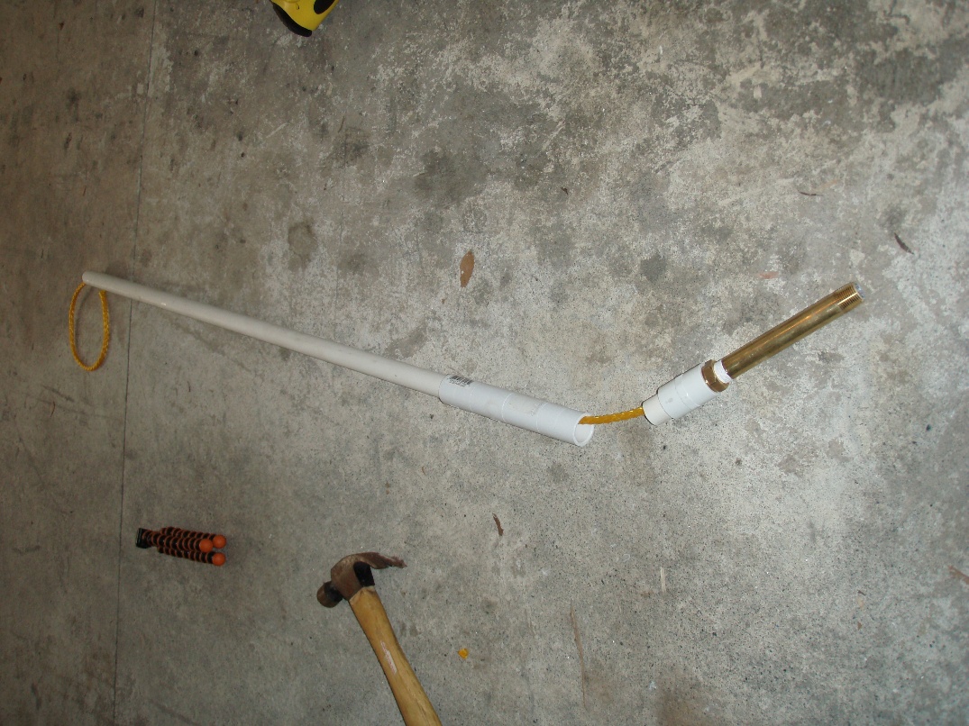

I realized that my first mount for my camera actually worked pretty well.  I simply zip-tied a mini tripod to the end of a Scotty light which was able to be placed on the utility rack I made for the X-Factor so it was elevated to look over my shoulder.  I decided I was going to go back to the zip-tied tripod idea.

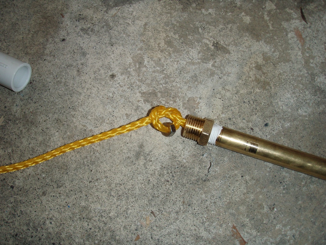

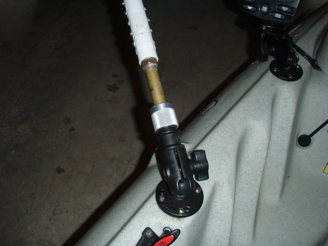

I found a perfect fitting for the base pretty quickly.  A brass nipple whose exact measurements have escaped me, but you'd know it if you saw it.  It is threaded on both ends and is a pretty standard piece since I've seen the same one with the same dimensions in a couple of different hardware stores.  Next, I found another brass fitting that connects this nipple with the PVC.  It is also pictured and I can't remember the name or dimensions, but it is also a very standard piece.  I picked up about 3 ft. of 1/2" PVC, an end cap, four slip connection fittings, and a PVC connection fitting that is threaded on one side(the side that joins with the brass fitting) and a slip fitting on the other side.  The rope runs through the inside so that if the extender arm breaks, I don't loose my camera/camcorder that is mounted on the end.  The tripod pictured didn't end up making the cut since it resulted in VERY shaky footage so I went back to the one I used in my first generation mount.

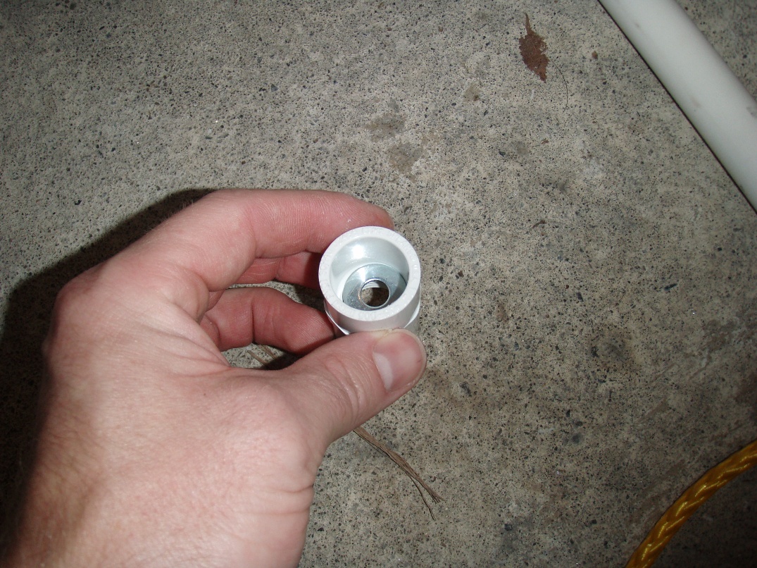

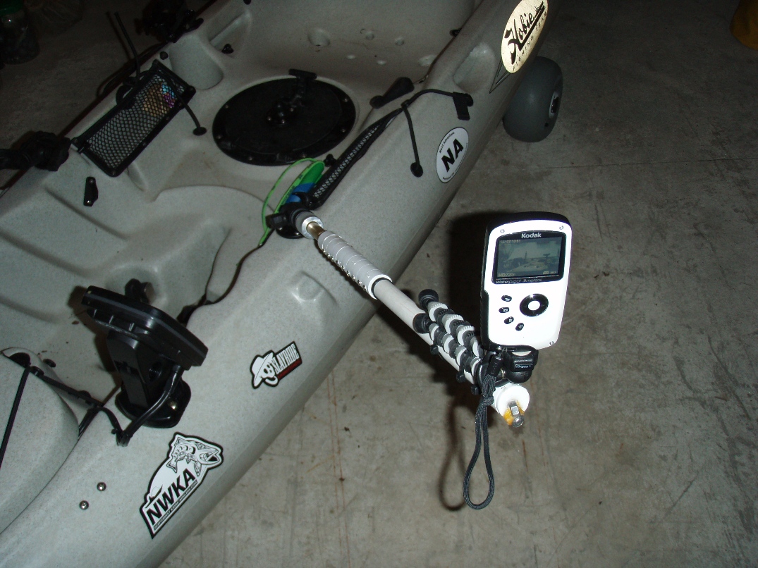

I decided to use all the slip fittings to make the thing more solid.  I cut a bunch of short segments to use inside the slip fittings so that the slip fittings touch each other and there is no space between them.  I ran the rope through the nipple and through the threaded PVC fitting.  After that, I tied a overhand knot with a stainless nut in the knot(pictured below).  I then put a stainless washer in the first slip fitting(pictured below).  This locks the rope into the handle end.  I threaded the rope through the whole thing once it was put together and out a hole drilled into the end cap.  I made another knot once the rope was threaded out the end cap with another stainless nut.  After that, I coated the end with a generous amount of Marine Goop to seal it all up.  The butt of the brass nipple was filled with Goop as well.  Essentially, the whole thing is sealed so I can dunk it without worrying about it filling up with salt water.  Finally, the tripod was zip-tied onto the end of the arm.

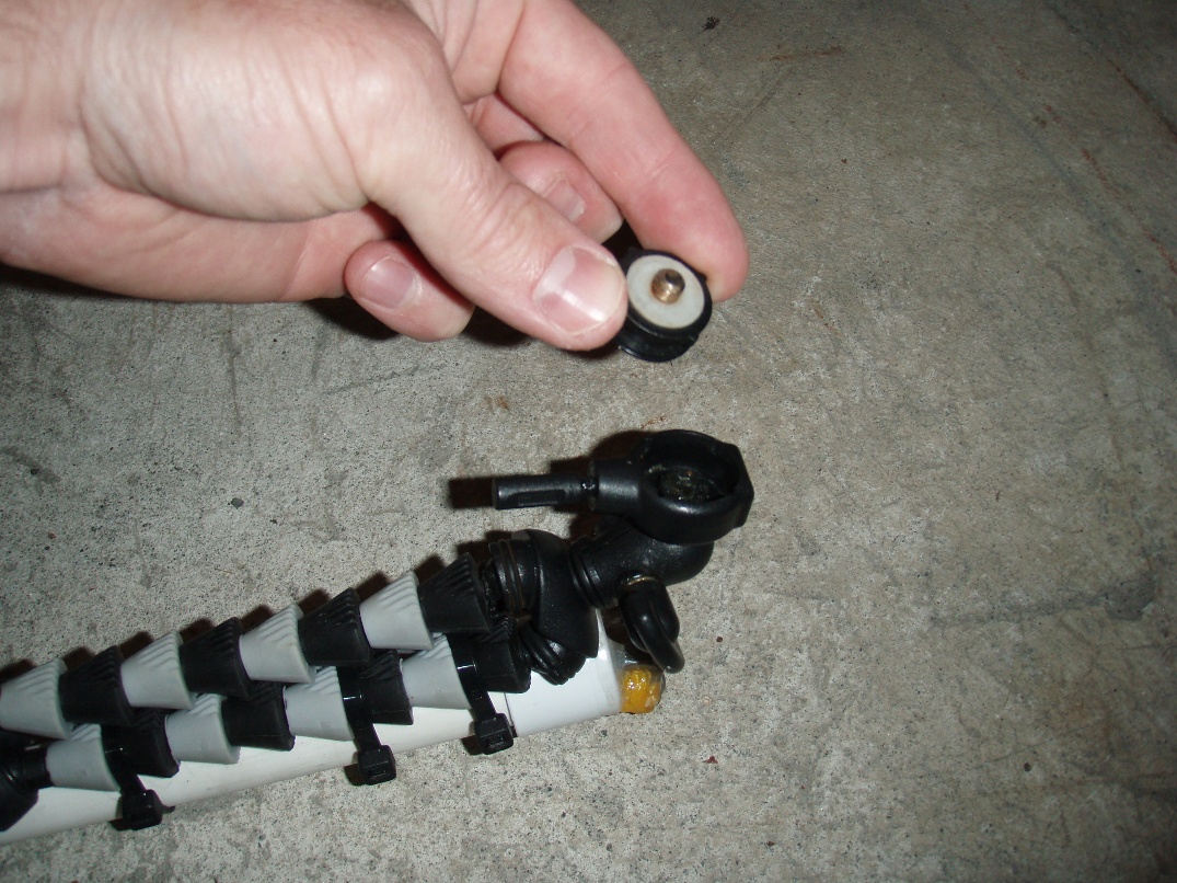

The tripod allows for easy, one-handed placement of the camcorder by using a removable base.  Very important

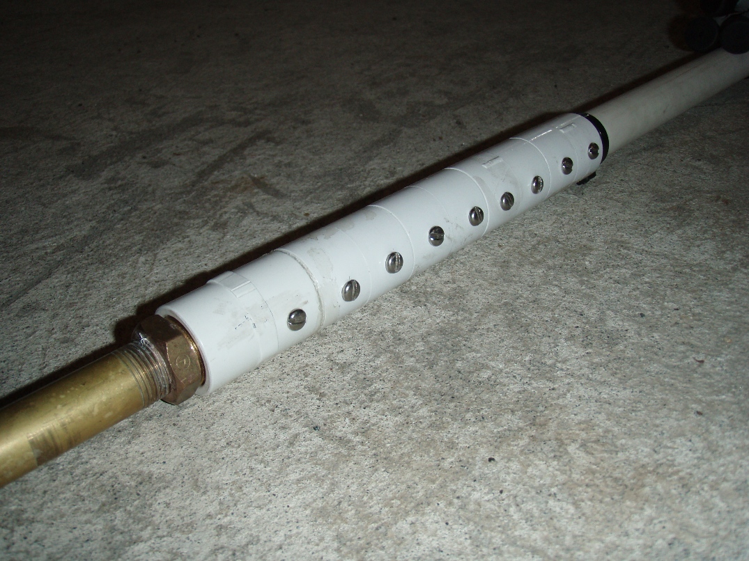

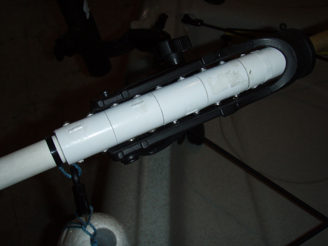

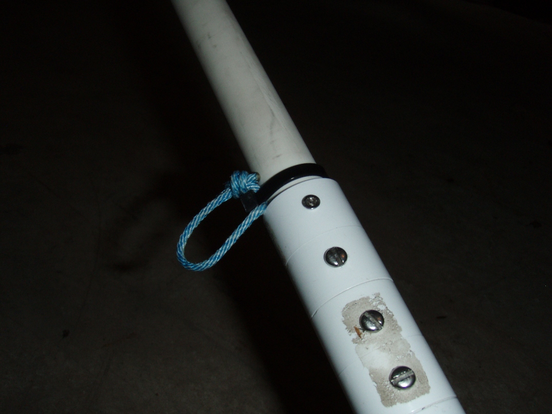

After a test run out on the ocean I realized that all the slip fittings gave the arm a lot of flex.  To fix this, I drilled small pilot holes in the slip fittings, then drilled small stainless screws so that the slip fittings and the PVC segments connecting them were screwed together.  This made it really solid.  I also added a zip-tie and a loop of tuna chord for a spot to clip on a float.

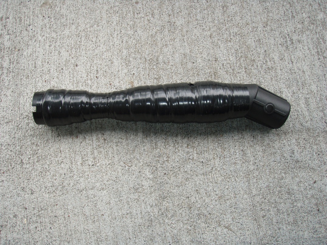

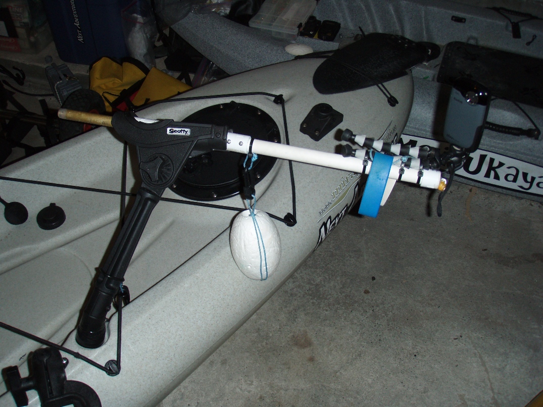

After I put the screws in, I noticed that it was very close to fitting into a Scotty rod holder I had laying around.  I backed some of the screws out a little bit so it could lock into the rod holder perfectly.  Next, I grabbed a Scotty gimbal mount and wrapped it in layers of insulation foam and electricians tape so it fit into the molded-in rod holders snugly.  I added a Scotty height extender and this provides a pretty good over-the-shoulder angle.
Modified Scotty gimbal mount:

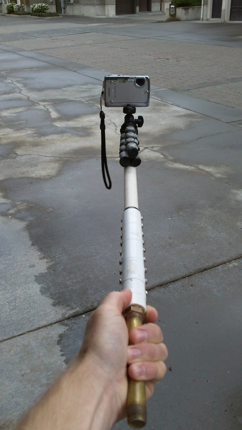

Done!!
