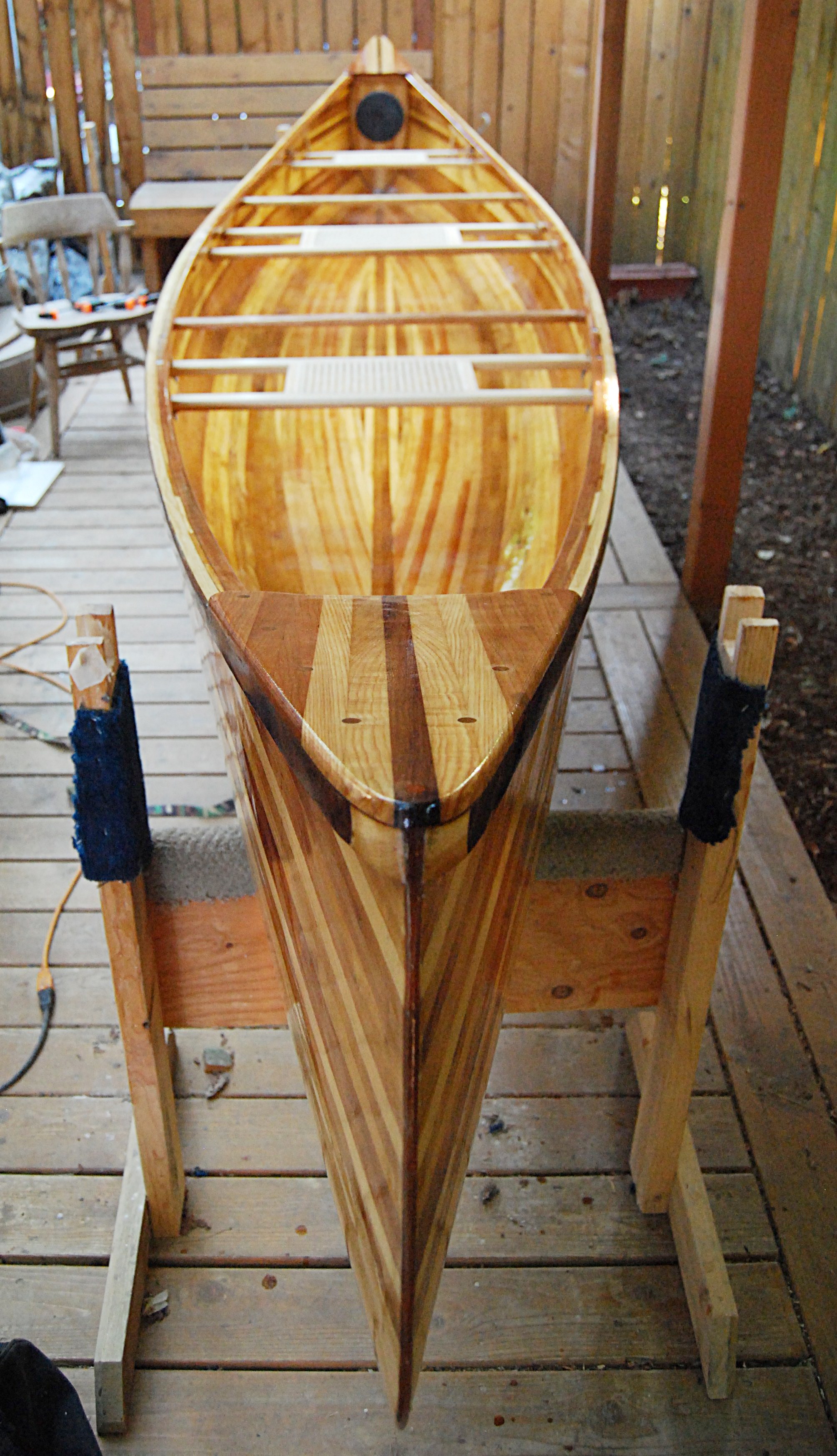

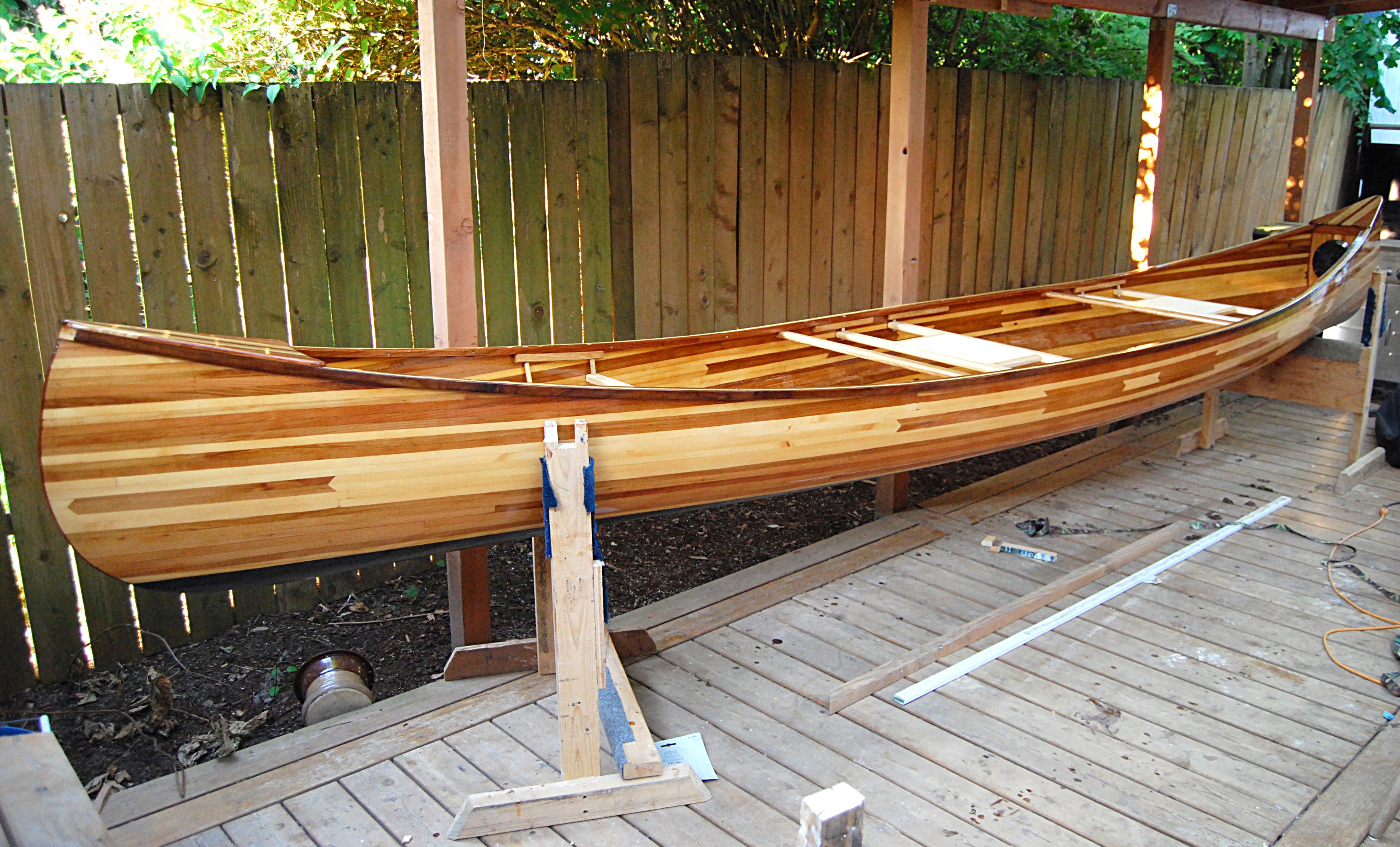

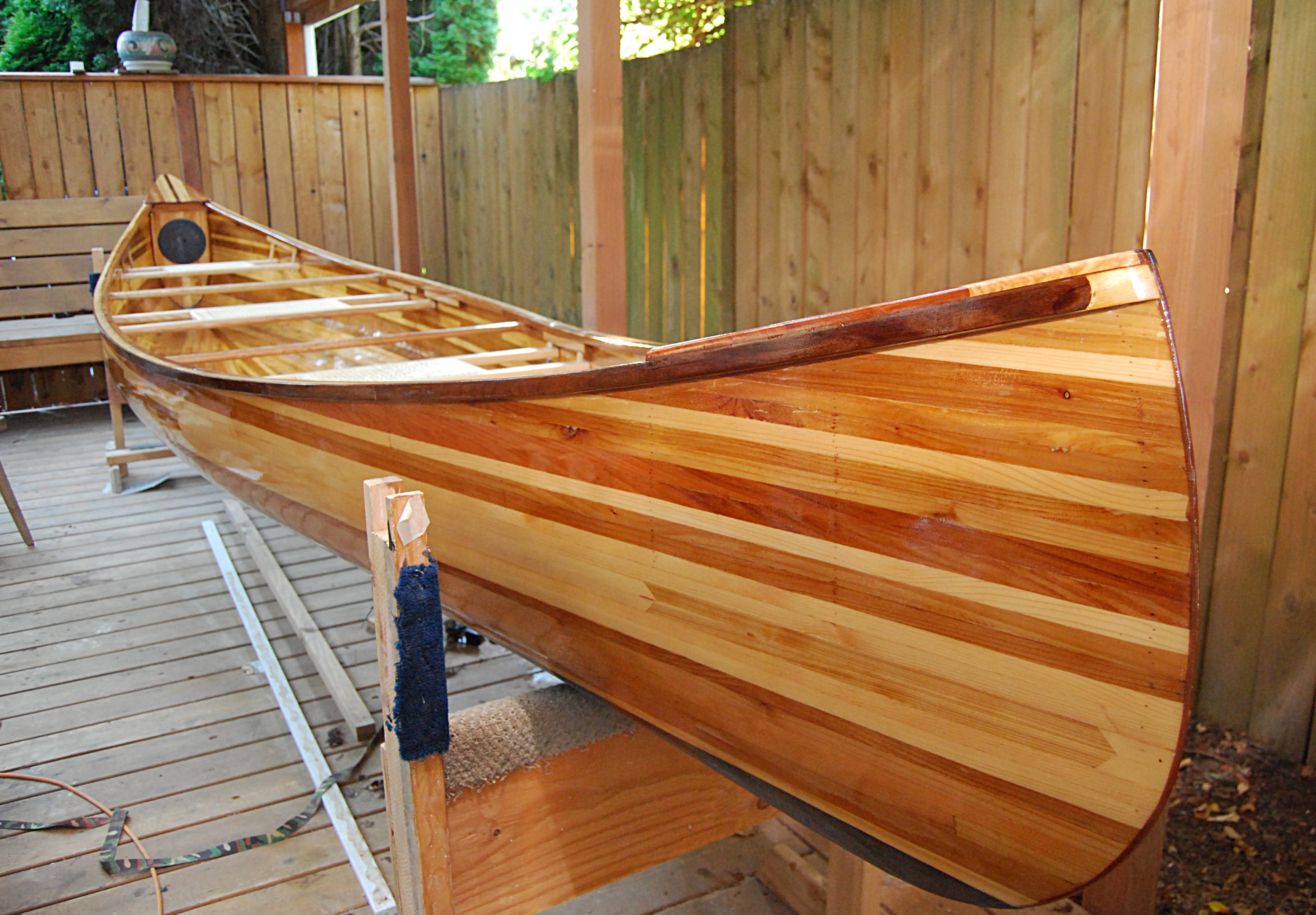

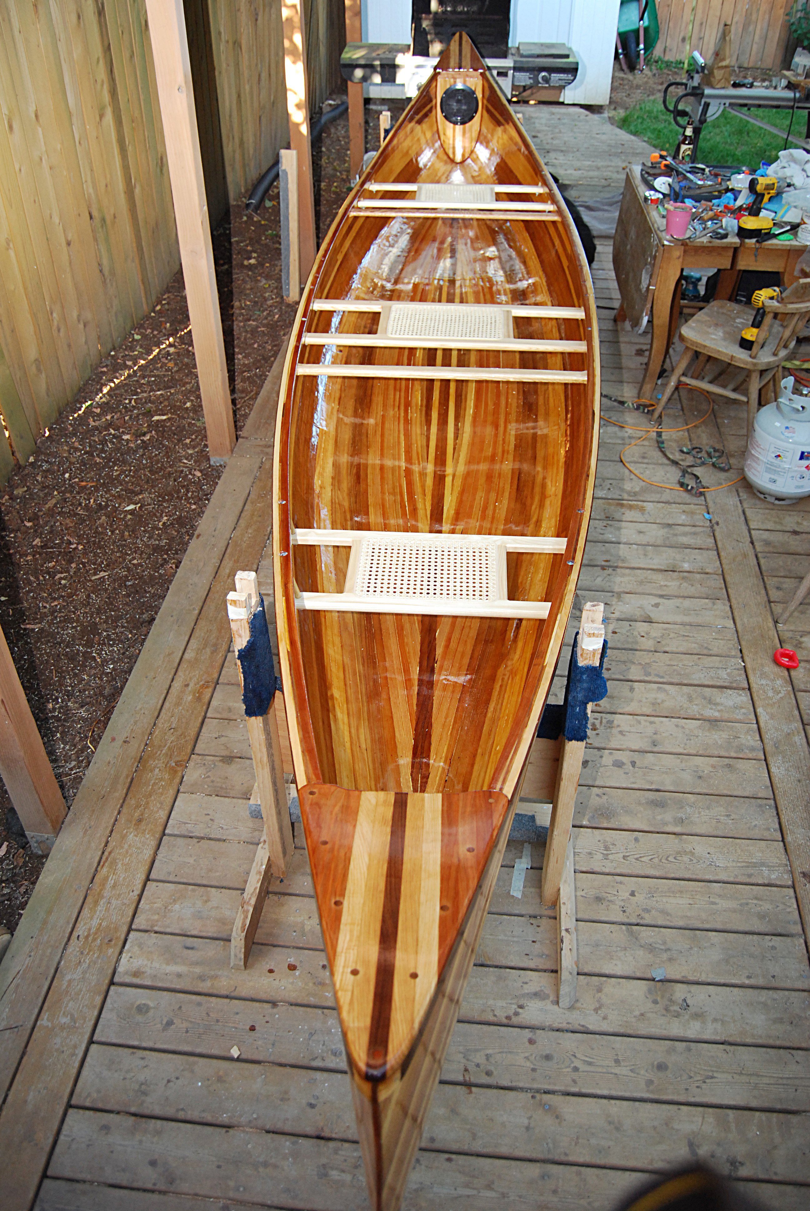

Then, this spring I finally got around to fiberglassing the inside and ordering seats.  Earlier this summer, I added the inwales and fit the seats. A couple weeks ago I made the decks out of cherry, ash, and black walnut and made the thwarts.  I finally got around to varnishing it this past weekend, with a new coat everyday this week.  Tonight, I installed everything. After all is said and done, here she is:
the angle I took this first one at makes it look weird and lopsided.
