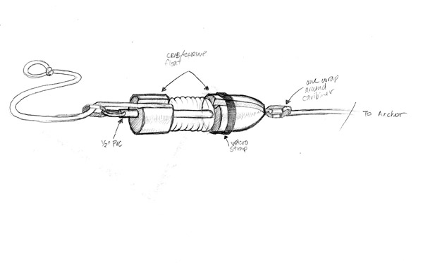

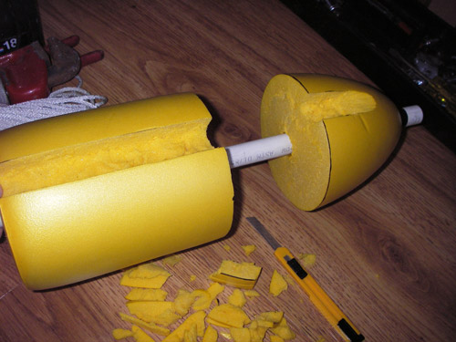

With Dino season warming up I decided to make a new quick release anchor float. The last one I had was done very impromptu so this time I wanted to build it for real. Thought about ideas to make a compact system for a day or two and came up w/ this sketch:
It's essentially a shrimp float skewered on a piece of 1/2" pvc pipe w/ a few carabiners and rope. This way the float and the spool would all be one unit.. one less thing to forget. But I digress. :D

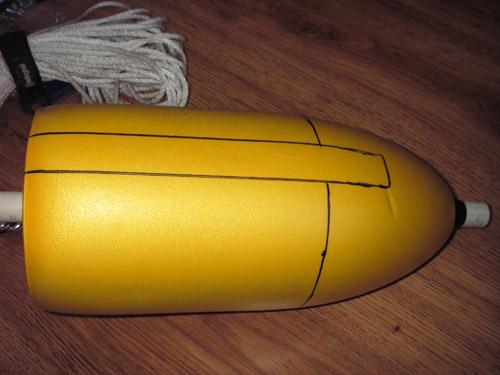

I first drew out where to make the incisions. I decided to split the float in half towards the front so that it would most likely float vertically. That way it'd be as visible as possible when it came time to retrieve it and less of a hazard for boaters.
Then the channel where the rope would lie.

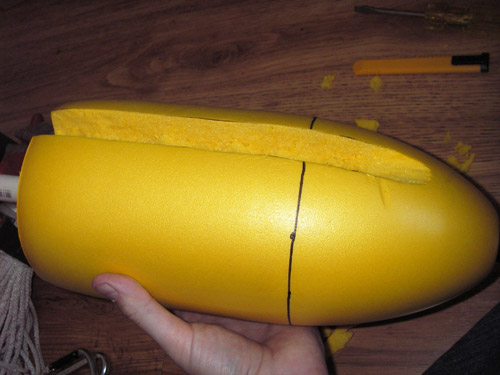

Split the bugger in half.

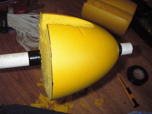

The way I fastened the float to the pvc is by bulking up the pipe w/ electrical tape and wedging the float over it. Then securing it by doing the same on the other end. I guess you could pour a glue like epoxy or something in the gap but the float doesn't take too much pressure so thought I'd keep it simple.
Wrapped the anchor rope the gauge the distance between the two float pieces and marked it on the pipe w/ a marker. Secured the rear float piece to the pipe and drilled the holes for the carabiners on the front and back of the pvc as well as in the middle where the anchor line would be attached to the whole rig.

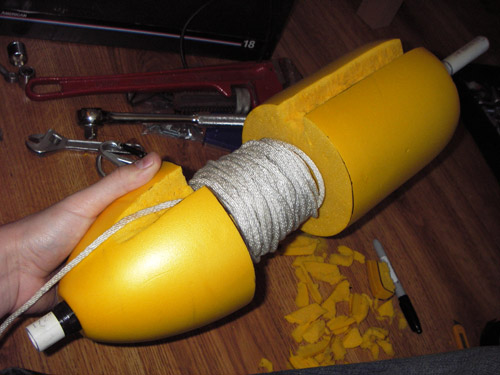

I secured the line that went to the yak to the pvc and attached and wrapped the anchor line over it. I put a perfection loop on the rope that goes to the yak and threaded the anchor line through the carabiner up front. I decided to put the velcro wrap on the coiled rope instead of the float like in the sketch. It's a lot more sound there and less likely to be pulled off.
There you go! Anchor release, float, spool, thingy! :thumbsup:
Total cost: $12 :headbang:

Looking good!!!  Thanks for the idea.  I got a few tricks in my head I may try out as well.
Cool Z.  How much line does it hold?
Thanks. I have 100' on it now so I guess around 150' fully loaded. Then again I wouldn't really suggest anchoring in anything deeper that 40-60 feet. Add the angle of the line and that puts you around 80-85 feet so more than enough.
