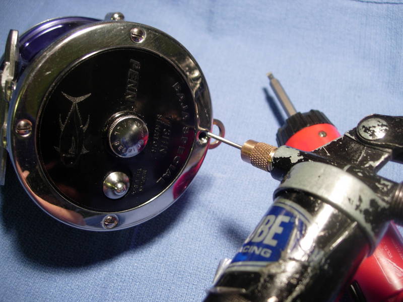

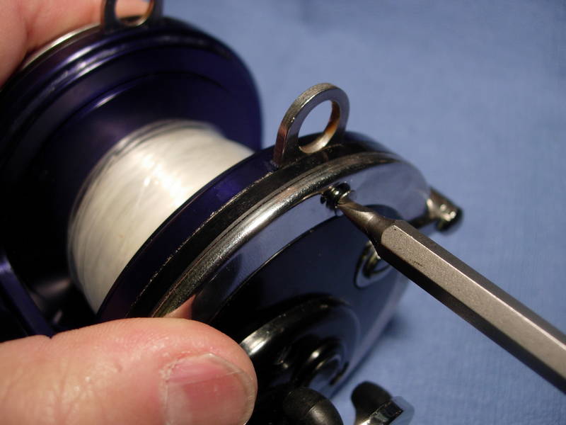

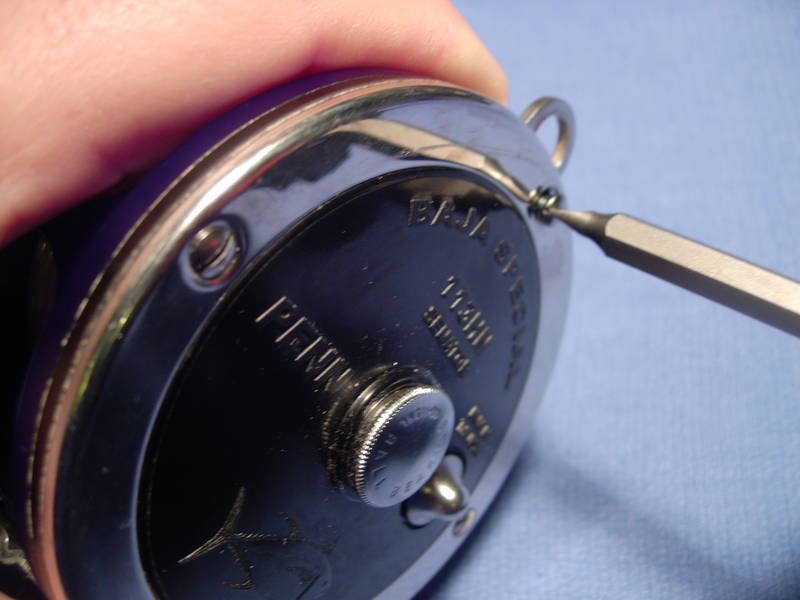

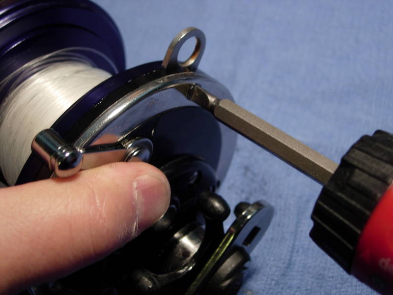

first, let's back out each left side plate screw (key #38), one at a time, and add a bead of grease.

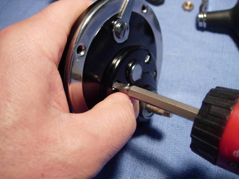

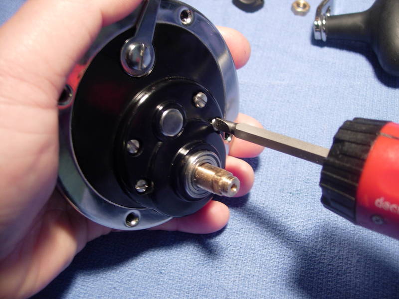

now for the right side plate.  remove all four right side plate screws (key #39).

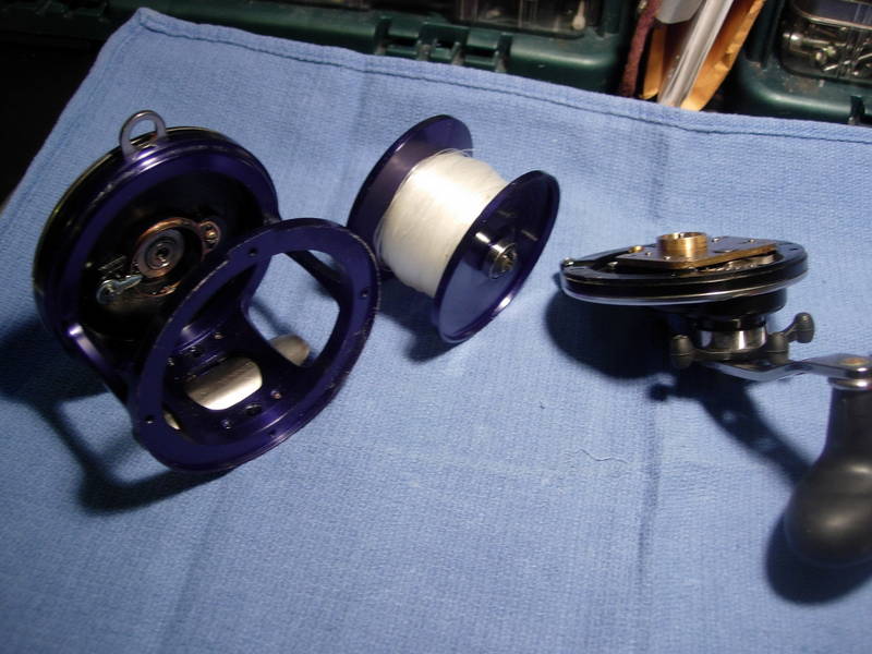

the reel separates cleanly into three pieces, a frame assembly, a spool assembly and a right side plate assembly.

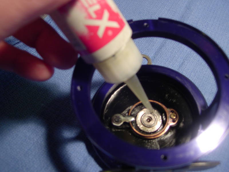

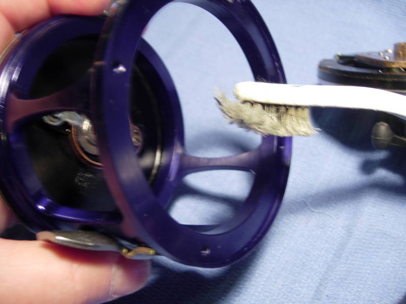

you never thought this ratty old toothbrush would last so long, did you!  clean up the inside of the frame assembly, leaving a light coat of grease on all the non-exposed metal surfaces.
this reel already had great freespool.  we'll just add a drop of corrosion x anyway.

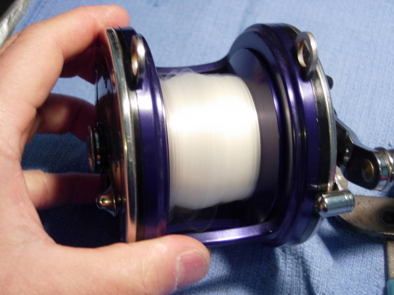

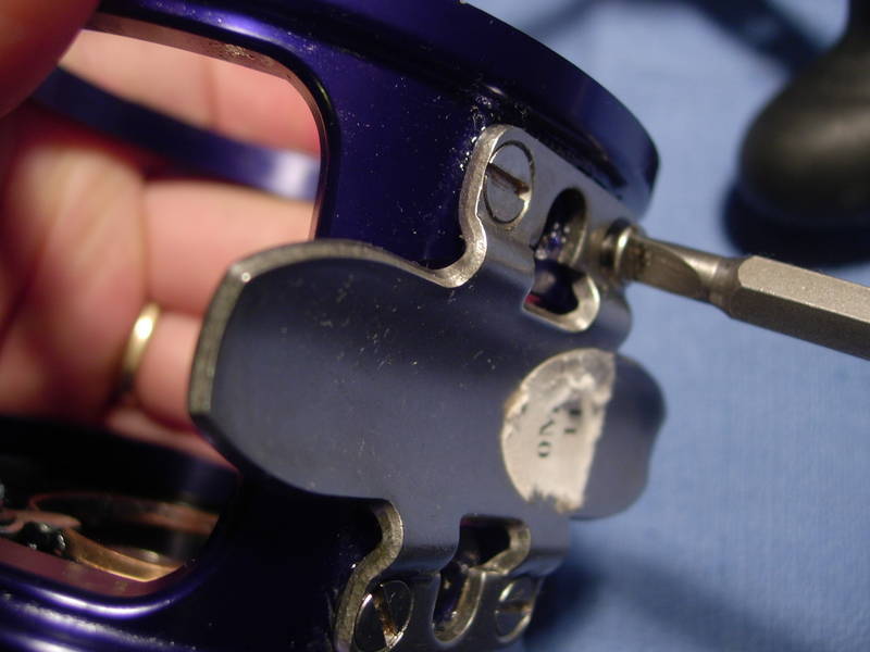

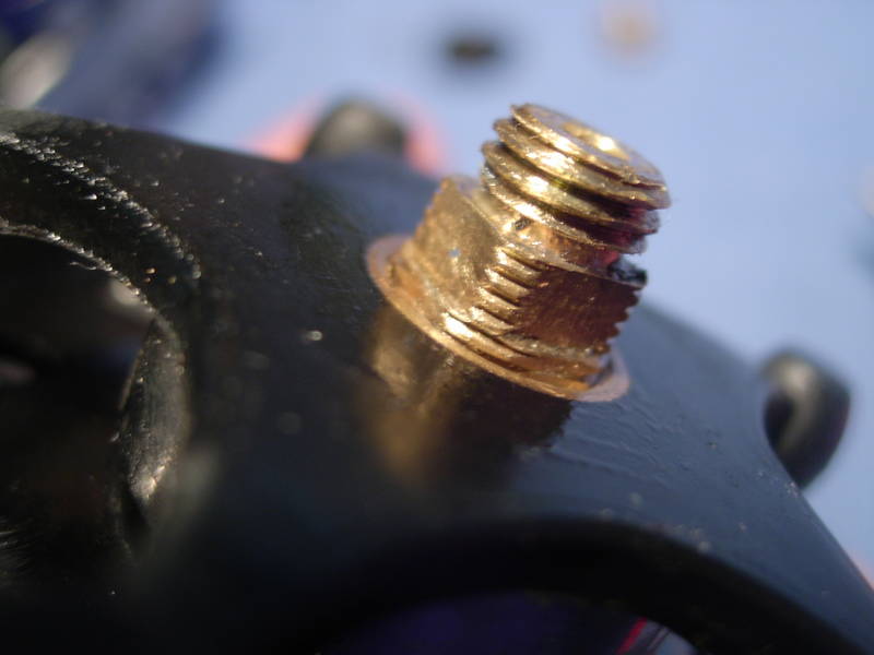

back out each stand screw (key #101) one at a time and add a small bead of grease.  per our previous discussions, i make this recommendation because i believe in principle that corrosion anywhere in a reel is bad.  to avoid corrosion, these screws are greased, but you have now created a situation where they can back out.  this means you have to check these screws on a regular basis.

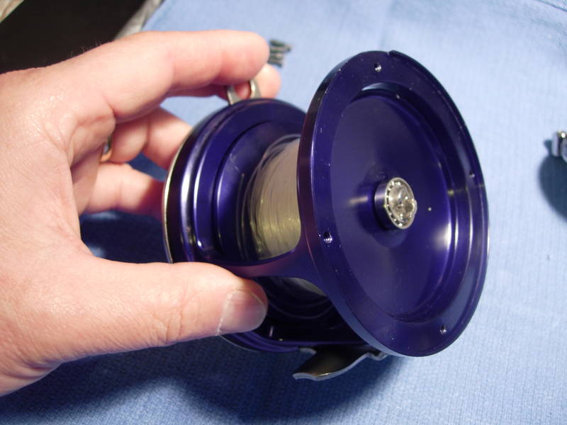

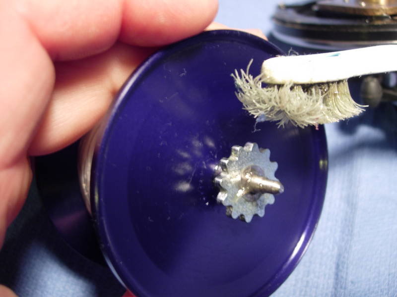

brush a little grease on each side of the spool.

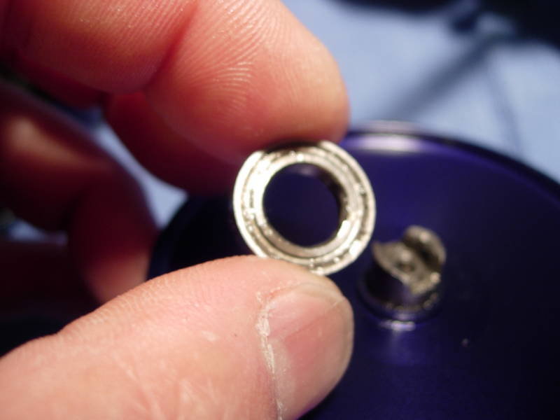

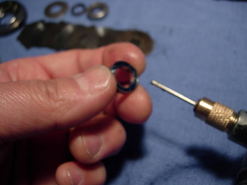

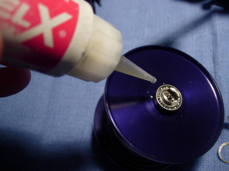

remove the right spool bearing (key #55a).

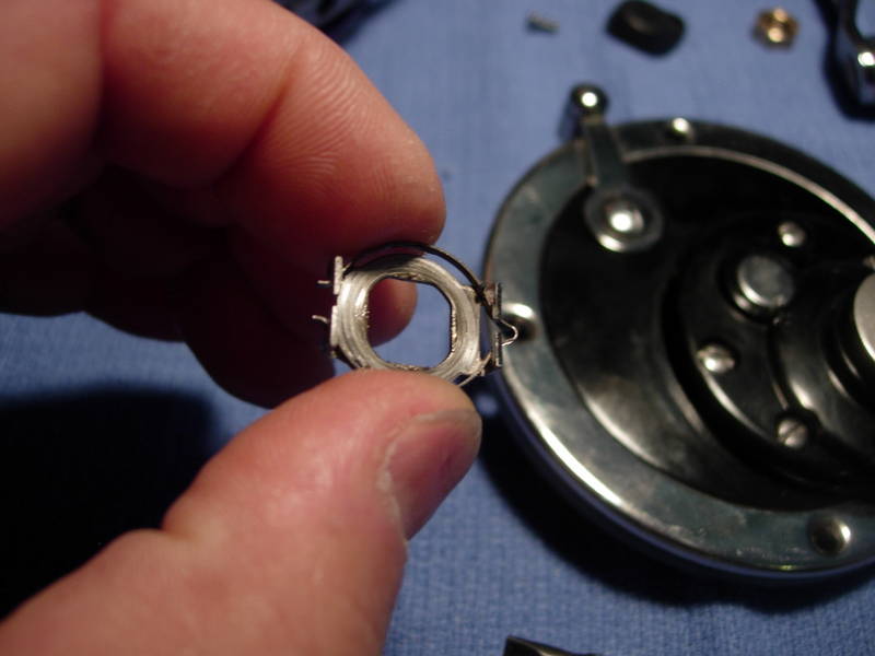

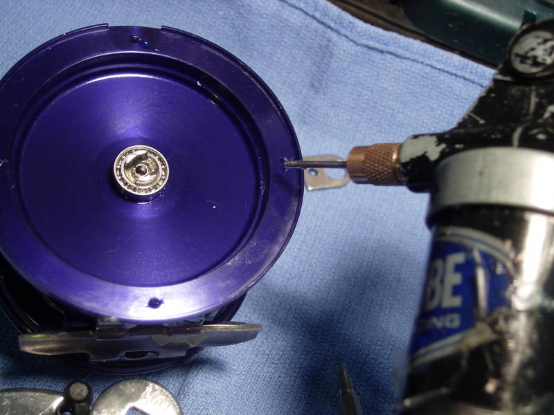

pull the shields, clean out the grease, relube it with corrosion x and install it open back onto the spool shaft.
install the spool assembly back into the frame.

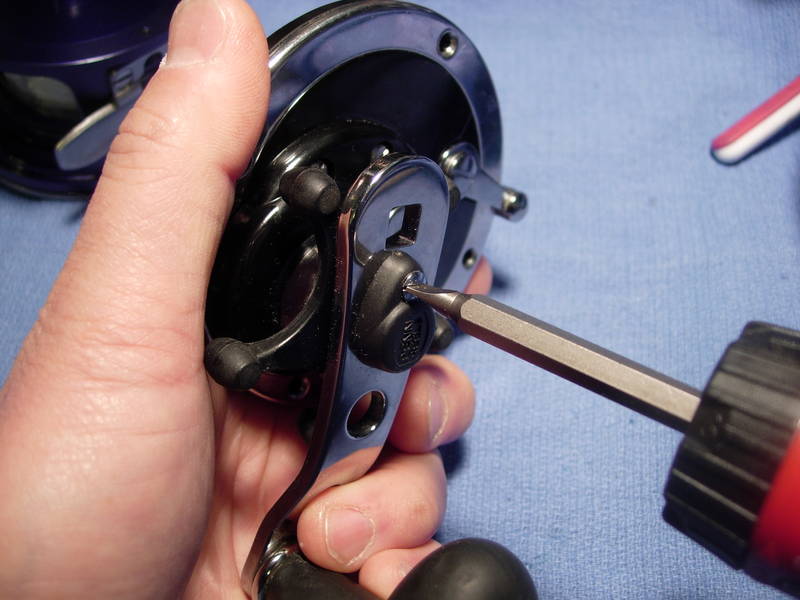

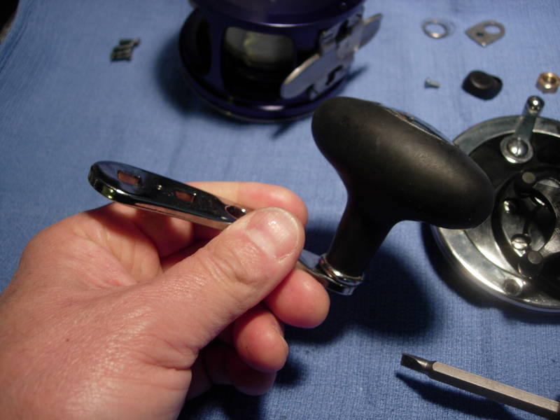

for routine maintenance, this is all you are looking at.  that is, of course, once we finish the right side plate.  let's start on the right side plate by removing the handle lock screw (key #23a).

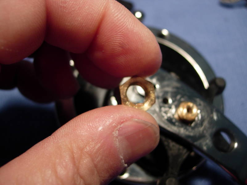

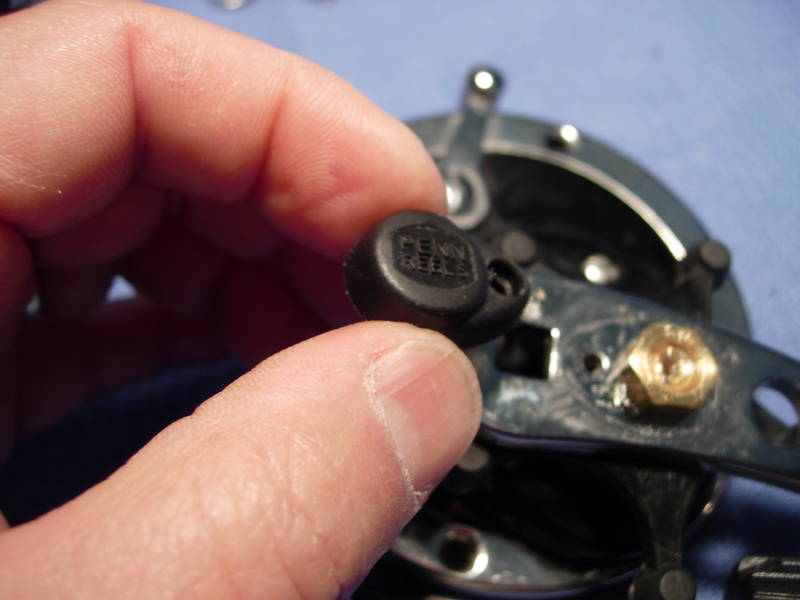

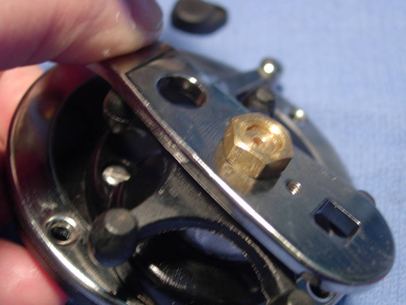

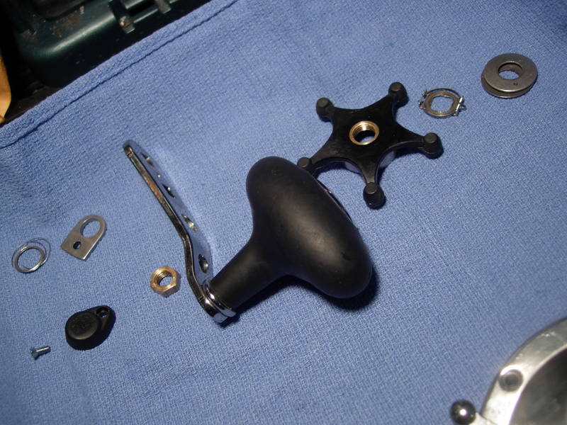

remove the handle nut cap (key #110).
remove the handle nut (key #23).
remove the handle (key #24).

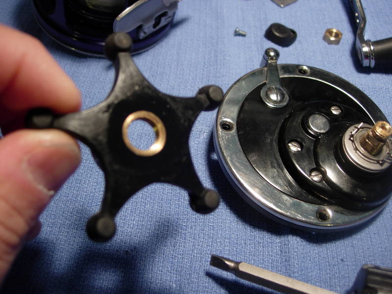

remove the star drag wheel (key #10).  these graphite stars can break.  an all metal replacement is available through penn or pennparts.com.
remove the click washer assembly (key #'s 8a and 8b).

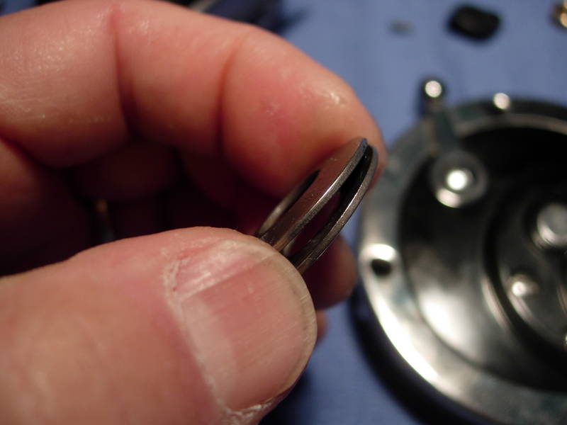

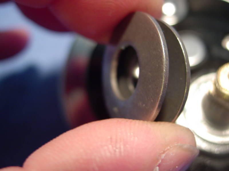

remove the stainless steel belleville tension washers (key #8) and note that they are cupped oppositely.

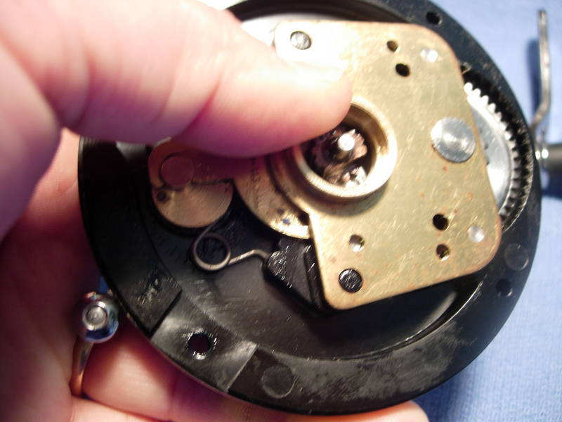

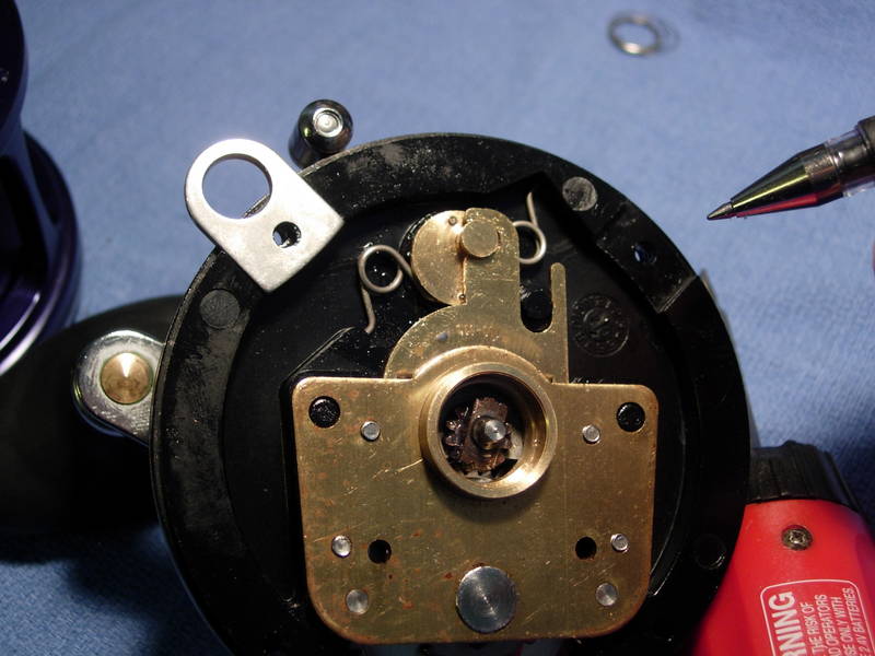

our 113hn is a later model with a bearing underneath the tension washers.  back out the four bridge screws (key #16), leaving them in place.

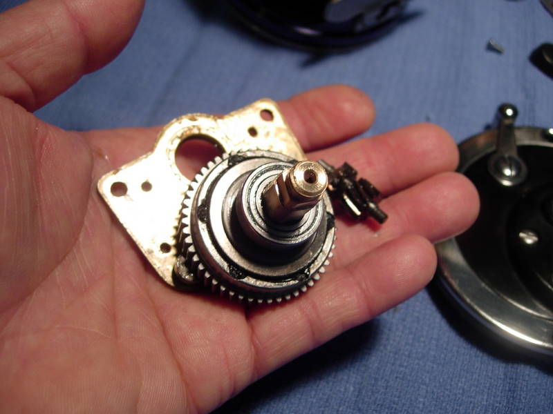

the bridge and main gear assembly drop straight down.

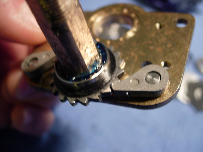

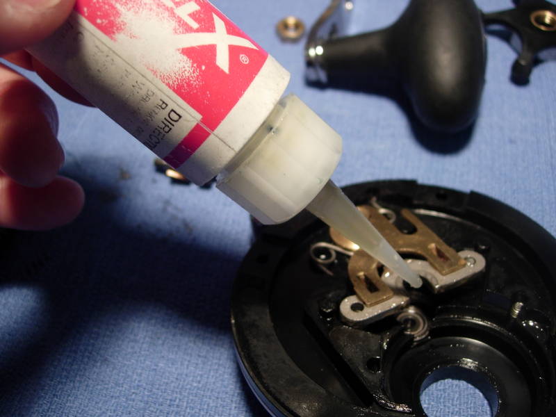

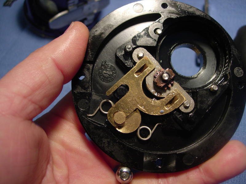

take a moment now to lube the right side plate bearing (key #26).  note also the double thick stainless steel pinion yoke (key #12).  a most excellent feature.

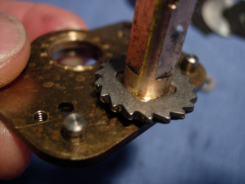

if it fell out, as in the previous photo, replace the pinion gear (key #13) and sub shaft (key #13a) and set the right side plate assembly aside.

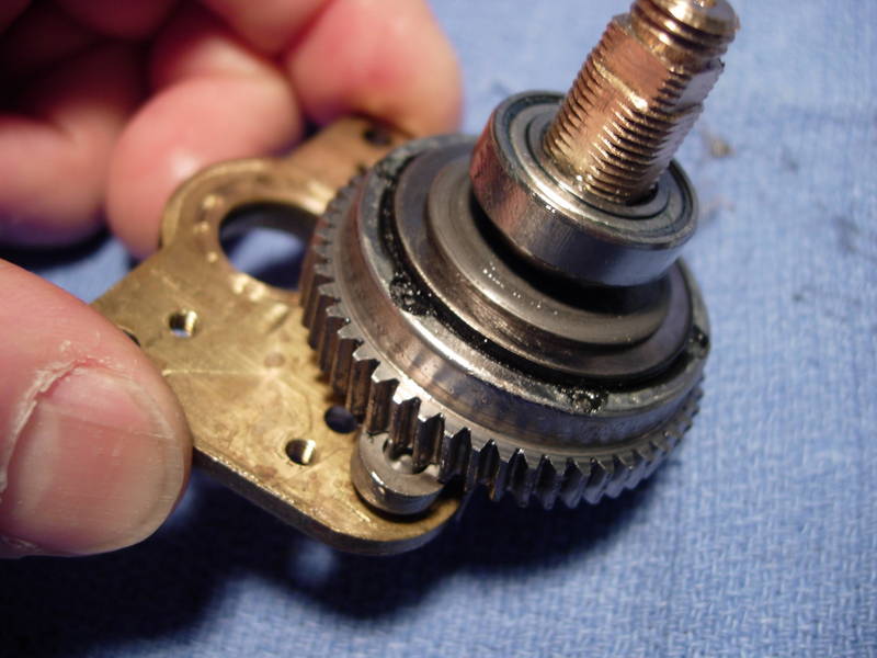

now we will service the bridge and main gear assembly.  a hardened stainless steel main gear (key #5) is a very nice upgrade from the bronze alloy main gear of the standard penn 113h.

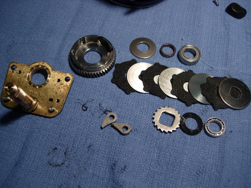

let's pull everything apart, in order, and line everything up.

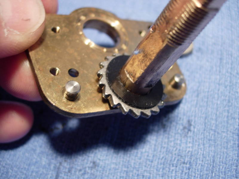

install the anti-reverse ratchet (key #98r).  make sure the teeth are pointed in the right direction.
install the fiber washer (key #4).  in most penn reels, i would substitute a drag washer in this spot.  i decided not to because there was so little room.

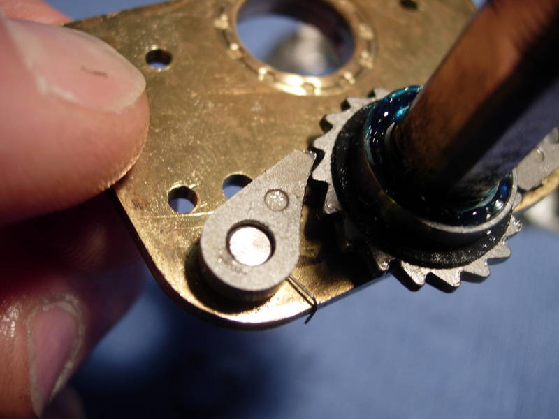

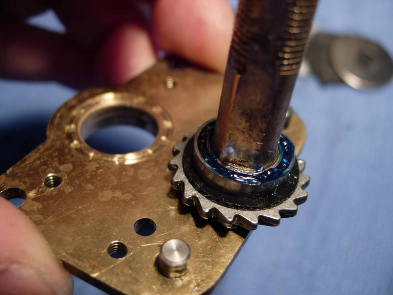

grease and install the main gear bearing (key #5a).  i used yamaha engine grease.  thinking about it now, i should have used cal's drag grease.  it should not make a difference, but it would probably be better not to use the two greases so close to each other.

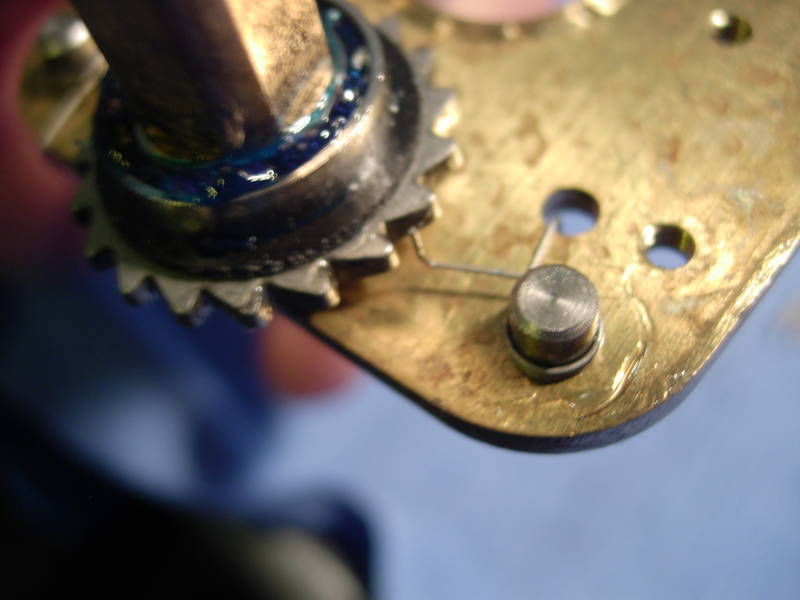

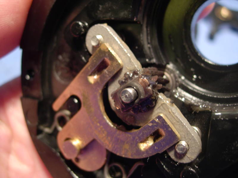

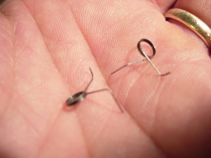

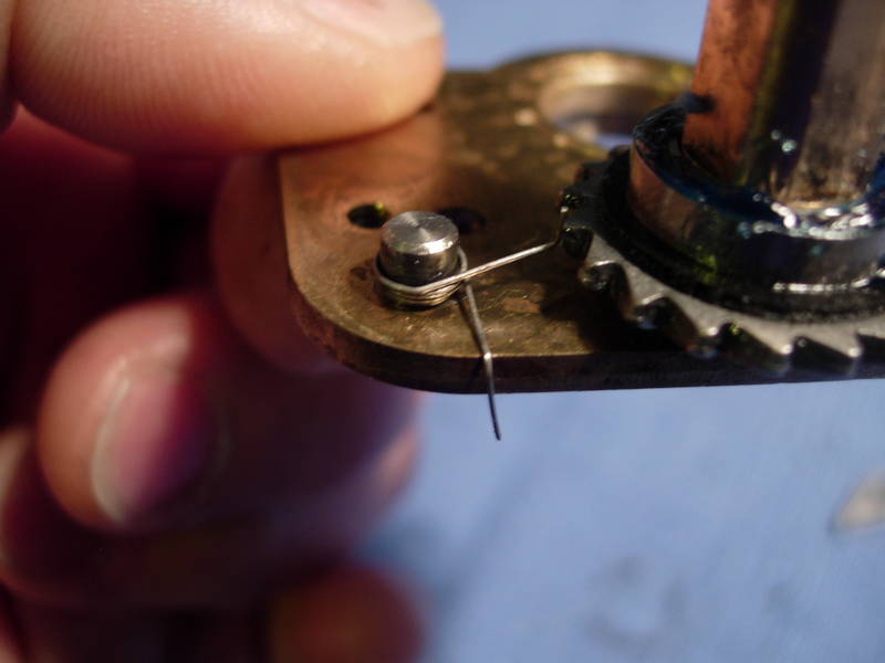

now for the dog springs (key #14).
the easiest way to remember is that the long end is pointed down.
slide the dogs (key #15) into position.

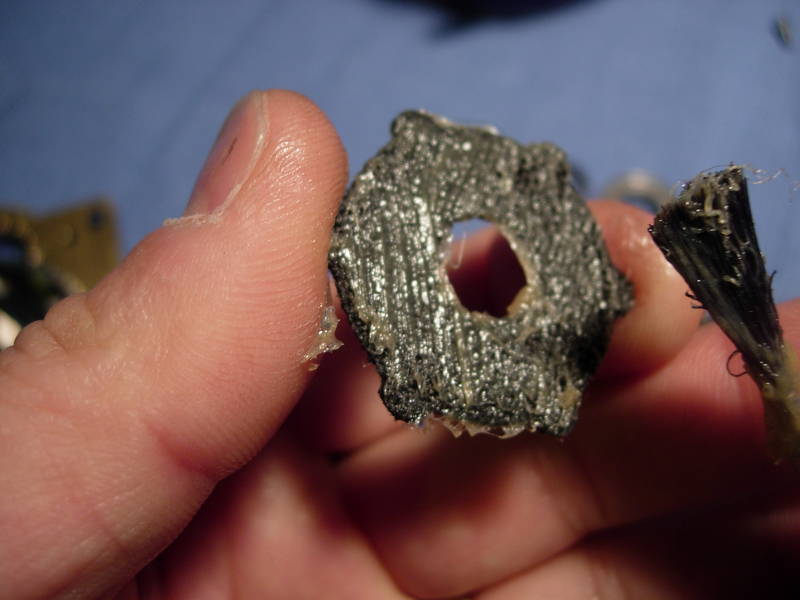

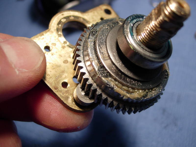

apply a generous coat of cal's drag grease (or shimano's) to the drag washers (key #7L).  don't worry about the excess.  under extreme pressure of the star, all of the excess will be squeezed out.
reassemble the drag stack.

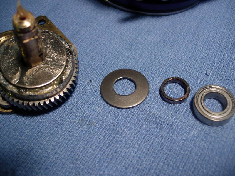

pack the gear sleeve bearing (key #55b) with yamaha engine grease and install the belleville tension washer (key #8), the spacing sleeve (key #9) and the bearing (key #55b).

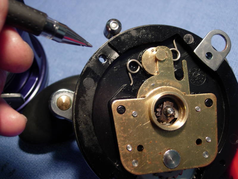

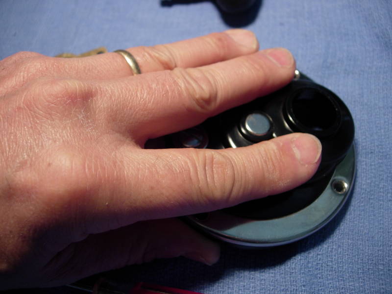

now, the right side plate assembly has been quietly sitting and remains in one piece, right?  place your left index and middle finger over the bridge screws (key #16).  you've done this plenty of times before with the jigmaster and the other senators so you're all experts at this.
with two fingers to hold the bridge screws in place, flip over the right side plate assembly and make sure everything is in its proper place.
just like the jigmaster and the newell, the 113hn bridge assembly drops straight into place.  there should be no dog spring "troubles" here.

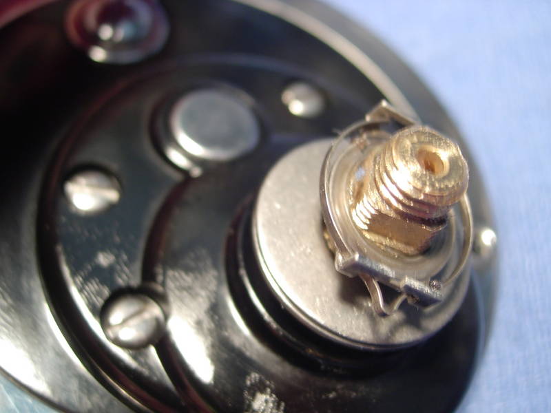

install both belleville tension spring washers (key #8), the first cupped up and the second cupped down.
install the click washer (key #8a) and spring (key #8b) assembly.

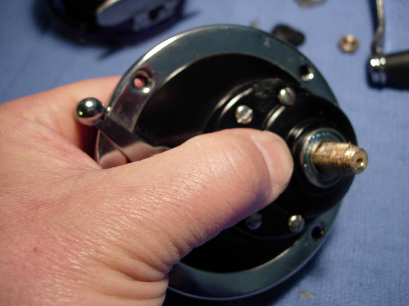

install the star drag wheel (key #10) and turn it down until it clears the shoulder of the gear sleeve (key #98) that supports the handle (key #24).

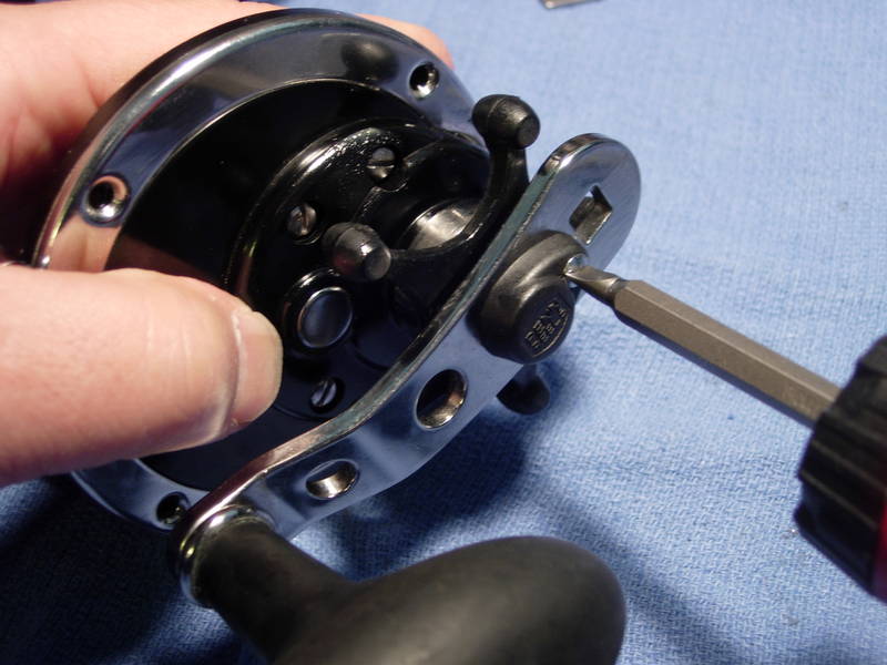

install the handle (key #24) and handle nut (key #23).

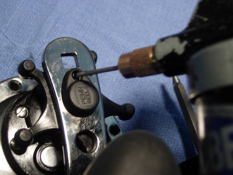

install the handle nut cap (key #110) and add a bead of grease to the screw hole.
install the handle nut cap screw (key #23a).

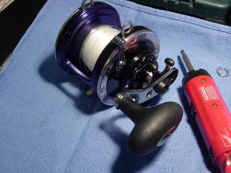

note that the side plate assembly can be installed with the handle swung forward or back.  you can also install the harness lugs (key #54) in the up position or down.  i keep forgetting to ask if these same 113hn lugs (part #54-113hn) will fit in the standard penn 113h.
pick a position for the right side plate assembly and install the four right side plate screws (key #39).

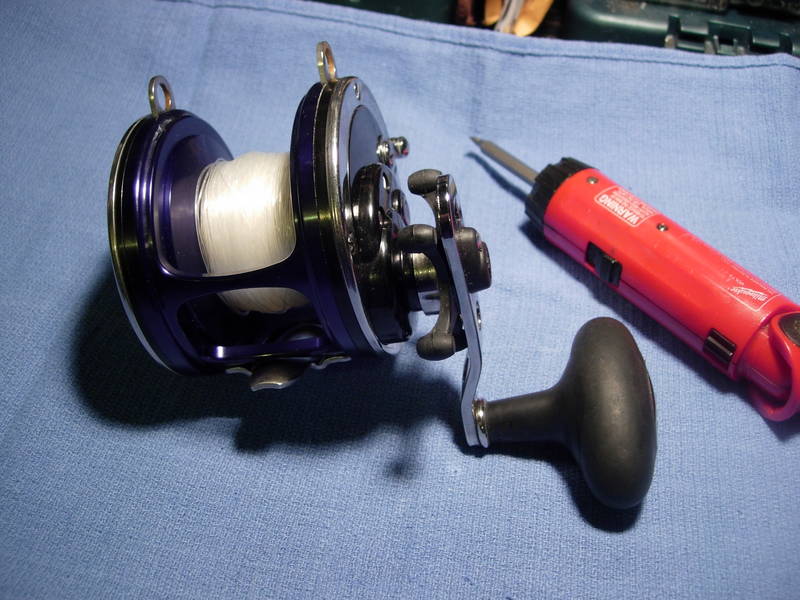

check to make sure the handle (key #24) turns freel, the eccentric lever (key #21) works an that the reel has good freespool.

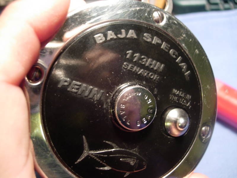

done!  note that the handle is now swung forward.  this gives easy access to the eccentric (freespool) lever.
