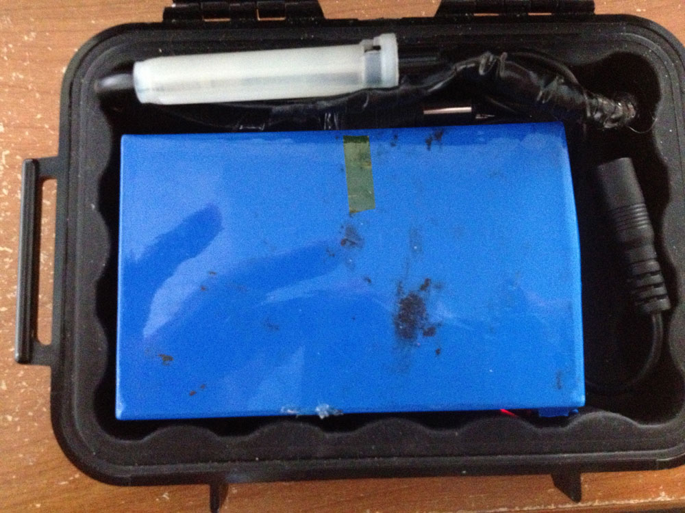

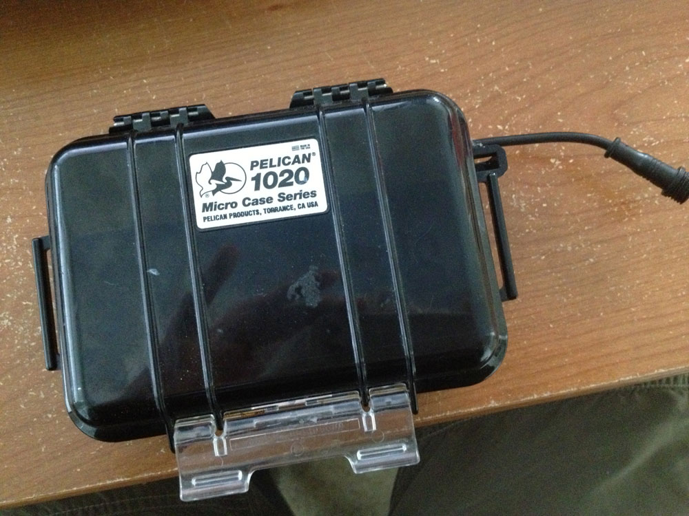

The blue brick brings me more joy than any battery has a right to.  It's definitely a kayak fishing breakthrough IMHO!
The Pelican 1020 micro case is tailor-made for the battery.  It's the perfect size.
And if you place the cables to the top and sides, the switch fits nicely in rubber inner-case grooves, preventing it from switching off.
I mounted my FF on my hatch and wanted to store the battery right under it on the inside - to reduce the amount of wires everywhere and to keep it out of the water that inevitably sloshes thru the bottom of the yak.  Tried the strong velcro and it didn't even make it thru one trip.  I ended up attaching 2 loops of shock cord to the screws in the base of the FF (on the inside).  That secures the battery to the inside of the hatch perfectly!
In regards to performance, I tested my 587ci HD.  With the screen at full brightness and the transducer plugged in it got between 10 and 11 hours.  The finder has an "hours in use" reading (but not minutes).  And I know I could get more if I dimmed the screen.  the max I ever got out of even a new SLA battery was 8 hours, and that was WITH screen dimming.
The speed charger charges a dead battery full in about 4 hours.  And the batteries and accessories are so cheap (relatively speaking), I bought two so I don't have to worry about charging if I do a 2-day trip.  The pelican cases can be a little pricey but and I had a couple of those lying around.  There are literally NO downsides!
