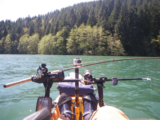

That rig looks an awful lot like mine Rory. I've not used it on the Addy yet, but it works beautifully on my X-13 and Revo. I just cut the bottom off another crate to make the lid. Lee and I made another one almost identical for him, but he offset his DR mount to keep the boom closer to the boat.

That is all I did.  I use a rod I snapped in the surf, a roller guide, and old conventional reel and some 80 lb braid.   I use the line counter on my fishing reel to get the right depth.  The line counter I mounted on the down rigger rod was useless.  It may not be pretty but it works well, and I can deploy it while peddling.
X2
Mine looks almost the same in concept.  The only differences in my set up...  I chopped a lot of the butt section on the "downrigger" to get it out of the way and I use a Magda Pro linecounter reel on the downrigger.  You can often find them on sale at Bi-mart.
30 lb power pro from an old reel + a 2lb cod jig for weight + downrigger release and I was in busness for less than $40.  Gets deep with very little blowback.
I like having the fishing rod on the opposite side of the kayak than the downrigger.  I fish fairly soft rods and they create an "arch" over the kayak.  The snap of the arched rod really drives home the hook when a fish pops the clip.
