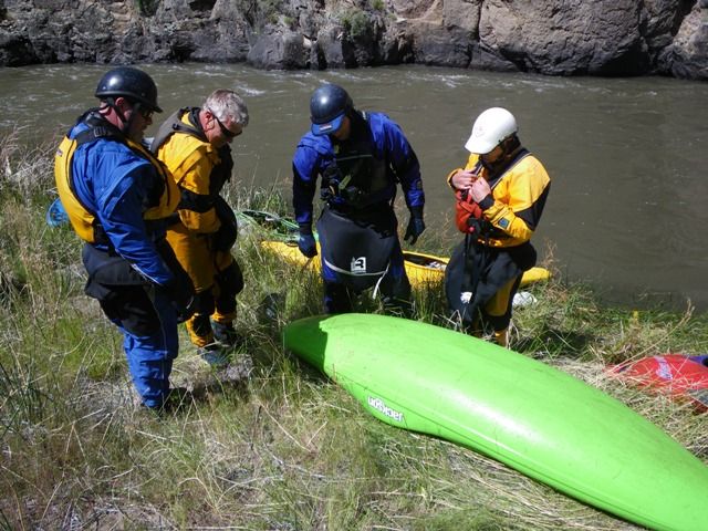

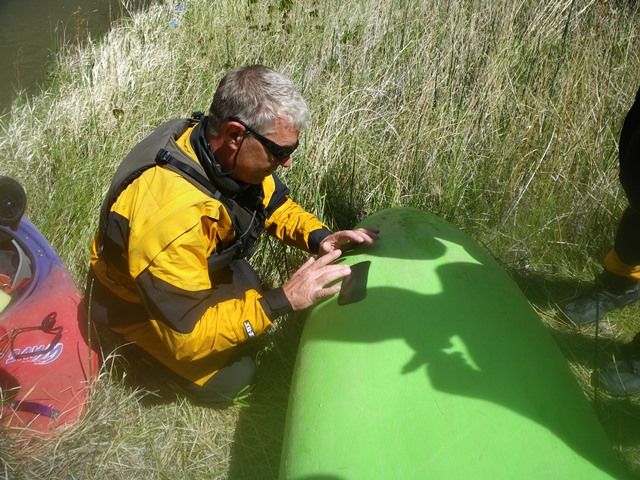

The kayak repair kit which I carry on multi-day whitewater kayak trips includes several pieces of raft repair fabric and vinyl glue, and I’ve used these materials to repair several cracked kayaks with excellent success.  Because the fabric and the glue are flexible, If you drill holes at the ends of the crack to keep the crack from getting longer, the repair holds up under considerable banging over rocks.  Here are a couple pictures of us repairing a whitewater kayak with raft repair fabric and vinyl glue.  This kayak developed a crack on a four-day unsupported kayak trip on the Jarbidge and Bruneau Rivers in Idaho.  The patch didn’t leak at all, and the owner continued to use the kayak for some pretty aggressive creek boating for a month or so after the trip until he got the kayak replaced under warranty.
Here's the patch running Wally's Wallow Rapid.
For another example, on the second day of a nine-day kayak trip on the Rio Atengo in Mexico, the borrowed kayak I was using developed a hole underneath its seat from grinding over rocks.  I had to take the seat out (a big deal with a whitewater kayak) and patch the inside of the hole with raft repair fabric.  Pictures I took on that trip are on the Sierrarios.org website at http://www.sierrarios.org/SlideshowPages/SlidesAtengo1.html , http://www.sierrarios.org/SlideshowPages/SlidesAtengo2.html , and http://www.sierrarios.org/SlideshowPages/SlidesAtengo3.html.  I think it would be fair to say that the trip was a good test of the effectiveness of raft fabric patches and vinyl glue.
« Last Edit: January 31, 2014, 06:20:33 PM by pmmpete »
