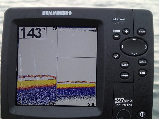

At times, I want to operate at up to 120' depth, so I didn't want to compromise on the drag/yaw objective.
With a six pound ball, you won't have any problem trolling at 120 feet deep.  Here is a picture of a couple of big lake trout following my lure which is a couple of feet above the bottom in 143 feet of water. The light line behind the fish return is my ball.
When downrigger trolling near the bottom, I want to be able to see the ball on my fish finder, so I can be sure I'm not about to run it into an underwater obstacle.  I also prefer to be able to see my ball when trolling for suspended fish in deep water, but if there isn't any chance of running my ball into the bottom, I'm willing to operate off the three-digit line meter even if I can't see my ball.
« Last Edit: February 21, 2014, 08:54:26 PM by pmmpete »

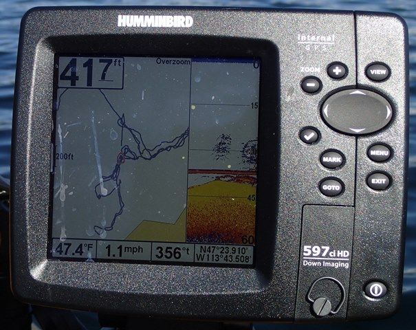

I've yet to use a depthfinder, or a downrigger for that matter.
You have to have a fish finder in order to use a downrigger.  You need the fish finder so you can run your ball and lure through schools of suspended fish, so you can work underwater structure with your ball and lure, and so you can avoid running your ball into underwater obstructions and possibly snagging your ball on the bottom.
Here's a picture of my fish finder screen which I took while downrigger trolling last summer.  The left side of the screen shows my GPS track as I was trolling along the side of a bench.  The red boat icon shows where I was.  The loop off to the left of the bench is where I caught a lake trout, floated downwind while playing it in, and then returned to the side of the bench.  The right side of the screen is the sonar.  It shows lake trout near the bottom in 41 feet of water, under a school of small fish.  My downrigger ball is the thick orange horizontal line.
