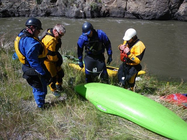

I was suggesting that you use Goop between the patch and the hull to act as a gasket to keep the patch water-tight.  You are right that it's hard to find a glue which will adhere well to the various plastics which kayak hulls are made of.  A glue which does adhere well to kayak hulls is vinyl glue.  My repair kit for multi-day kayak trips includes pieces of raft repair fabric and vinyl glue, which can be used to seal cracks in kayaks.  I've used these materials to successfully repair kayaks on a number of occasions.  Here we are repairing a cracked kayak on a four-day kayak trip on the Jarbidge and Bruneau Rivers in south central Idaho.

I don't know how long a raft repair fabric patch will last, because once a kayak develops a crack, you generally quit using it pretty soon.  But such patches hold up well because the raft repair fabric is strong and flexible and doesn't tear or crack when the patch gets slammed into or dragged over rocks.  I put patches on both the inside and the outside of the kayak in case something happens to the patch on the outside of the kayak, and I cover the patch on the outside of the kayak with duct tape to protect it from getting ripped off by jagged rocks.  It's a good idea to drill a small hole at each end of the crack to prevent the crack from continuing to lengthen.  Percussionists use this technique to keep cracks in cymbals from lengthening.
The guy whose kayak cracked on the Jarbidge-Bruneau trip continued to use the kayak for a couple of months in some fairly brutal creek runs until the manufacturer replaced the kayak under warranty.  Another example of how well these patches work is that early on a 9-day Class IV-V trip on the Rio Atengo in Mexico, the kayak I had borrowed developed holes under the seat from abrasion.  I patched the holes with raft repair fabric and used the kayak for the rest of the trip (it was that or hike out), and for a subsequent three day trip on the Rio San Nicolas.  Pictures from the Rio Atengo trip, the upper half of which was a first descent, and the lower half of which was a second descent, are posted at http://www.sierrarios.org/PagesGeneral/SlideshowLinks.html, Sierra Madre Occidental, Atengo 1, 2, and 3.  I took most of the pictures in those slide shows.

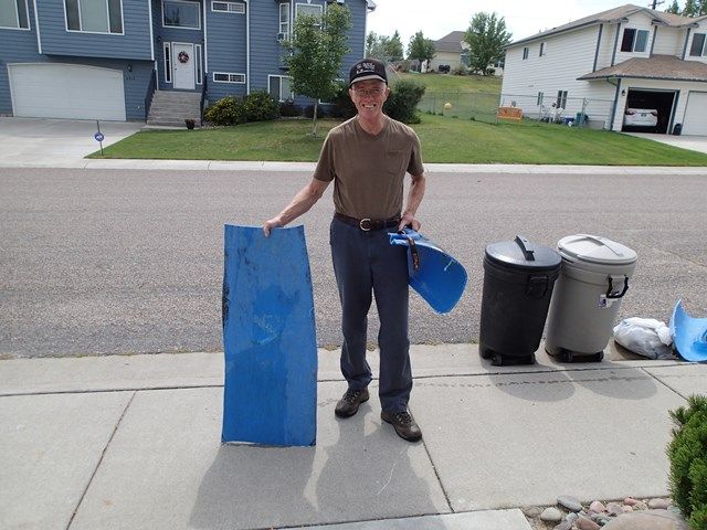

Sorry, I don't have any.  If a kayak cracks or wears through, we saw it up and throw it away.  Here is friend throwing away a kayak which developed an abrasion hole and crack this summer on our four-day Selway kayak fishing trip.
The blue plastic in the picture would have been perfect.

PNW, this is your lucky day.  I e-mailed my friend and asked if he kept any of the plastic from his kayak.  I figured he would respond "Sorry."  But he replied "I have a ton of blue plastic.  I could drop a chunk off at your house if you like. I have a small piece hanging with my tools, big chunks in the attic."  So, what size and thickness of pieces of blue kayak plastic would you like?  Personal Message me with your address, and I'll ship it to you.

Two pieces of kayak plastic, six inches on the short side and more on the long side, are heading your way by U.S. mail, and should arrive on Monday.  The color matches your kayak pretty well.  Post pictures of how your welding job comes out.
