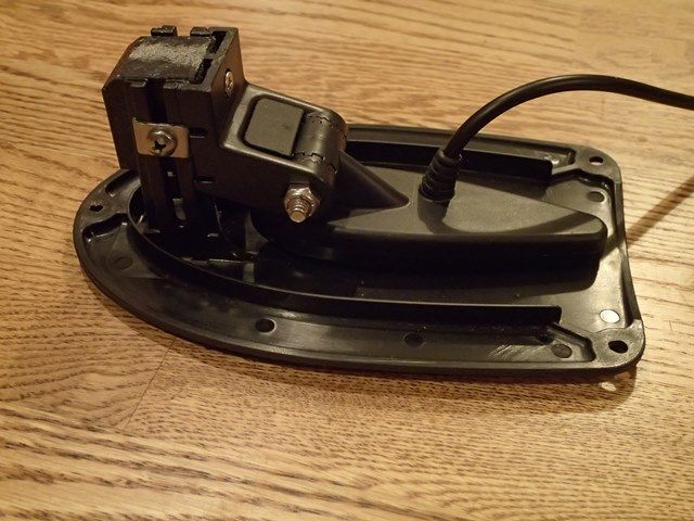

The Hobies come with a Lowrance transducer bracket for the transducer pocket, but for a couple bucks you can buy transducer brackets for other brands of fish finder.  When I mounted my Humminbird transducer in the pocket on my Revolution, I was in a hurry, and I cobbled together the bracket shown below.  But it would be way easier to buy the Hobie bracket for a Humminbird transducer.
I have been real happy with the performance of my fish finder with the transducer in the transducer pocket.  The only issue I worry about is getting sand or mud in the pocket, piled up on top of the pocket cover, which could impair the performance of the fish finder.  It's a good idea to hose out the transducer pocket periodically.
