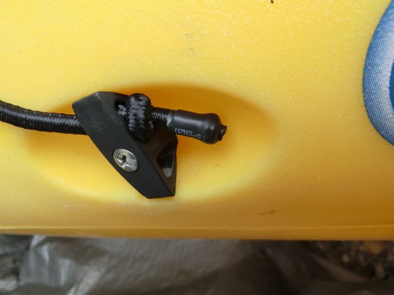

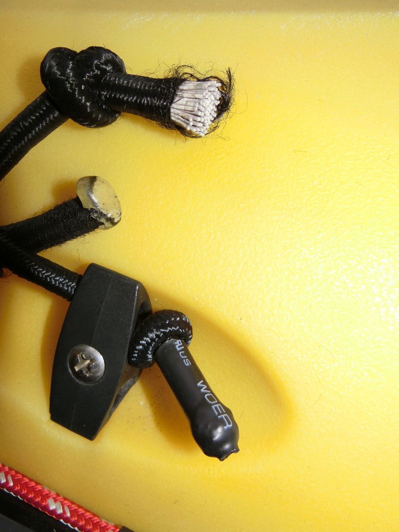

Was going through and replacing most of the bungee cords on a used Prowler 15 I bought a couple of years ago.  Several of the cut ends at one time had something like Marine Goop dabbed on the ends while other looked like they tried to melt the ends.  A few ends just had knots tied to keep them from unraveling.     I decided to use some Marine Heat Shrink Tubing to clean up the ends in a fashion much like shoe laces.   The inside of this type of heat shrink has an adhesive coating inside that melts when heated up then hardens when it cools down.  While this is designed to seal electrical splices,  this adhesive also really grips the bungee cord and I don't see it coming off any time soon.
Sorry if this is an already well known trick but I searched and did not find anything.

Where'd you find that heat shrink at?  I usually just melt mine.  Now you need to take some acetone and wipe off the white lettering and make it look even more professional.
