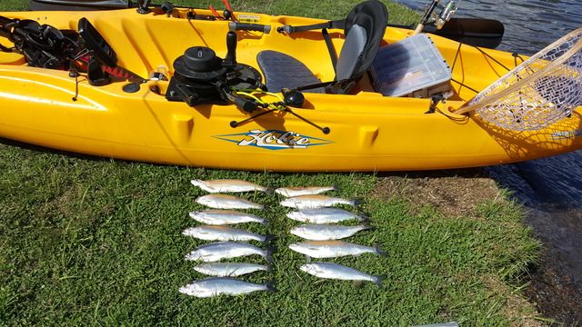

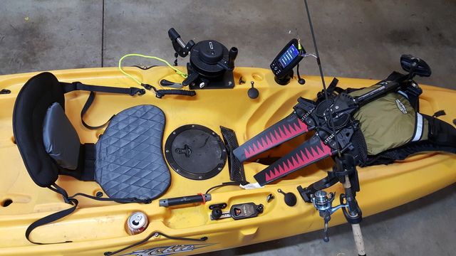

Another vote for a shortened Scotty Depthmaster mounted on a piece of Starboard that attaches to Yakattack rails. I used the same basic setup that AlexB has, I just rotated mine to keep the line tighter in to the boat. Works like a champ, after using it, I can't imagine that it could be any easier to operate.

NICE JOB!  What body of water were you fishing, those look like some healthy sized kokanee.  How deep were you trolling?
Looking good! How did you shorten the depthmaster?

Odell lake on 4/9/16, depth varied 20-60 feet no real pattern, slow bite on the troll so the majority of them were caught jigging. They are good size for the most part, I released a few that were next years fish @ 8" or so, most were in the 12-14" range.
I shortened it by cutting down the boom tube and rotating the guide eye up, reversing the brake handle which required some modification of the stop. All in all not bad, pretty easy mod, and with braided downrigger line I have no wear or other issues with the increased line angle on the guide eye.
You could avoid having to reverse the brake handle by mounting the Depthmaster on the right side of your kayak.  But which side of your kayak you will want to mount your downrigger on will depend on where you mount your rod holder, the kind of reel you use, whether the reel is right or left hand crank, and the kind of rod holder you use.  The rod holder should hold your reel firmly with the reel handle facing you, so you can reel in fishing line at the same time that you are cranking up your downrigger weight.
