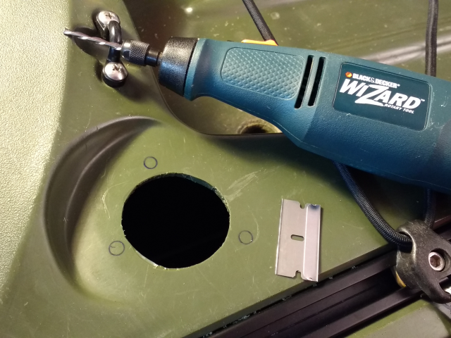

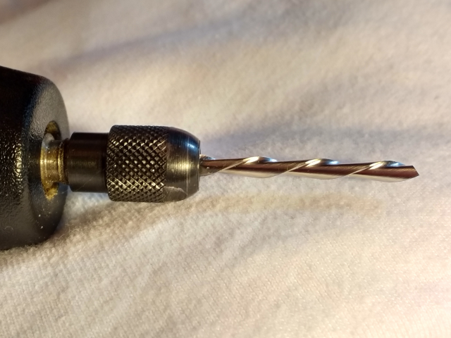

This is what I landed on, and it worked great. I got a Dremel brand multi-purpose cutting bit (similar to the link above). I used that with my hobby-sized rotary tool (B&W Wizard).
It was a little hard to control, but if you practice for a few seconds and use two hands it's not that bad. I was happy with the results:
  • My rotary tool is multi-speed so I experimented. I actually found I got better results at higher RPMs.
  • The bit I bought seemed to "chip off" hair-sized pieces and so I had no issues with melting at any speed, because the kayak material was never in contact with the bit for more than a split second. I have had issues with kayak plastic (and plexiglass, etc.) melting using cut-off wheels and similar, but this was different. So I think it has to do with the type of bit/wheel/etc. more than the RPMs.
  • I could see that a Rotozip or similar tool would be useful for this type of thing but the Dremel-type rotary tool cut through the plastic like butter, so you don't really need any more power.
  • The bit seemed to cut better in one direction than the other, which makes sense if you look at it, but required that I change my hand position and lighting several times, which was inconvenient.

Glad to hear it worked well.  I used the same bit but kept getting melted plastic boogers ahead of the bit... must have been cheaper plastic.
Looks good!
