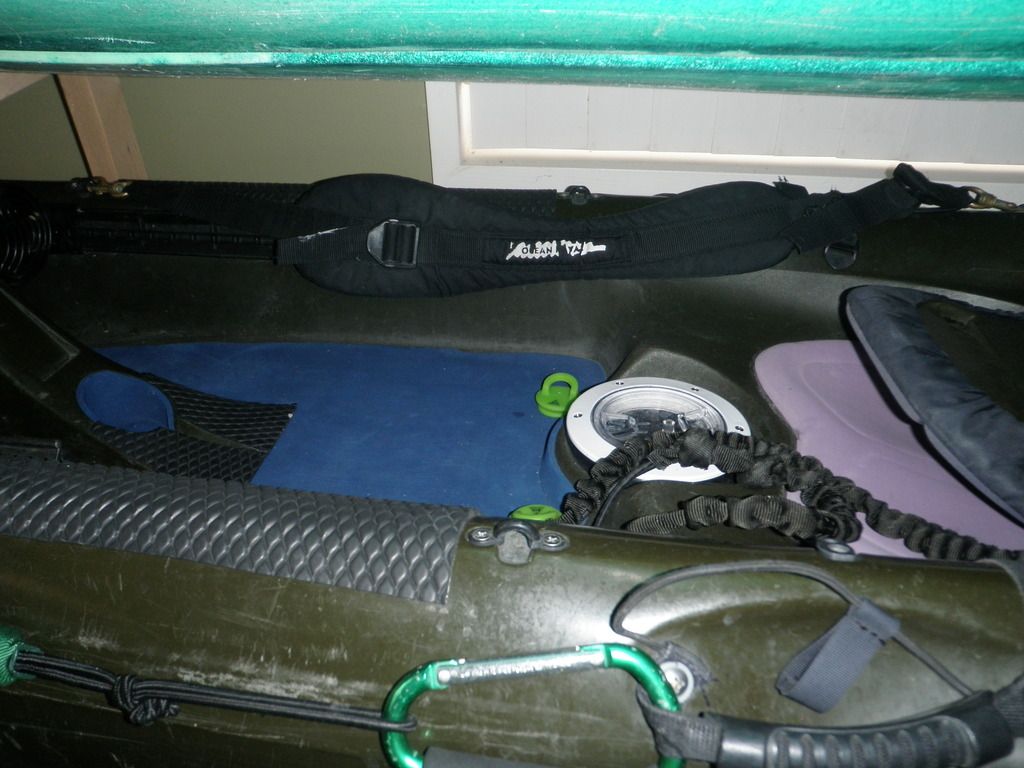

Like so I'm assuming...

They look like they would really provide some lift when need as well as mate you to the yak and still let you use the rudder with a little practice.  Pretty easy to fabricate and I'll be thinking of a little Velcro so I could pull them tight to the bottom of the seat and out of the way while still having access when needed.
Appreciate the tips from all and can see this being pretty helpful even in Puget Sound.
The thigh straps in Trident 13's photo are mounted just right.  I once mounted a pair of thigh straps with the padeyes too far forward and back, so the thigh straps were pretty straight, rather than curving around your upper and lower legs a bit as shown in Trident 13's photo, and the thigh straps tended to stretch and didn't provide as solid a control as they would have if mounted as shown in Trident 13s photo.

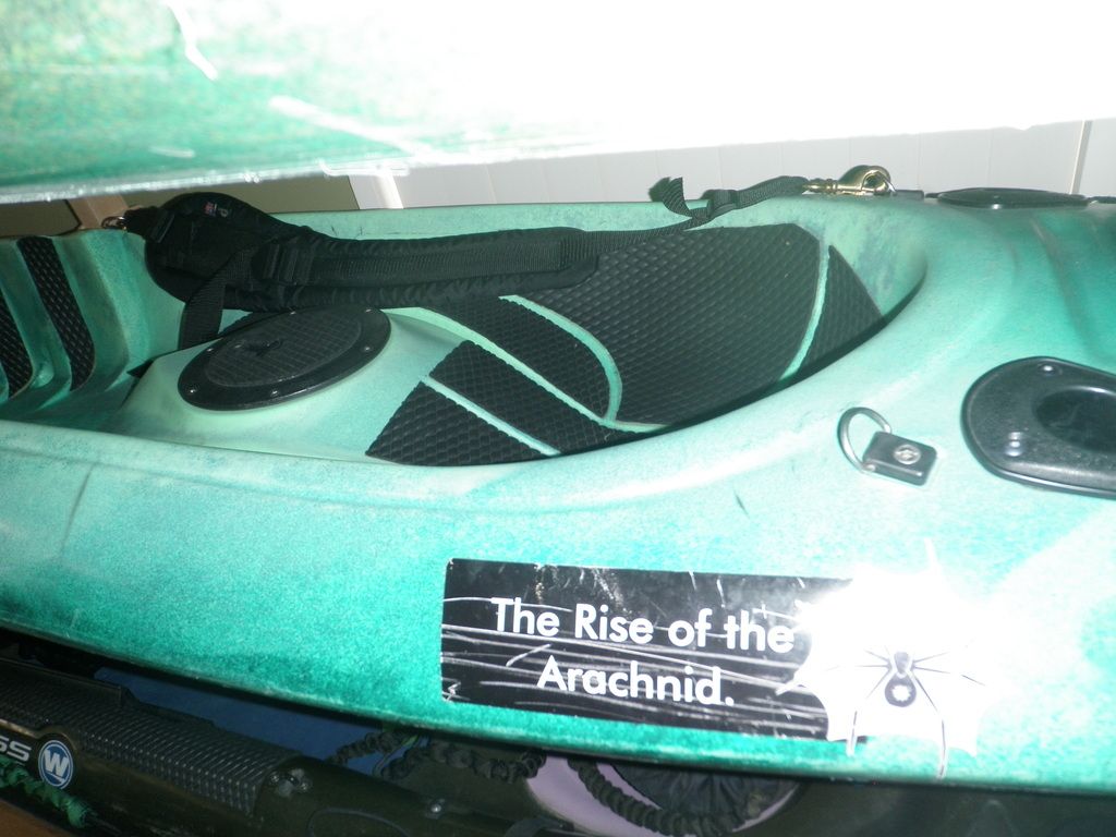

I use leg straps primarily for recreational paddling and rarely when fishing, but I'm strongly considering keeping them attached every time I am on the water.
I find the paddling more enjoyable and I believe that I am much safer strapped in than when Im not.
The chances of boat separation are significantly reduced. Not just because I am strapped to the boat, but the level of my skill set and counter measures are increased. For me, there is no high brace without straps and my low brace is much weaker.
I still enjoy using big blades, and there are times when I come close to pulling myself right out of the boat. The aggressive T stroke, bow rudder, and even a strong sculling draw can threaten when Im not strapped in.
Paddling starts at the core and the straps allow me to engage my core and influence the boat.
Im using straps that are A LOT more comfortable than the ones pictured above.
A larger padded surface area with a wider area for your distal leg and one has a shock cord end that increases comfort. My hip snap is dulled by the shock cord but it is more comfortable for all day trips.
 Fishing might be the time when I need them most. There is a lot of extra gear that rides at a higher COG and a solid brace becomes more important and more difficult.
