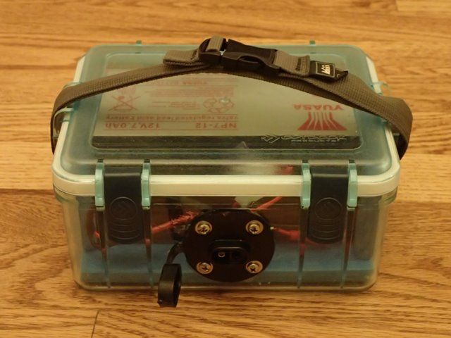

I described an inexpensive, easy to make, and easy-to-use waterproof battery box which protects the battery's connectors and fuse and connects either to a recharger or to my fish finder with a SAE two-pin plug at http://www.northwestkayakanglers.com/index.php?topic=17734.msg191025#msg191025.

I have a 7aH SLA that I bought from Batteries Plus that lasts me two days - maybe more since it only drops from 12.2v to ~11.5v, but I haven't used it longer than two days before recharging it.  I think I paid $13 for it.
To answer your questions:
- 7aH will run the HOOK-4 all day,
- A small SLA from Batteries Plus will work, but you might find one for a lower cost,
- You don't need to solder anything,
- You can use crimp connectors and crimp splices, but seal them with GOOP, and
- A dry bag will work.
I crimped the connectors to the wires that run to the battery terminals, then put heat-shrink tubing over the (crimped) end of the connector.  That seems to work well enough for me, but I've read the posts where people solder the connections or have used Marine GOOP to seal everything against corrosion.
I used heat shrink marine connectors where the wires join - the ones with the adhesive lining.  I covered that with shrink tubing, too, because I over-think everything.  I soldered the wiring the first time I built a battery box and haven't noticed any gains or losses using crimp splices.  You don't need marine heat-shrink connectors.  One of the skippers on the dock gave me a handful, so I used them.
I don't think you need Aqua-Seal.  Marine GOOP seems to work fine, and most of us have a tube of GOOP lying around.
A dry-bag works.  I believe INSAYN used one for years, and may still use it - and INSAYN is a heck of a fabricator if it didn't work.
(I made a battery box surprisingly similar to Pete's example, but my SAE panel-mount plug is different and cost more.  I think my total costs were ~$60, including the battery and the Velcro that holds the box in place inside the hull.)

The Outdoor Products dry box I used for my battery boxes is $9.97 at Walmart.  See https://www.walmart.com/ip/Outdoor-Products-Large-Watertight-Box-Orange/36547548 . You can pick up the SAE two-pin connectors you need to install on the end of the power cord to your fish finder and the fuse units at Batteries Plus or any auto parts store.  So it's a cheap project.
I solder my wire connections and cover them with heat shrink tubing. I squirt goop or aquaseal inside the tubing before I shrink it.  I use the slide or clip on connectors to connect wires to the battery, so I can remove it easily if I need to.  There's no need to cover the battery connections inside the box with Goop.
