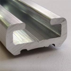

I too have sought a cheaper solution than GearTrac. The GT90 looks suspiciously like sail track.  My choice was -- coincidentally -- sail track made to mount on masts for hoisting and lowering sails. It is designed for high loads and is pre-drilled for rivets or #6 screws.
 $35 for 8 feet. http://www.duckworksbbs.com/hardware/rigging/sailtrackbb/index.htm
How did that workout with the curved back?
The GT90 and GT175 by Yakattack also have curved backs.  see below
This puts the edges in contact with the hull because most surfaces on the kayak are slightly curved. I have yet to install any.  I have been too busy fishing and doing yard work.  I also may use it on my CNC router table for clamping work pieces. It seems more economical than any t-track I have found.    I also will be using it on the mast for my sailing rig I am building for my cedar strip canoe and kayaks. http://www.clcboats.com/shop/boats/wooden-sailboat-kits/clc-sailrig-kayak-canoe-sailing-rig.html
Looks like it should work!
2 things you may want to consider before you pop a bunch of little holes in your kayak.
1: YakAttack drills holes every 1-3/4".  I don't know why they do this, but they do.  Manufacturers typically try to get by with as little cost as they possibly can...  That sail track looks to have a slightly farther spacing.  It's easy enough to add a few more mounting holes if you need to.
2: I like the curved base on the sail track better than the track I used from LeeValley.  The contact points for the sail track appear to be pretty narrow.  The YakAttack contact points are at the widest part of the track.
If you do make some DIY gear tracks with the sail track.  Please post your build so others can see and learn from it.  Feel free to hijack this thread so it keeps it all together.

Being familiar with product design, I doubt there is any black magic in the 1 3/4" spacing.  Probably it is the default spacing from the track mfg that supplies the track.  There ARE good reasons for various spacings based on the rated load of the rail, area of the mating surface and tear-out specs of the material but usually an OEM just asks the application engineer at the track company what spacing they should use and they go with the recommendation.  It's not worth it usually for an OEM to spend the extra dollars on R&D to determine things like track bolt spacing when they can push off those costs to their supplier.
I like the curved bottom of the sail-track better because it gives a space for sealant to live.  Most folks torque down flat bottom parts too much and squeeze out too much sealant.  If you get track from non-marine intended sources it usually won't have this curve.
This might be a good application to use Butyl tape as a sealant.  It starts out thick so it can accommodate a certain amount of hull curvature, it is compressive rather than adhesive so seems like it would get around the "doesn't stick to PE" problem.  I'd recommend roughing up the contact area with a bit of sandpaper to give a better mechanical bite. After the part is bolted down, any excess sealant squeezes out and is easily cleaned up without making a mess on the boat.  I've used it lots of time on other boats and plan on using it on my yak when I get to installing inspection ports and flush deck rod holders.  Has anyone else tried it out on a yak?
