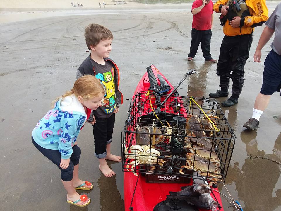

I echo all Craig's comments - only 1 pot in the ocean, and sort on the beach. I use a milk crate, and the trap sits nicely on top, with the buoy and line in the milk crate. I also have a two PVC pipes strapped vertically in my milk crate - one for my fish bonker (toy baseball bat) and one for my flag. The bonker sticks up through the crate and helps hold it on. The flag I have to pull and re-insert it through the trap. This really keeps the trap in place. Here is a picture of a trap sitting on top of my milk crate, minus the flag. You can see the bonker behind the crab in the left foreground. (The kids are my granddaughter and great nephew)
