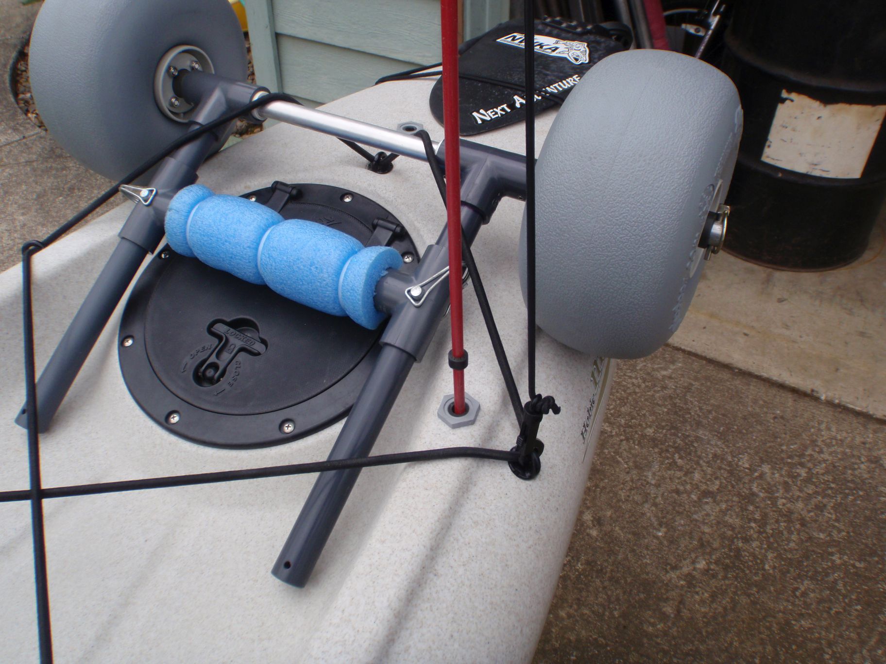

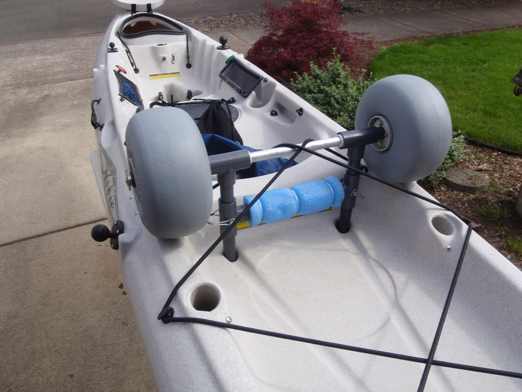

I built mine out of PVC eight years ago when I was told by many that PVC was a bad idea and never going to last. Whatever?  ::)
Anywho, I built mine to come apart into three parts of frame, one axle, and two wheels. All with just four locking pins.
The beauty of this unit is that I can change my axle (have two lengths) and run either size of the Wheeleez.
It can all fit inside the hull, or just plug in behind my seat. Never been a problem with weight distribution and I'm a bit more plump than you Casey.
Do you have a picture of it?
I don't generally make a habit of taking pictures of some of all my odd ball creations.  I build stuff from the hip, if it works awesome!  If not, I try something else.  I must have taken a picture of my cart for some reason or another, but can't remember why.  However, I don't have any pictures of it broken down into the individual bits or with my longer axle running the bigger Wheeleez tires. Just know that with the bigger tires, there is still an inch or more of clearance between the tire and the hull.
The "T"s with the locking pins are hogged out with an air tool, but I suppose a flat blade drill bit would do the same.  This allows for the two main vertical sections to slip through the "T"s and be pinned in place.
The tires shown are Wheeleez (SKU: WZ1-24UB) with the 3/4" ID bushing.
My bigger ones are Wheeleez (SKU: WZ1-30UB) with the 3/4" ID bushing.
The axle is 3/4" solid aluminum.
The cart is made of Sched 80 PVC.  Much thicker and stronger than Sched 40 PVC.
You can probably see the white PVC (Sched 40) where the axle goes through, those were just used for wear shims and to get the ID down to 3/4".
These shims are NOT glued in place. Rather I used a set screw to hold them in place.  If you zoom into the top picture, you should be able to see the 4 set screws used on the top of the lower "T"s (two for each "T").
