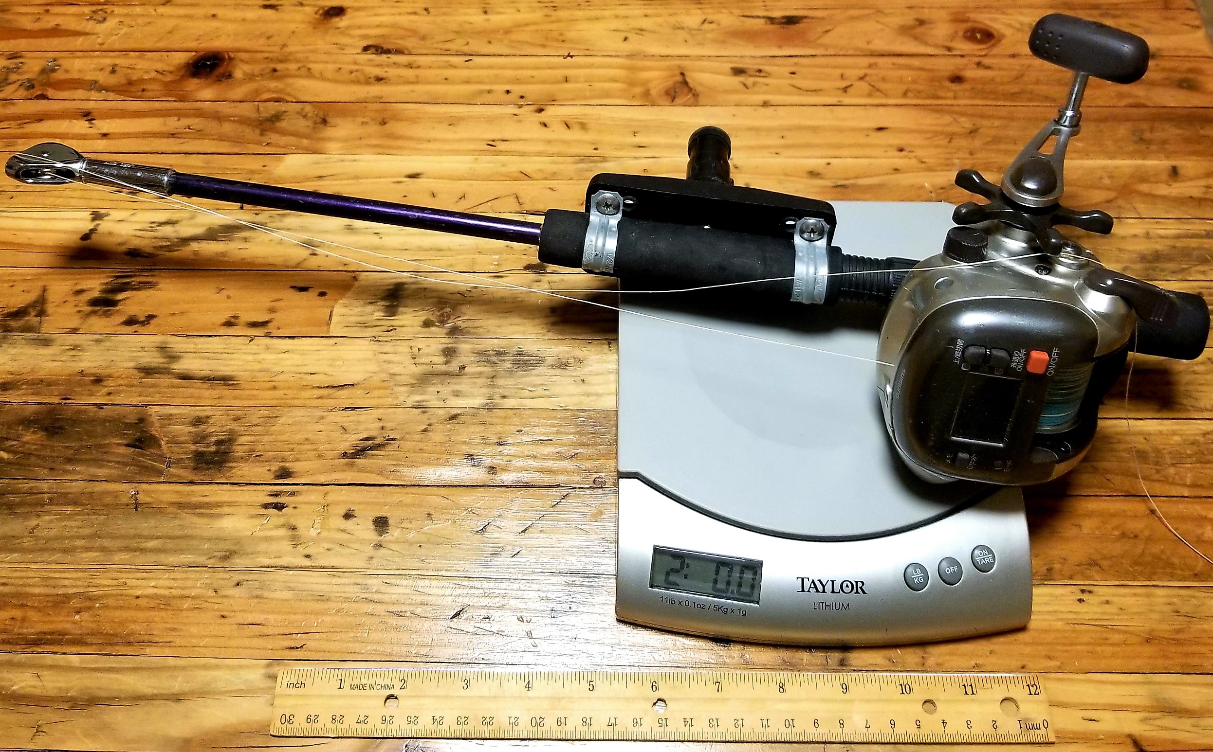

snopro
  • Location: HR
  • Posts: 1169
The purpose I had for doing a power assisted downrigger was for deep trolling -- like 100-200ft deep (at Lake Chelan), and often from 60-100ft deep (at Odell and Green Peter Reservoir) for kokanee and lake trout.  I have since purchased a used Tanacom 750 and will also use it for Halibut fishing 700ft deep (Oregon Offshore).  That's a lot of reeling with 5lb of lead !!  With that amount of lead, I have blowback at those depths, but I'm ok with blowback in lieu of having a much heavier ball.  I still use my "manual downrigger" which is just a conventional line counter reel on the same stiff section of rod shown in the video.  But, I thought I'd post an alternative to the various full scale electric downriggers that a couple of the posts in this thread showed.  I have a Revo11, and the weight and balance of using the Tanacom electric reel in a crate rod holder is far superior over a full size Scotty or Cannon power downrigger rigidly mounted.
Great idea Barb.  I agree with everything you said.
Here is my take on the concept.  Keep in mind I fish >100ft deep 95% of the time.  A four pound ball on 80lb spectra hits the sweet spot for me in terms of blowback.
I tried to minimize the package as far as I could and still fish effectively.  I wanted it to be ultra portable, lightweight, and quick to mount/unmount.
All together my downrigger is 20" long and weighs 2lb.  Total cost was under $175, line included.   For my style of kayak fishing I think it compares favorably to the electric models by scotty and cannon.  At the push of a button this rig will zip 4lbs up 100ft in under 30 seconds and auto stop at the surface with the line clip in reach.  I can get a full day of fishing out of a 5ah 3lb SLA.
Pete was asking about advantages over a manual.  In 2014 I was using a manual downrigger made out of the bottom section of an old salmon rod and a cheap okuma line counter reel.  I lost a few chinook and a nice bull trout because I couldn't retrieve the ball fast enough while playing the fish and they tangled around the downrigger line.  The fishing was great that year and between drive bys and hook ups I was wasting a lot of time pulling the ball back to the surface to reset.  I hit ebay and found the smallest electric I could and scored a gem.  Mounted it up in the configuration you see above and there was no turning back.  The portability and versatility are excellent.  I love my mini rigger! ;D
