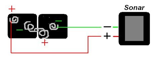

"Emergency Power"
In a pinch two 6V lantern batteries (the ones with the springs on the top) wired in series, will get you going and you can find them almost anywhere. They are especially handy when you forgot to charge the sealed lead acid batt or left it at home. ::) Even the cheapest, non-alkaline, batteries (usually <$8 for two) work really well for a few days. Just hang the center spring of one battery around the outside spring of the second battery and attach the ff leads to the other two springs. While your at the Mart, get a tupperware container to put them in or if your in Zee's condition, baby wipes refill boxes make perfect containers.
« Last Edit: June 12, 2009, 05:35:42 AM by Fishesfromtupperware »
