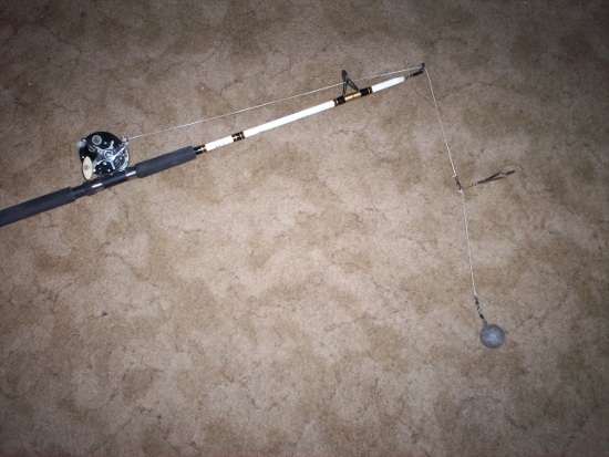

 just about Finished up my homemade DR tonight. Just need to get another scotty pole holder to hold it and epoxy some material to the clip that has the proper friction to hold the line at the desired tension..

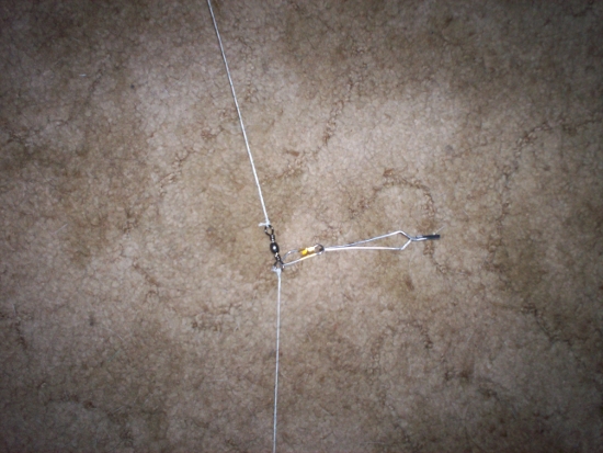

Looks like a winner.. The only thing I would do is buy (not that expensive, if you were closer I would give you one of mine) a real release. You would be surprised the force/grip that is needed to hold the line correctly and release as needed when a fish hits. To loose or to tight and you miss a lot of fish. I have fished downriggers in the ocean for years and next to your choice of bait/lure and depth fished a properly set release is very important. You need it tight enough that the fish sets the hook in its mouth but loose enough to pop loose once the fish is hooked and doesn't pull the hook out of its mouth fighting the release.  You could also epoxy a line counter to the rod to keep track of how much line you have out.. Great home build!

Yea, I will probably end up going with a real release. We did do some testing and with some rubber like a inner tube glued on it , it actually held on pretty good. Trial and error will get it right. Good idea about the line counter

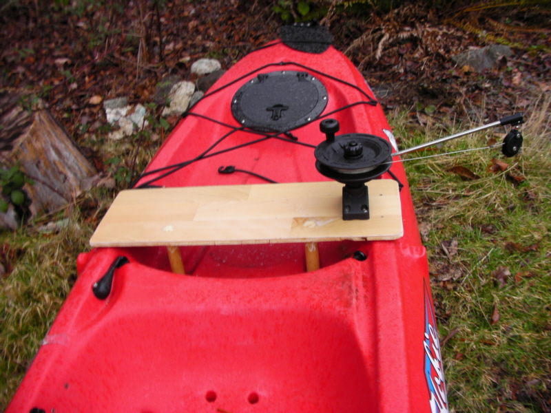

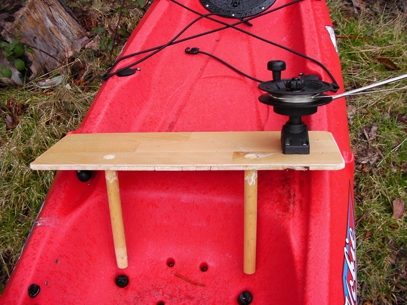

Zee, I took you at your word and made a behind-the-seat rigger mount this AM, as it was too windy to fish QM harbor.  Here's the setup----a piece of click-flooring, drilled for dowels and the Scotty mount fastened with SS bolts.  Slips into the holes where the wheels fit:
and slipped into place, the bungee cord will hold it down nicely

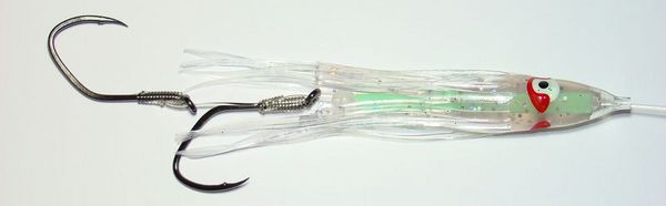

I'm hoping tomorrow will be decent weather for trying this out!  I made up some high-tech hoochies with mini-B2 squid inside, as tied by "Captain Downriggin"---he
knows what he's doing with hoochies!!
Nice job, KT.
Like the sickle hooks. :thumbsup:
