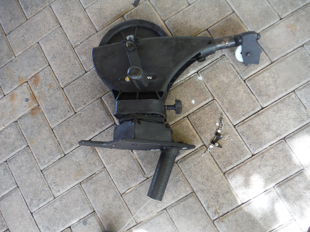

I did mine with a cannon DR.   The boom was cut short for less tipping leverage.
This was originally on my PA, and the only mod to make it fit the outback was cutting the PVC a little shorter so that it would fit in the rod holder of the outback.
