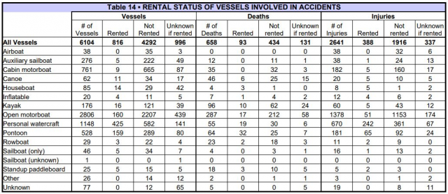

According to US Coast Guard statistics, paddle sports deaths (those that involve Canoes and Kayaks) have been on a steady rise for the past 10 years. To be specific, since 2005, these unfortunate occurrences have increased by a staggering 78%.  This trend doesn't need to continue.
2021 US Coast Guard Data of Accidents on US Waterways
