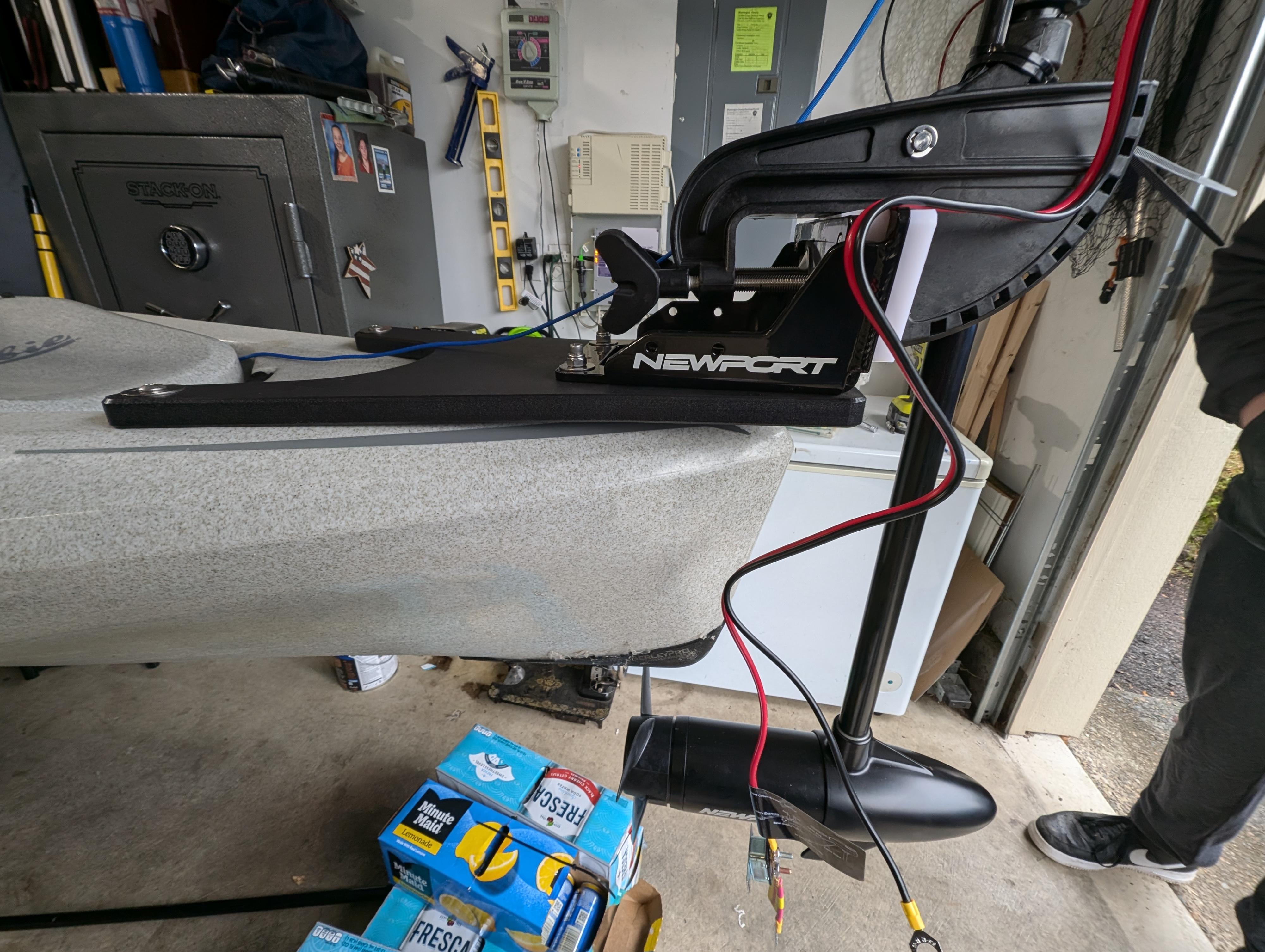

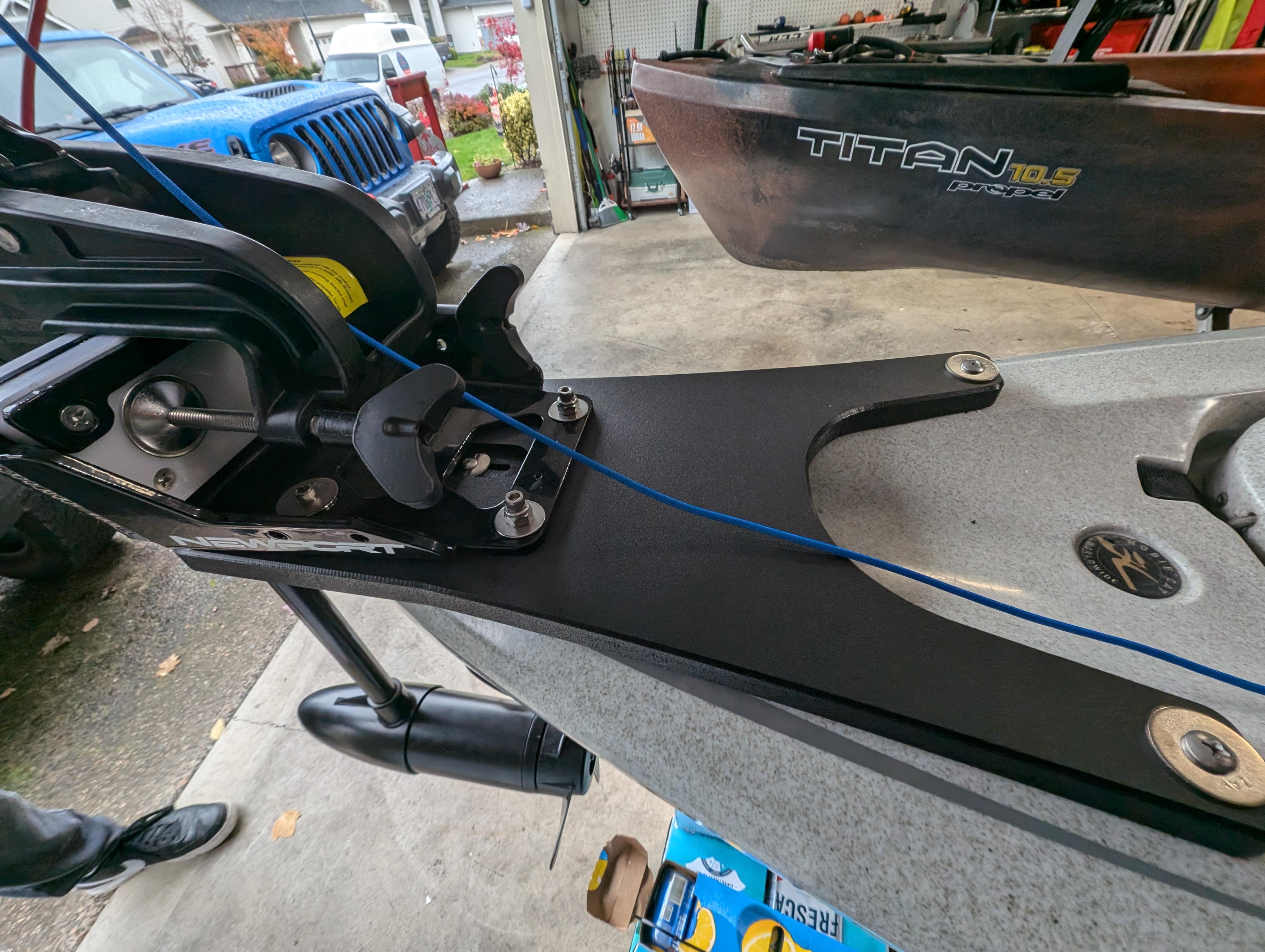

This winter I decided to take the plunge into the motorized side of the kayak fishing pool.  After talking with some others, I decided to go with Autoboat instead of a Motorguide setup.  So I did a pre-purchase for the Autoboat Smart Head and then started getting the other items I would need to be able to mount it.  For the mount I got a One Objective mounting plate and a Newport transom mount.  I also got the Newport NV series trolling motor (55 lb thrust) and they were running a special on their Smart Battery Box so I picked that up too.  I also picked up some 8 gauge marine grade wire and some trolling motor plugs from Amazon.  I also got a through hull from Yak Attack.  With everything purchased, it was time to start the build.  I had to make some modifications to the One Objective mounting plate since the holes for it don't match the standard power pole hole pattern used on the Newport transom mount so I drilled new holes and countersunk them for the stainless steel three prong nuts that come with the One Objective plate.  Once that was done I used thumbscrews to attach the Newport transom plate to the One Objective mounting plate.

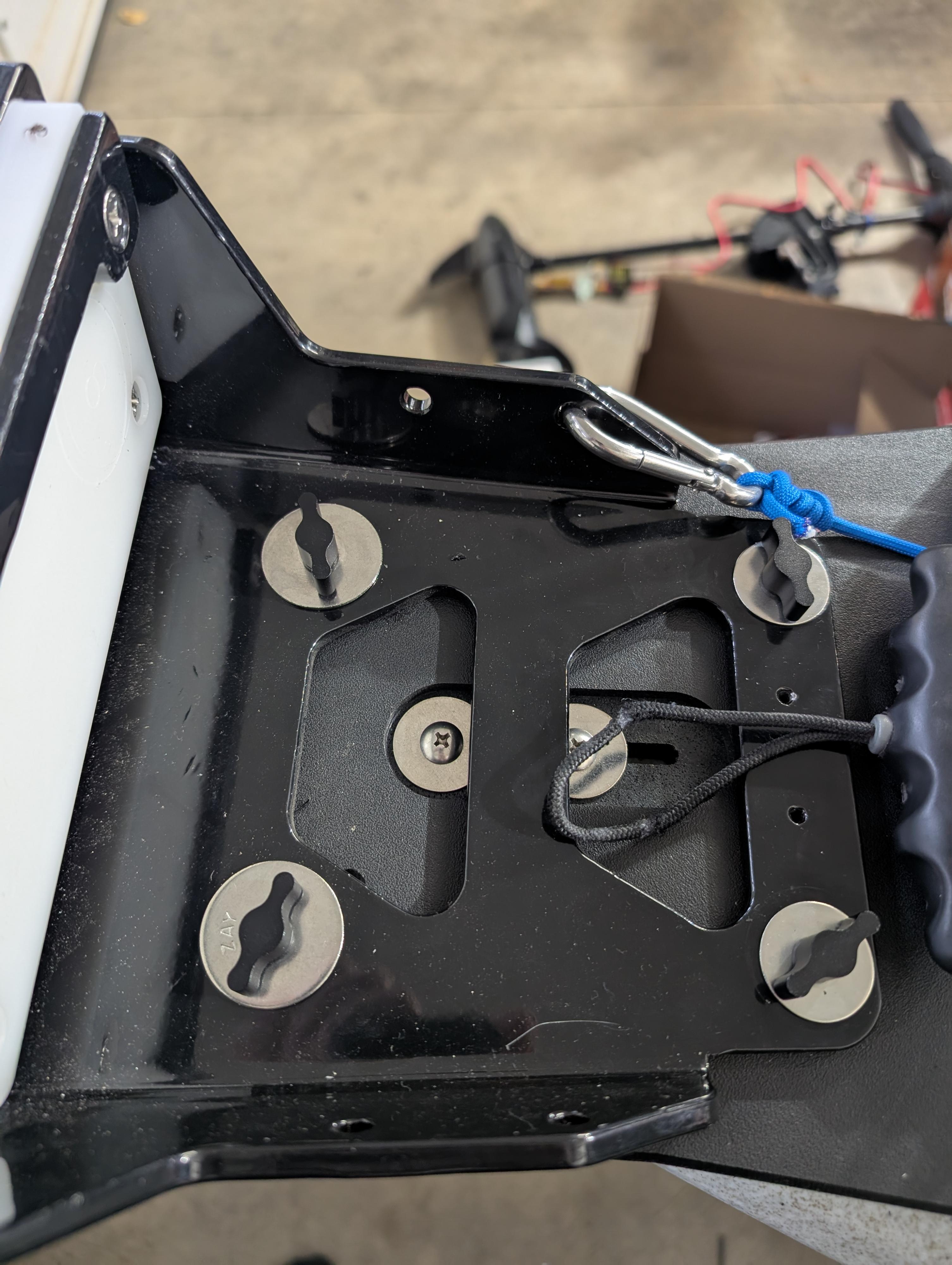

Once I was sure the transom plate was mounted the way I wanted I mounted the One Objective mounting plate to the front of the kayak.  This used the two screw ins for the front padeye for the toggle handle and then two screws that are along the front hatch.  You need to drill two holes for that and there are backing plates and fender washers and nuts that go on those screws.  The One Objective plate has a cut in carrying handle for you to use to pull the kayak since you can no longer use the original handle.  With the mounting plate and transom mount done, next is the motor itself.  The motor mounts easily enough, just two thumb screws that clamp the motor to the transom mount.

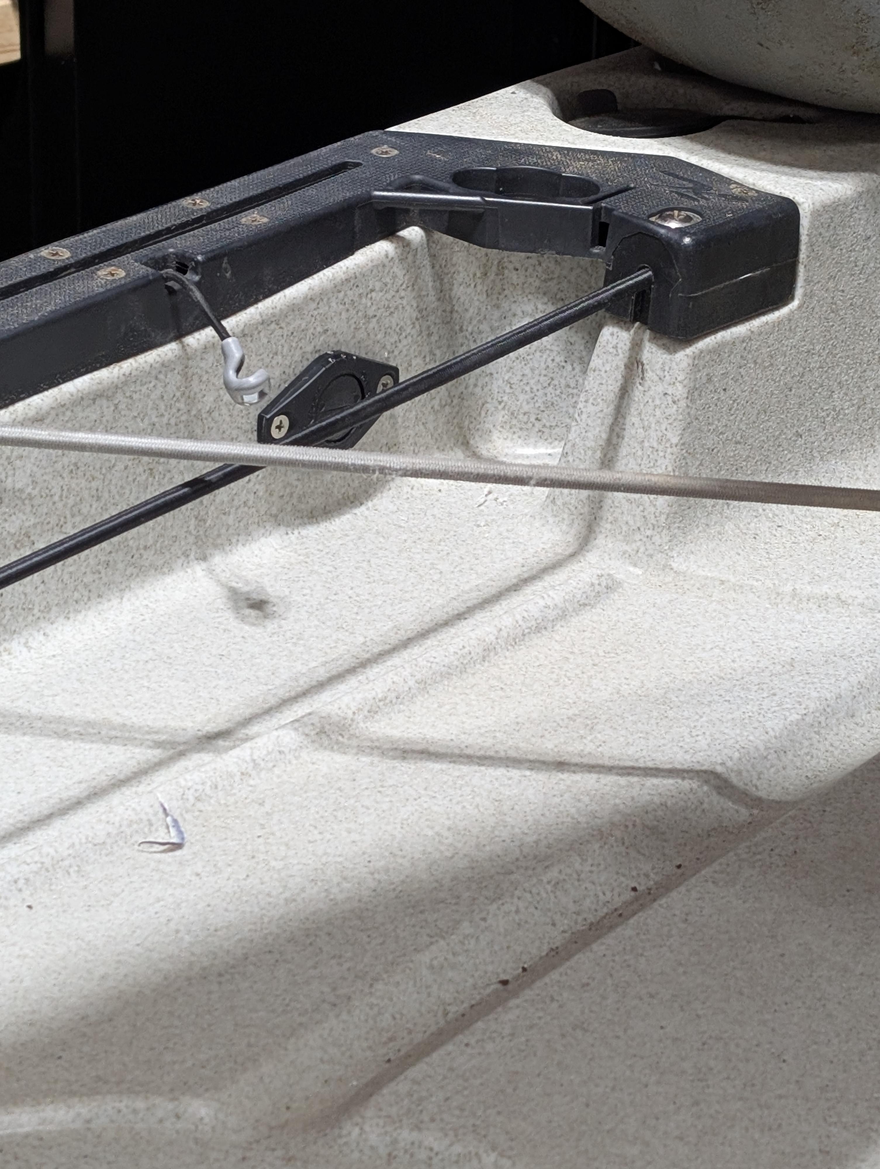

I also rigged up a way to be able to retract the motor but that didn't work out too well out on the water.  We had to wait awhile for the Smarthead to arrive but it finally showed up around the end of January.

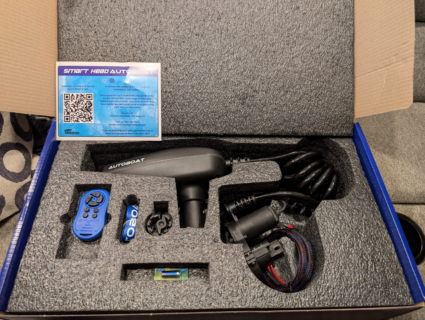

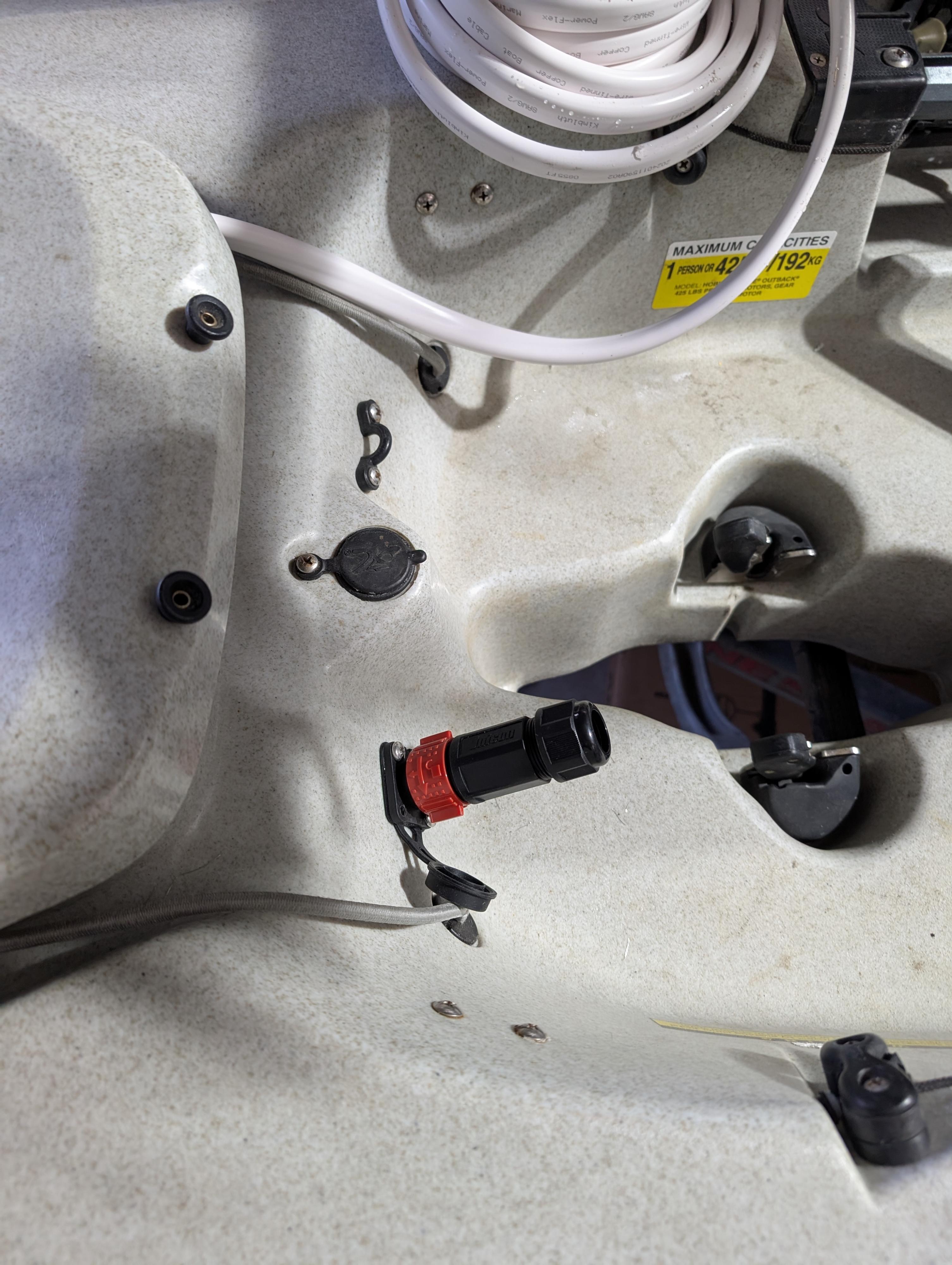

Once the Smart Head arrived I pulled the head off the Newport motor and installed the Smart Head.  It was a pretty easy install.  I also drilled some large holes in the kayak and installed the power plug in the foot well and the Yak Attack Through Hull in the back deck area.
I ran my wire and got it ready to connect up.  I purchased a 50 Ah battery that I can put in the front hatch (I made the power cable detachable there with some Anderson plugs) and a 100 Ah that will go in the battery box and sit behind the seat.

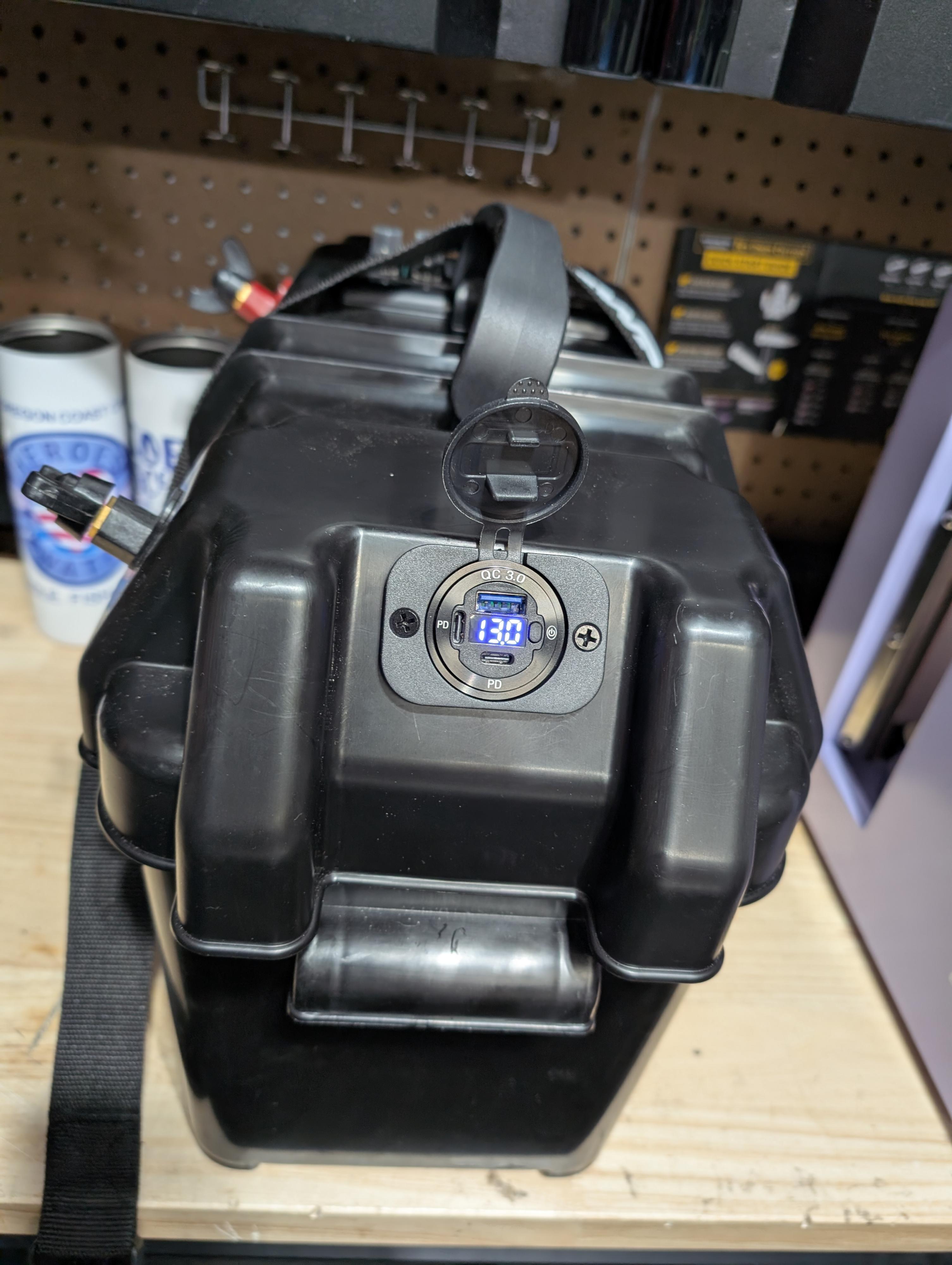

The Newport Smart Battery Box has 2 built in breakers, a 60 Amp for the motor and a 10 Amp for the accessories.  Speaking of the accessories plugins, I removed the 12 V outlet from the Smart Box and found a USB outlet with 2 USB C and a USB A and a voltage meter on Amazon and put that in its place.  I figured I'd use USB ports more than a 12 V outlet.

Mine deploys with a piece that I have to squeeze towards the motor shaft.  So I am trying to figure out a way to squeeze something by pulling a cord.  My original plan didn't work so I am on to plan B.  I'll let you know how it goes.
