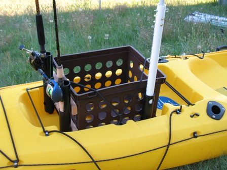

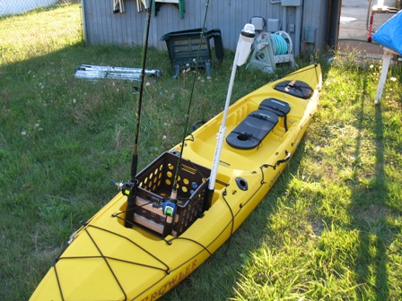

k, here goes. had once mentioned in the kayak crate thread that i'd post these.. this works too.
this is ghetto style. all scrap materials and hardware on hand except for the crate and the light. i think i have like an hour and $16 into this, the most expensive part being the $12 wally world special stern light.

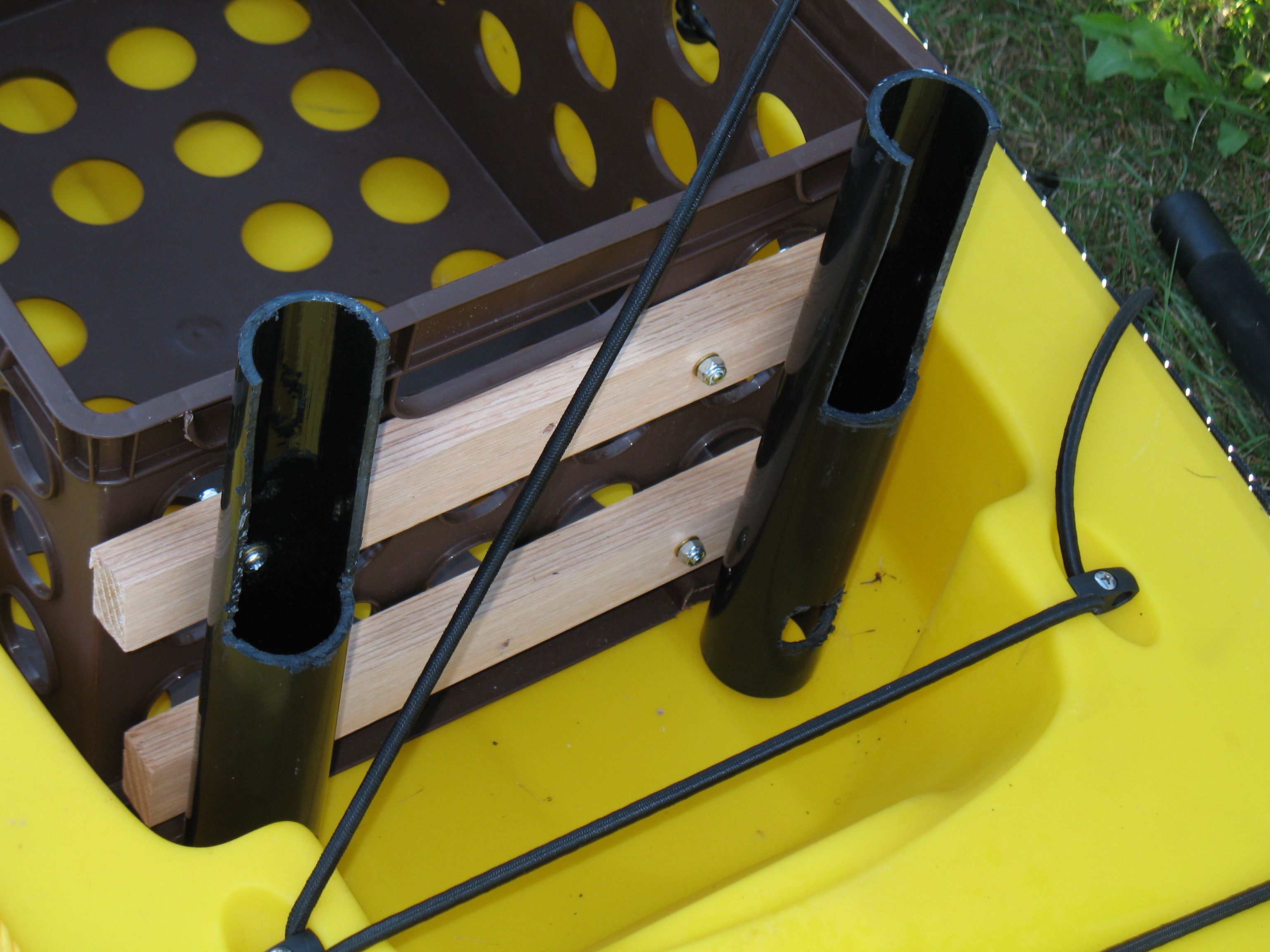

k, sorry for the close up, but you can see that it's just screw and bolt thru the crate to get the tubing attached. trim away any excess plastic from the edges of the crate with a small saw or other means if you have clearance problems. you can sand edges of cuts too if you want to make things really smooth.
look close and you'll see that the stem of the light is cross bolted into the pvc tubing, with one eye bolt at 90 degree to the other two.. this is so you can attach a sliding cinch tether to it then attach the other end to the yak some place rigid. trust me, you wont lose this gizmo if you huli. not only is the tether nice and tight, giving you support, but the tank well bungee across the crate top is super snug, plus the length of pvc inside pvc is long enough to act as a pressure wedge [ does don't ask me how i know apply here??].. it's kind of like the staps on your seat locking it in place from two different directions..
a nice thing is that this set up dismounts easily and slides into the rod pod for out of the way storage.
that's it. simple cheap and you meet the white light requirements for small craft.
last note; there is another version of this out there in cyber space that is much cooler. it uses a scotty gimbal mount that goes into your behind the seat flush mounts, and has two sections of pvc joined like Yarjammers to get it way up in the air.
have fun. be inventive.
