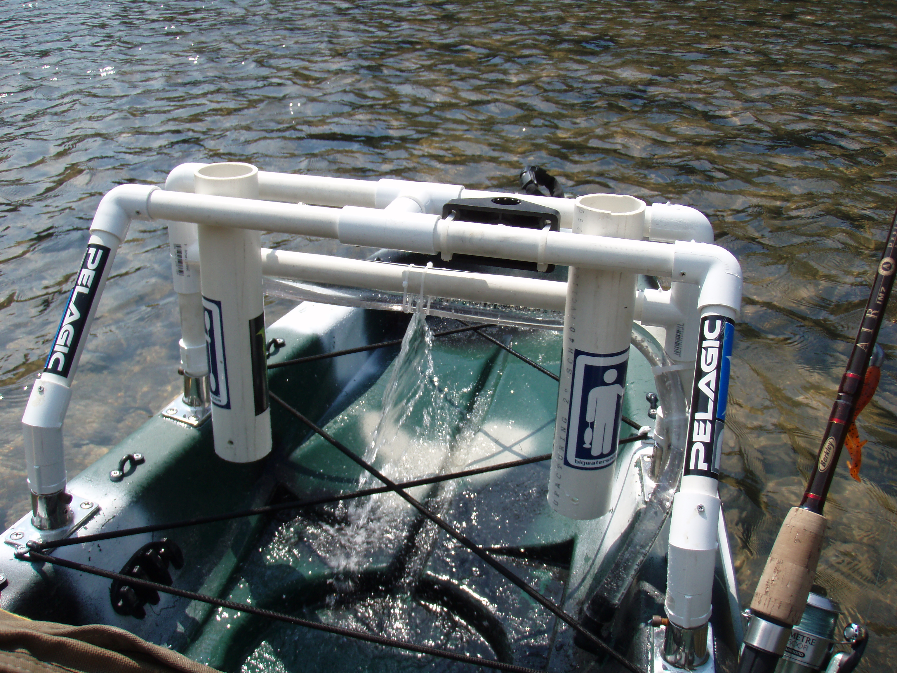

I attached a small PVC coupling fitting with an end cap and used stainless steel clamps to attach it to my existing home-made rod holder rack. Drilled a hole in the bottom of the end cap large enough for the bolt on the pole to fit through. I wrapped the bottom few inches of the pole in electrical tape and foam insulation strips to the point where it fits snug into the PVC fittings.
I simply slide the pole into the fittings and twist on the nut on the bolt sticking out the bottom.

might have missed the original posting, but whats the purpose of all the piping??
The extra tubing is a rack that I made out of a bunch of PVC fittings, PVC pipe and some stainless deck rail mounting fittings. It serves a couple of purposes. It has an extra two rod holders, a scotty mount is on it for my light or fly rod holder and I made a fish sprayer which is mounted on to it as well to spray down my catch if it's in my rear tank well(doesn't get much use  ::)). Since I already had this rack made, I figured it'd probably be the best place to mount a safety flag. I have a better pic of the rack with the sprayer running in my pic gallery. Yeah, I know, I have way too much time on my hands! ;D

This pic.  Nice.
Jeez, just put a short bucket under it, and it's a live well, too! :o
Heck yeah, I love talking about that stuff. I actually can't take full credit for the idea, it was one of the guys I worked with at OEX down in San Diego that gave me the idea, except his was ALL metal, ran off a separate pump, a separate battery... So I simplified to better fit what I wanted, but yeah, got bored one day and spent way too many hours in Home Depot and that's what I came up with. I guess I could start typing something up and I'll shoot it your way for sure at the very least. I guess it's probably a good idea for me anyway to write down ideas instead of having them floating around in my head.
