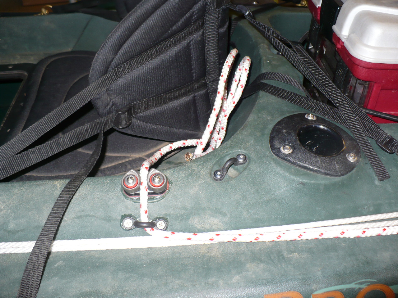

I don't know how others do this, but here's my method...
1) Run the tie-off line through the trolley ring and cam FIRST
2) Lower anchor
3) Run out enough anchor line
4) Clip tie-off line onto anchor line though anchor line spool hole
5) Toss spool overboard
6) Move trolley line forward or aft to desired position
7) Adjust tie-off lie to desired length, as needed
8) Sit back and enjoy a nap!
Jay

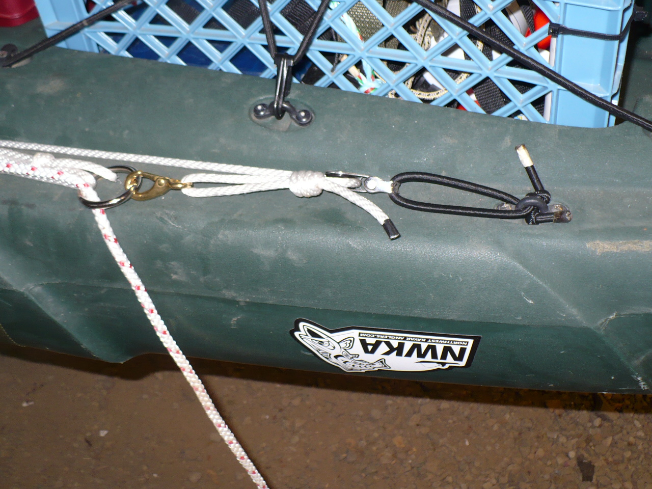

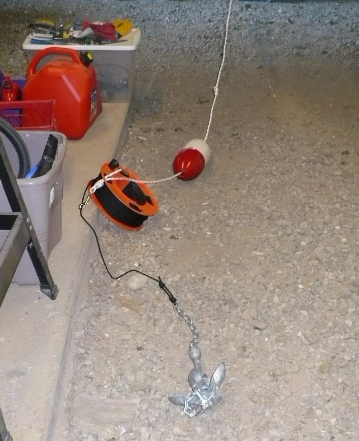

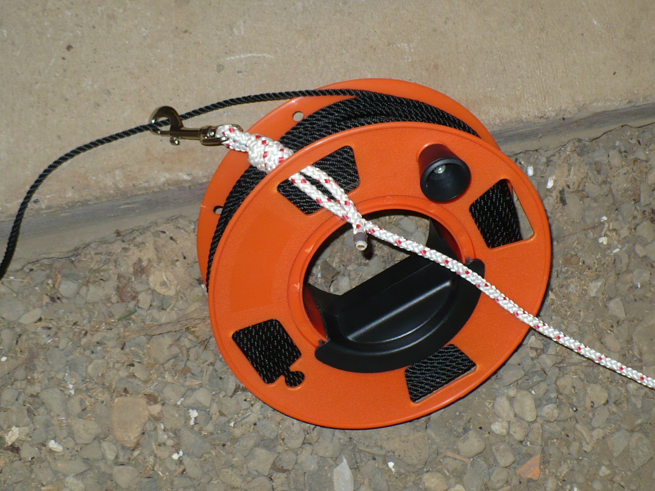

As you can see in this photo, the buoy is attached to a ring that the bow rope is threaded through. The other end of the bow rope is secured by a cam cleat so it can be released quickly. Below the buoy, in the water, is the anchor line reel. It's attached by a large, brass clip. I should also note that its best to anchor from the bow. There can be large debris such as trees and logs floating on the river. You want to keep an eye on the water at all times.

Yep! what they said.  I don't like to leave the reel in the water as I think it makes too much drag, but I probably anchor in too much current. :o
I also tend to favor a weaker anchor rope over a stronger one just in case a sunken log does clip your line.

I'm not sure about the relative strengths of my anchor vs tie-up lines, but, thanks to kykfshr, I've added the Promotion Anchor Release just above the floats. The idea is that this will separate under pressure of a large tree-type object carreening down the river and hitting my anchor line. I'll be released from my anchor and can paddle back up to retrieve once the object has passed downstream.
