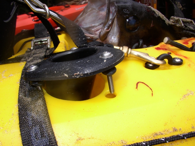

:-\  Wellnuts  :-\
After looking at this picture again, I think I may pull my rod holders and goop a wide washer behind each hole to bridge the gap drilled for the well nuts.  Then goop down the holder really good, and install the big rivets through the washers.   I'm thinking they should hold better than the well nuts.

:-\  Wellnuts  :-\
This seems like an excellent idea, as I'm going to use rivets for my rear flushmount rod tubes. I'll 4200 some wide washers behind each hole while I have the access through the open rod tube hole.
