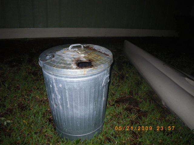

interested but never seen one...have any pics?
You mean like this one? ;D
This one looks pretty bad because its been sitting essentially underwater for the past week. But it ain't whats outside, it's what comes from inside. (We've been getting almost solid torrential rains for the last week)
I thought I invented this when I was in school, but then I saw Alton Brown make one that's pretty close on TV. It kept a steady stream of friends and fraternity brothers at my door for 5 years  :-\
I put this one together a few months ago out of nostalgia and it works better than the original. The heat is controlled by the vent near the bottom and on the lid. Really fine control too.
I'll post more details later, but I just could not resist walking out the door and taking a picture ;D

That's pretty much it, but I use a smaller tabletop grill. I found the Kingsford Tailgating kit at Home Despot on sale for less than $20 bucks. I also only use one vent near the bottom and one in the lid for better heat control. Other than that, that's it on the button.

I would be interested in some more pictures.  LIke what the vent on the bottom looks like, what are you using for the chip "container" and just some overall information.   Do you ever smoke stuff when it's cold outside?   Just wondering how the tin metal of the trash can will "loose" heat....
Thanks in advance for the information.
pete
