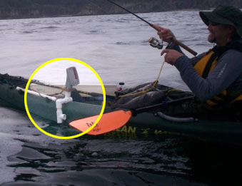

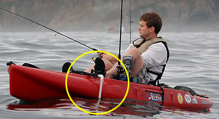

Obviously, you're experiencing erratic depth problems because your transducer is inside your hull instead of where it's supposed to be.... IN THE WATER!  >:D  ;D
BTW, aren't erratic depth problems a relatively minor issue when compared to your erratic behaviour problems?  :o  :laughing7:
Here are two simple "in the water" transducer installations.
