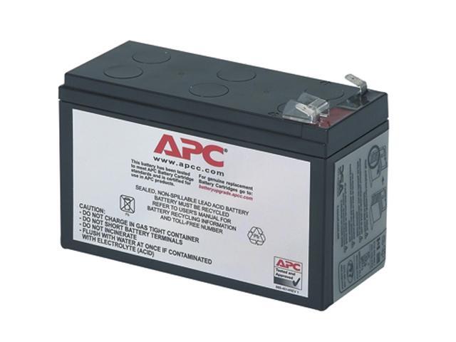

I was going to go for a similar setup as your describing, ended up just buying this 7 amp hour surveillance video battery (looks similar to a motorcycle battery), I got it for $10 bucks down the road at this battery shop. Has been working out excellent for me so far, I just throw it in a dry bag and call it good, I've gotten 15+ hours of use so far between charges with no problems.  It's not this exact one, but same demensions/weight
1.9" x 4" x 5.5" @ 5 lbs
Ah the old AA's vs Gel Cell debate.
Basically, the AA system is lighter and you can easily replace the batteries with disposable ones from a convience store if you forget to charge them the night before.
Gel cells are a bit heavier but can last a bit longer and have less wiring and soldering that can go wrong.
I've gotten 2 SLA from friends who had them laying around and both are toast, so I'm looking for a Seattle/Bellevue/Everett area walk in source for such a battery (Sealed Lead Acid).  Was the battery shop a local shop or a national/regional chain?
A little south of you, but Fry's will have them.
Ya the first one I had my dad gave me, worked great the first time, but at the end of the day it started dying.  I'd turn it back on and get another 5 minutes out of it, then the display would start to flicker and I'd just cycle through the different screen brightness settings and getting a little more out of it.  Kept doing that for 30 minutes or so.  Apparently you aren't to completely drain those batteries... Complete drain =
I'm down just south of Portland, all I can remember of the shop is that it just said "batteries" on then outside it's on SE McLoughlin Blvd.  The batteries normally go for around 20-30 I believe, but these were on the shelf too long or something random, working A-ok so far.  I think maybe I'll stop by and see if they have any left, maybe grab myself another and I can snag one for anyone that wants if they still have them.  If you can hold out until the rockfish/ling cod classic or whatever.
« Last Edit: July 09, 2009, 08:18:36 AM by please_send_rescue »
Ya the first one I had my dad gave me, worked great the first time, but at the end of the day it started dying ... Apparently you aren't to completely drain those batteries...
I had the same experience.  First charge seemed good.  Held voltage okay over the short term but showed a 40%/month decay rate.  After the first full charge it would not take a full charge back to 12V.
I'm down just south of Portland, ...  I think maybe I'll stop by and see if they have any left, maybe grab myself another and I can snag one for anyone that wants if they still have them.  If you can hold out until the rockfish/ling cod classic or whatever.
Thanks, but don't pick one up for me.  I need it fully charged and ready to go next week for a few day fishing trip.
Thanks.  Over a given week I range regularly from Snohomish to Renton to Seattle to Lynnwood.  I'll be doing S 405 tomorrow, so can swing by Fry's.  For a high-tech store they seem to have a lot of problems with their website - it is always -r-e-a-l-l-y- -s-l-o-w- .

When in Rome Portland...You have to use the right words..Deer feeder battery or alarm system backup battery.
PSR:
I found brand new 7 amp hr SLA's at Fisherman's Marine for $25 (BTW: 7 ah = 7000 mah= a few days of run time).
A "good" source of used sla's are facilities/maintenance offices (think hospital or university physical plant). They often are required to cycle out batteries from alarm systems, etc. according to a maintenance schedule and sometimes have serviceable batteries that have to be disposed of.
Again, for me the cheapest, easiest, non-rechargeable route (read: "you can get this one at the 24 hour Fred Meyer along with your license at 4 am on your way to Picnic Point") is two 6 volt non-alkaline lantern batteries. No soldering, just hang the negative spring of one to the positive spring on second battery and connect the FF to their respective remaining terminals and for <$5 you can have a good 2-3 days of fish TV. If you pop for the alkaline, you should get at least 4 days out of them. Not terribly eco-friendly though.
