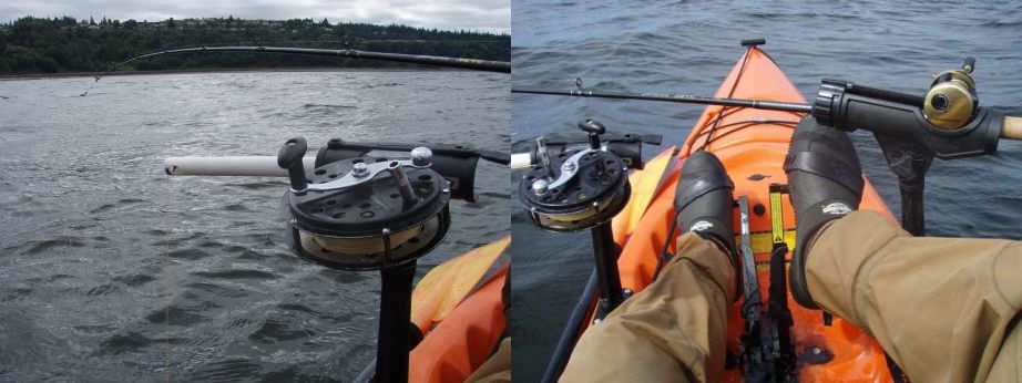

If I had an old Shimano center pin mooching reel, I would try that.
Sorta like this one? ;D
These pics are from the first time I went fishing with Zee. It worked really well and I posted a pic of it a while back but it seems to have disappeared into the ether. That mooching reel picked up the 4lb ball with very little grief and came up 1' per turn. The rod is a pvc pipe with a guide ring epoxied into the end with a reel foot on the other. I plan to shorten the arm a bit to make it a bit more manageable and closer to the centerline.  Mounting it on the extension was not a particularly good idea (thus the pulled rivets). But it is good to to floss your teeth with. ;D

FWIW, the out of the box thinking wasn't to replace a proven workhorse that Scotty has developed.  I was just thinking of what materials a guy would need to use, to make a working setup that was a tad bit more compact, and easier to mount.
Looks like other Yankee engineers are already all over it.    ;D
