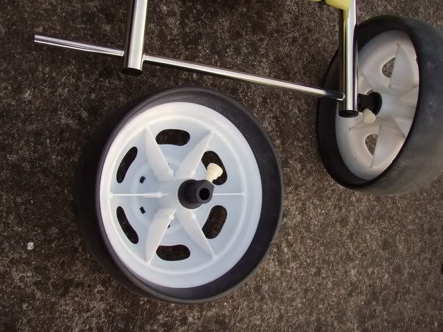

I've been meaning to look into upgrading the kayak cart that came with my Hobie Outback.  I've used it a number of times, and each time I load the kayak up and start wheeling it down the hill I have had visions of the flimsy plastic wheels, with the foam "tire", cracking and sending all my gear rolling down into the drink.

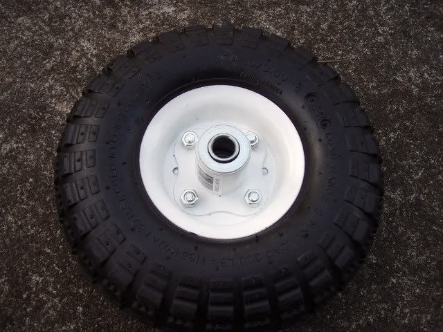

So given this discussion, today I was inspired to stop by Harbor Freight on the way home and see what I could do on the cheap.  The bad news -- they had a 10" wheel with a wide, solid rubber tire and plastic rim that would be PERFECT.  Light weight, rugged, rated for up to $150 pounds... and they only had one left.  Oh well.  Now the good news... they currently have 10" pneumatic tires (with metal rims) on sale for $5 bucks each.  So I bought two.

The "stock" Hobie wheels
The new wheels
Unfortunately, the hubs are pretty hard to get off the stock Hobie wheels, so I was not able to re-use them in my thrifty project.  May be just as well, as they are flimsy plastic as well.

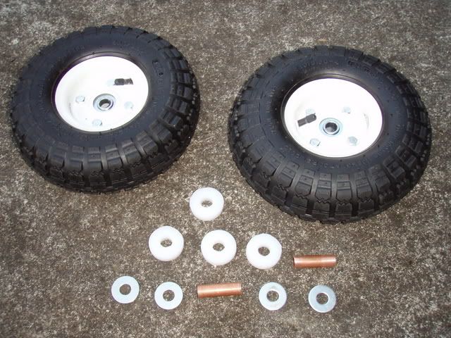

So I set about scrounging in my garage for alternatives... I used some 1/4" copper pipe to make "bushings" that adapt the new wheels to fit the axle of the Hobie frame.  Then I cut 4 1" circular spacers out of a cutting board I had left over from my fish-finder install.  Found some left-over washers from a previous project, and I was in business.
The kit

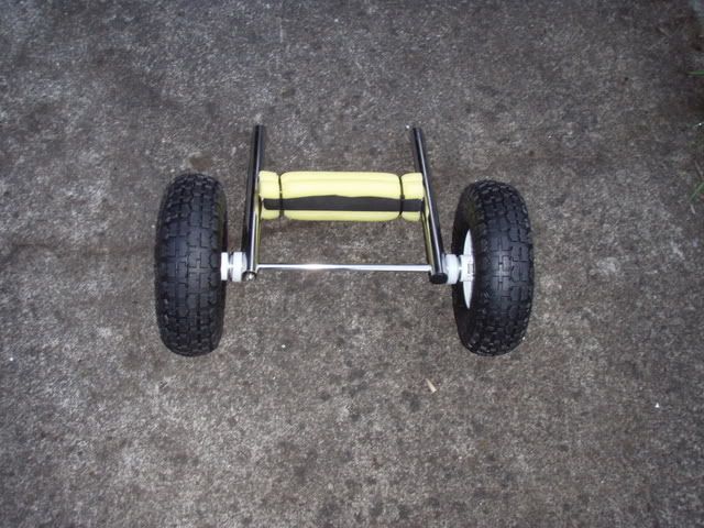

The finished project
For now I'm just using bent nails to pin the whole set up to the axle... in time I'll invest in some cotter pins or something similar.
Grand total for the project - about $11.00.
