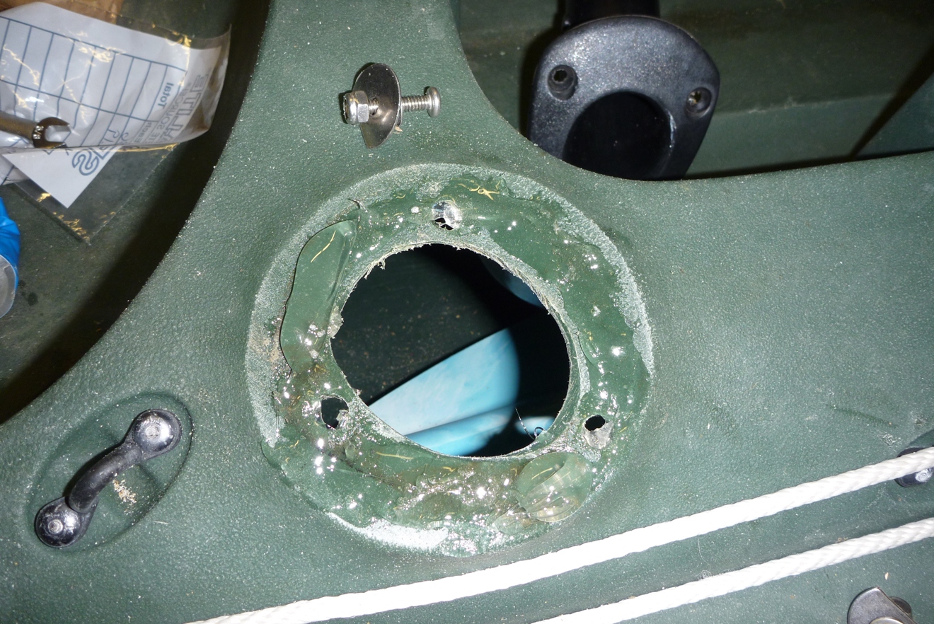

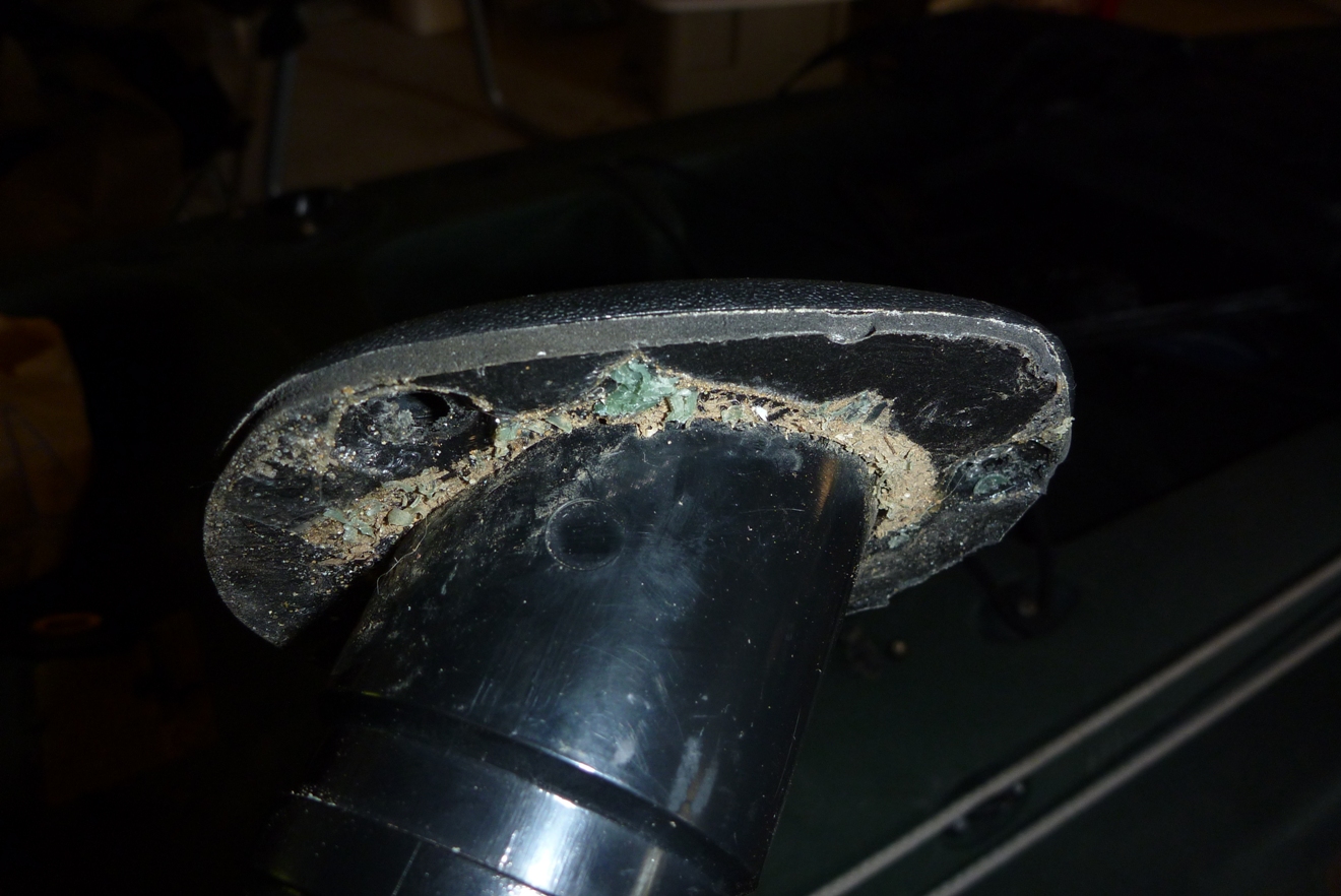

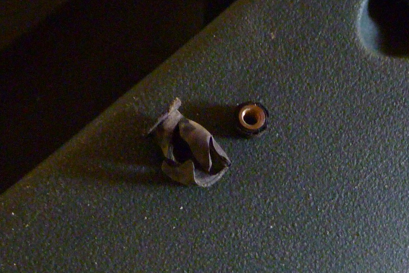

One week before the 2010 ORC and I find a hole behind my seat, one screw for the flush mount rod holder pulled through. All the other screws for both mounts just spin.  :o What a surprise!!! After extracting the first one, I looked at the design and decided it was great for a fast install but not designed to take any upward force. Hmmm, I really shouldn't have huli'd on the way in last time at PC.   ;)  The screw runs through a rubber socket with a small, treaded insert in the bottom. As the screw is tightened, the socket compresses, forming a water-resistant seal. It seems it would be easy to overtighten the screw and cause the insert to tear the rubber socket. This would allow the screw to turn freely with no way to tighten, loosen or remove.  >:(
water-resistant gasket
Since Alkasazi (Brian) was kind enough to install the big hatch just forward of the seat, I was able to barely reach the inserts and stabilize them with my fingers while the power drill removed the screws. What a crappy design for anything besides installation ease. I have plenty of SS hardware and Goop. I'm off to the hardware store for some rubber gasket material. I'm not going to mess with the other mount until after ORC but it will definitely be replaced.

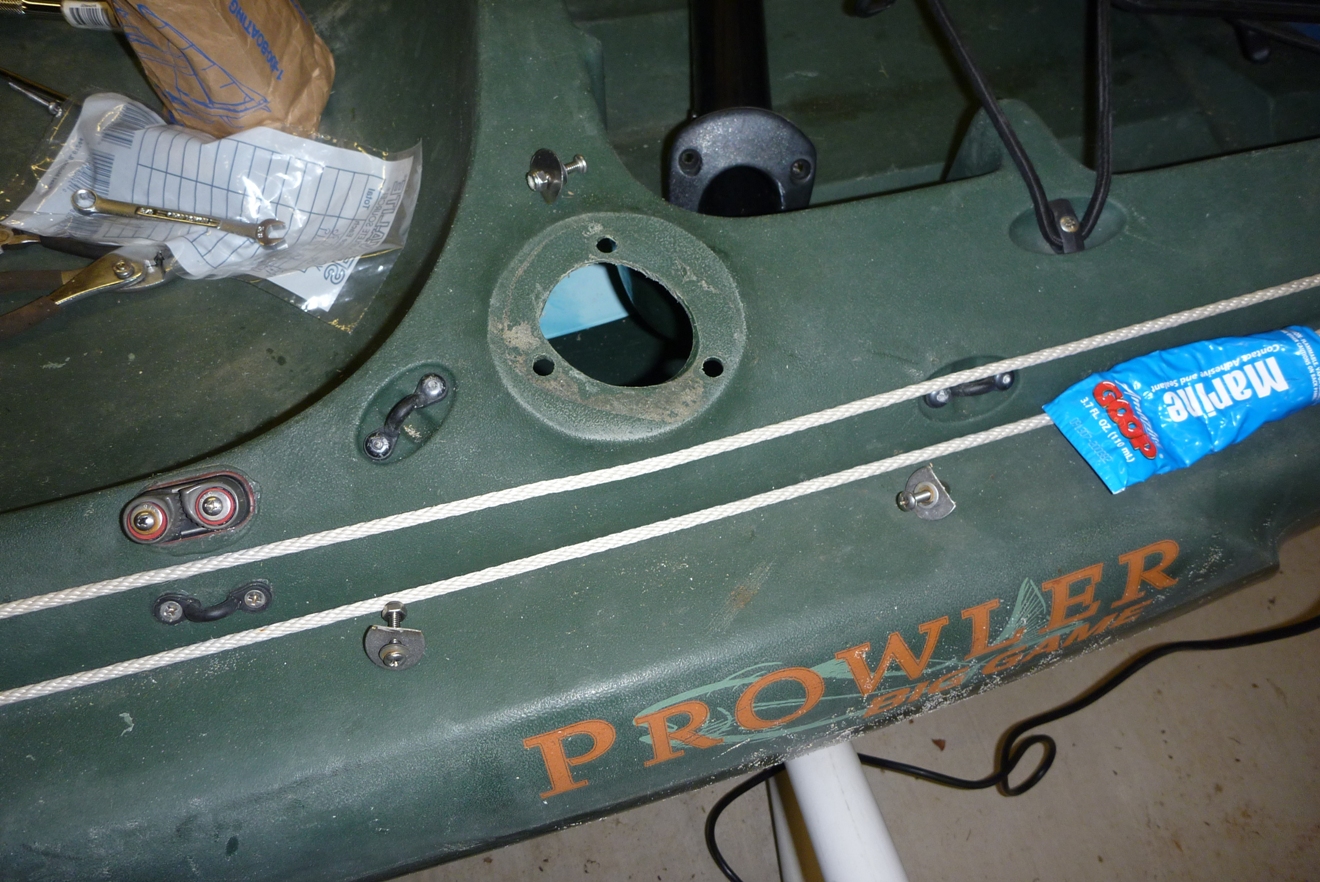

Site sanded and prepped
I had to custom cut/sand each fender washer as the screw holes were very large to fit the original compression screws. The fender edges need to fit the contour of the mounting block and not impede the rod holder. Since they had a rubber gasket under them, I reused the washers on top of the rod mount. I replaced the compression screws with a nylock nut.
All gooped up and ready to roll. I was able to reach the most forward screw fairly easily. The rear and inboard ones were another story. The fender washers had to be oriented just right, the nylock nut had to be started and then I could take my arm back out, grab a box end wrench for the nut and get the drill on the screw head. If my arms were 2 inches shorter I could not have done it.

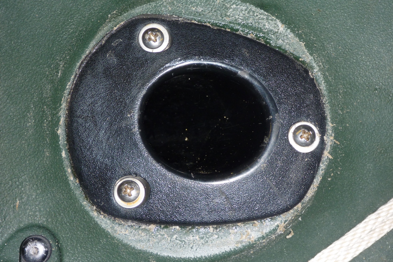

All done with most of the excess Goop wiped away.
I'm not looking forward to doing this again.  >:(
