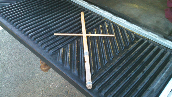

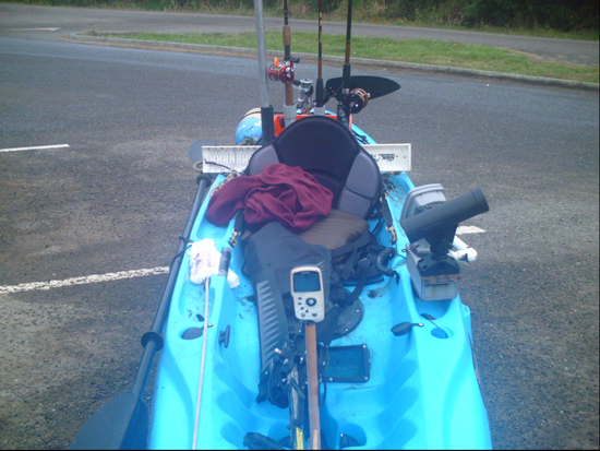

This is my temporary camera mount. Ideally it would be a about a foot farther forward. This mount slips into the mast hole on the hobie outback. Can't recall at the moment if other models have the small mast hole, but they should.

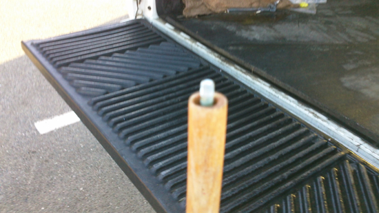

I drilled a hole in the end of the dowel and epoxied a bolt in to screw the cam on to. after the camera was on the large dowel i marked  the hole for the skinny dowel so it would be lined up straight with aim of the camera. I can reach up and turn the camera 360 degrees real easy .
The Kodak playsport camera has a remote control, after i get that i can move it farther forward. It would cool to have the whole pole in the screen
The last pic is sad sorry, haven't taken pics with the gopro camera for a while, forgot how to aim it..
