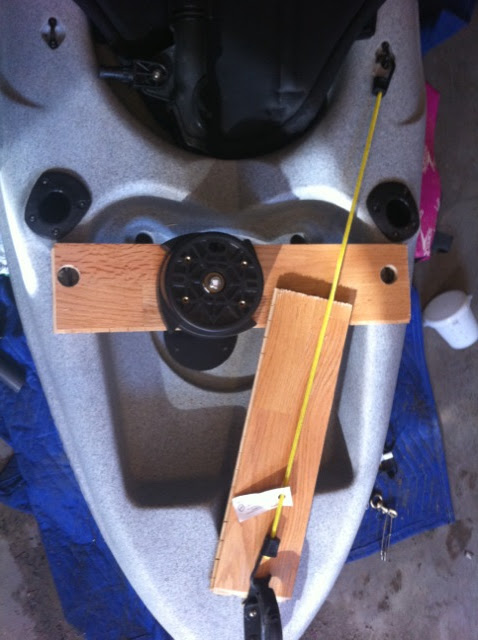

Okay.  I am out of time and I need to commit to a plan of action. I appreciate all of the tips.  As it turns out, I am going to combine four or five of the suggestions made here so I really appreciate the help.
It's going to be a temporary platform as suggested by ZEE to make sure I have it right before I start drilling or making more investments.
It's going to be on a board as suggested by zee and pelagic paddler.
The setup in terms of shape and attachment inspired by Spot's cobra anchor build.
I think the final build will be based on the Cobra anchor build.  Just debating to spend the extra few bucks or a bottle of good scotch to someone to machine me something out of aluminum or another more appropriate material.  If I can figure out a decent retrieval system, I would like to incorporate polepole and pelagic paddlers pull from the end concept.

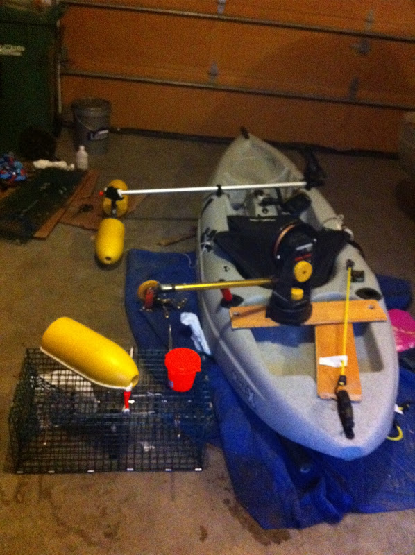

Need to go install the mount.  But a rough idea is:
Now where the heck am I going to put that outboard???
Well I still have to get the attachments for the boards and some screws to connect the T.  maybe I might block up under the downrigger.  But this is going to be what I head out with this weekend...I hope.  I think this is going to work! For version 1.0, it has at least a chance of success!
Thanks again for all the help. Pic below...
DAMN YOU KARDINAL_84!!!!
I've got enough going on without you making me want to build a crab pot puller and retractable yak stabilizer. @#$%^&*()
$#%*^&*(%^&^()*&_$%$#^#^*
I've got work to do!!!
Why don't you integrate the downrigger arm into your stabilizer?  Seems to me it would take the stress off your mounts and be less cluttered.
Now, just stop!!!!!
Beat me to it spot.  I was just typing up the same question, but you already posted this while I was doing it.
Or mount the downrigger on your stabilizer arm with a rail mount kit.
I'd also move the downrigger such that the end barely reaches over the end of the kayak.  Minimize the lever point.
BTW, why do you need a swivel mount on it?  I'm not seeing it.
